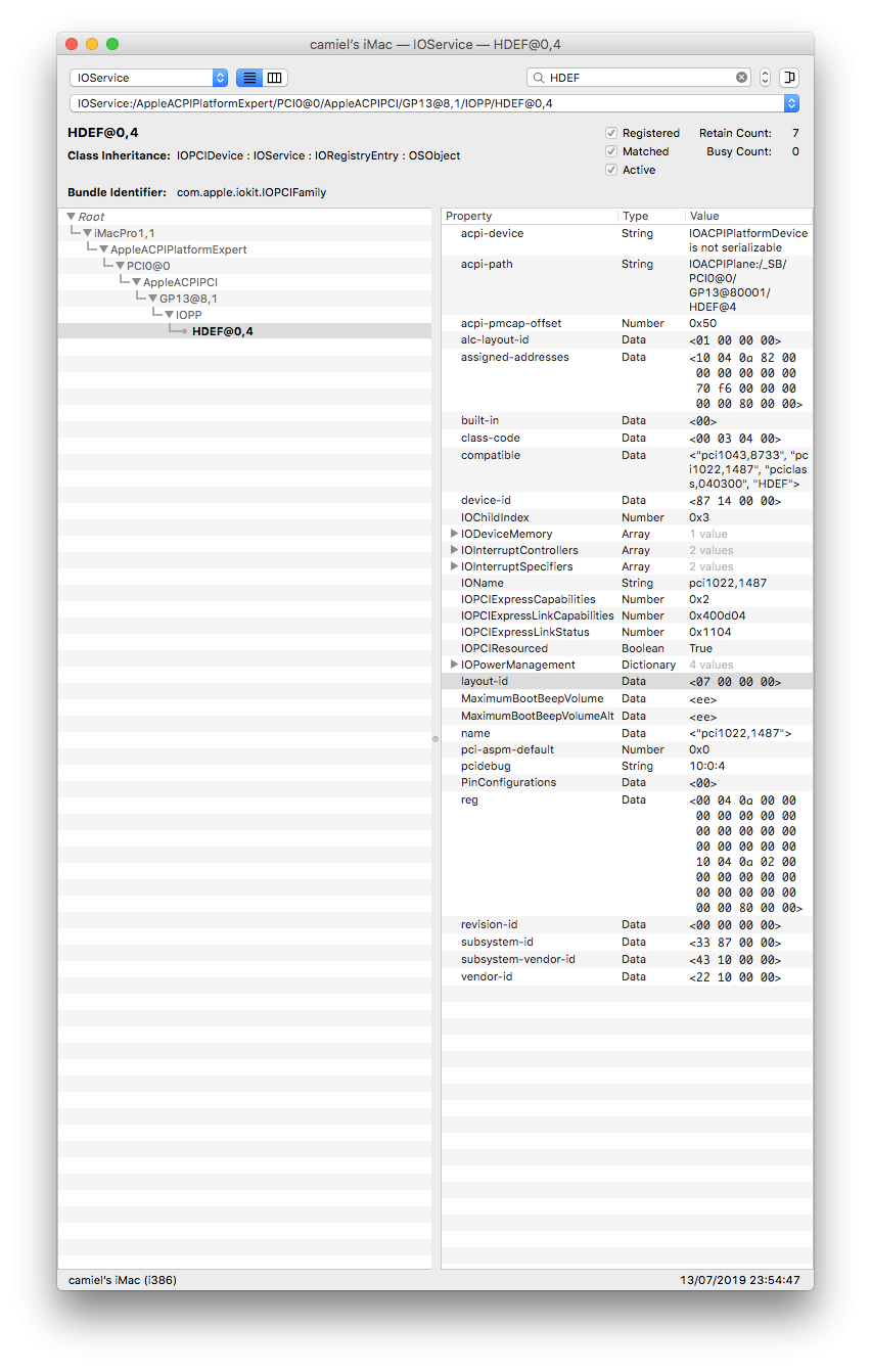

Just got the 3600X and swapped out my Z87 config.plist with the one provided by https://github.com/AMD-OSX/AMD_Vanilla. All seems to be working, except for sound.
My board is the Asus Prime Pro X470 with the Realtek® S1220A audio codec. I have tried the following:
  • Injecting layout-id 1 via Clover
  • Injecting layout-id 1 as an integer to device PciRoot(0x0)/Pci(0x8,0x1)/Pci(0x0,0x4)
  • Hardcoding a layout-id in an SSDT and injecting that
  • Using AppleALC's boot argument alcid
None of these changed the layout-id from 7 to anything else. I'm wondering if this has happened before.
Attached is a screenshot of the HDEF device.
