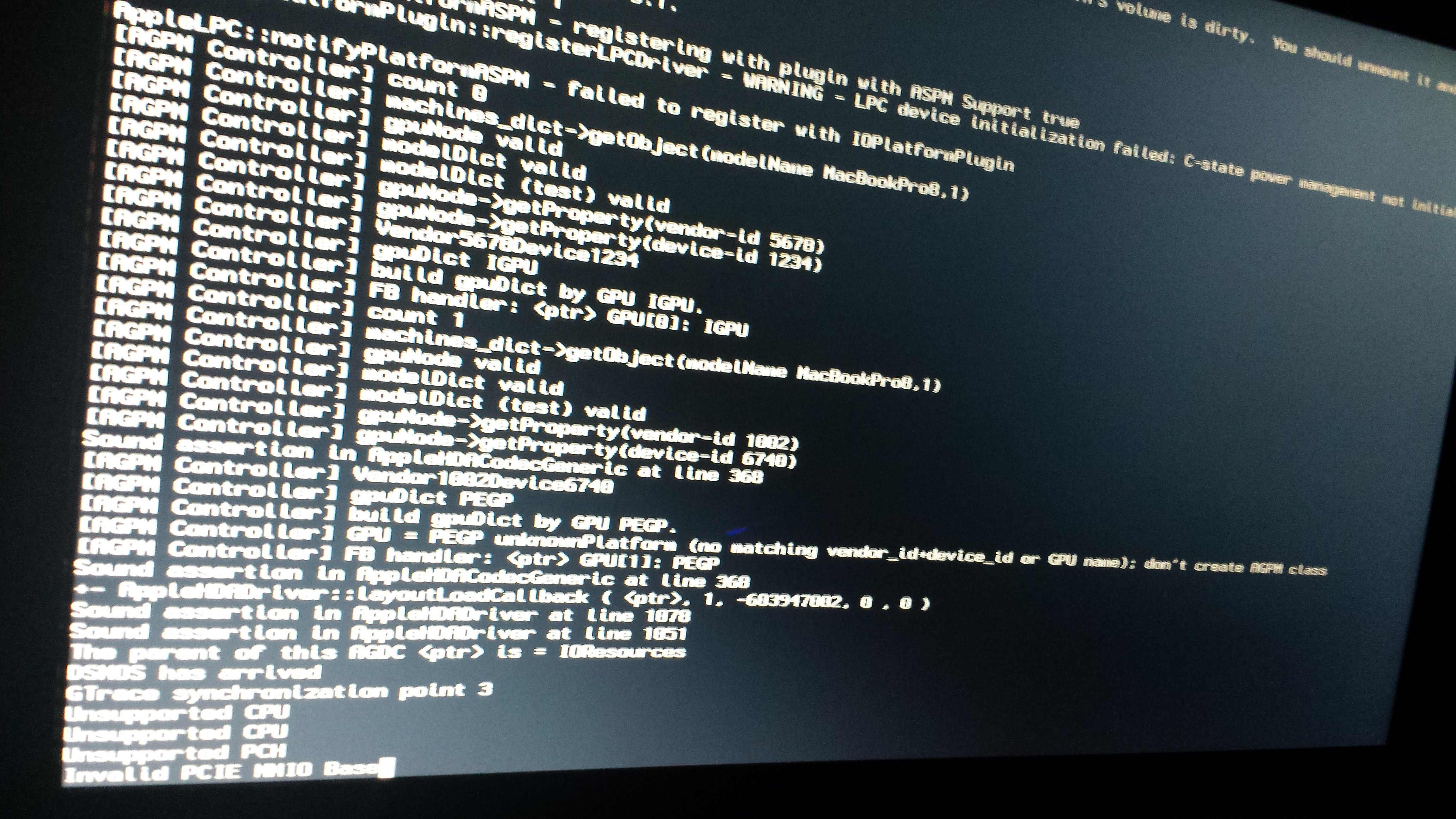

WIZARD1500 Posted July 5, 2019 Share Posted July 5, 2019 Hello. I am having a problem to reach the installer in macOS 10.14.5 when I reach at some point in verbose mode then it restarts automatically (used -no_compat_check). Attached a photo before it restarts. CLOVER.zip Link to comment https://www.insanelymac.com/forum/topic/339397-my-computer-resatarts-before-it-reaches-the-installer/ Share on other sites More sharing options...
WIZARD1500 Posted July 5, 2019 Author Share Posted July 5, 2019 Hp Pavilion dv6 6c65sx i7 2670QM/HM65 Intel HD 3000/Radeon 6700m, 1366x768 Link to comment https://www.insanelymac.com/forum/topic/339397-my-computer-resatarts-before-it-reaches-the-installer/#findComment-2680279 Share on other sites More sharing options...
WIZARD1500 Posted July 6, 2019 Author Share Posted July 6, 2019 18 hours ago, Hervé said: Remove SATA-100-series-unsupported.kext; it's not applicable to your Sandy Bridge platform... Try this Clover config.plist, yours was not adequate: config.plist.zip Then, generate your CPU power management SSDT with Pike R Alpha's well-known generator and place a copy of the resulting ssd.aml in Clover's ACPI/patched folder: https://github.com/Piker-Alpha/ssdtPRGen.sh Now, 2 x things you need to realise with Mojave 10.14: Intel HD3000 is not natively supported (no kexts at all), so you'll have to install SNB-related kexts from 10.13.6 which was the last version to support HD3000. You can look this up. Widely/lengthy discussed since Mojave 1st got out in beta version in May/June 2018... Here for instance. I don't believe Radeon 6700M is supported at all under Mojave. Best for you would be to stick to High Sierra on this ageing laptop. I removed SATA-100-series-unsupported.kext, tried your config.plist and generated SSDT.aml but my laptop restarts with different reading I couldn't take a photo because it is moving fast and then restarts. CLOVER.zip Link to comment https://www.insanelymac.com/forum/topic/339397-my-computer-resatarts-before-it-reaches-the-installer/#findComment-2680428 Share on other sites More sharing options...
