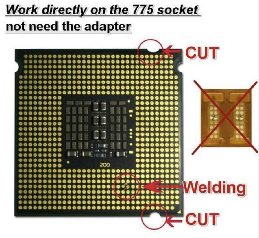

ANONIMNIQ Posted May 6, 2019 Share Posted May 6, 2019 I can buy modified Intel Xeon X3363 for 775 socket for a really good price. The processor is analog of Q9550. I know that Mojave will run on Q9550 with high sierra telemetry plugin the same way It works with my current core 2 duo CPU. Is it OK to use server CPU and do I need extra installation steps? Also, because I will update mu GPU too, do I need fresh installation after the upgrade or everything will work fine? Link to comment https://www.insanelymac.com/forum/topic/338650-did-mojave-will-run-on-intel-xeon-x3363/ Share on other sites More sharing options...
ANONIMNIQ Posted May 7, 2019 Author Share Posted May 7, 2019 Thank you! The CPU is modified to fit in 775 socket just fine. If I need to use fake CPUID how to do that? Is it possible Mojave to recognise the X3363 CPU as Q9550? Btw I can buy this CPU for $15 which is 50% cheaper than Q9550. Link to comment https://www.insanelymac.com/forum/topic/338650-did-mojave-will-run-on-intel-xeon-x3363/#findComment-2672800 Share on other sites More sharing options...
