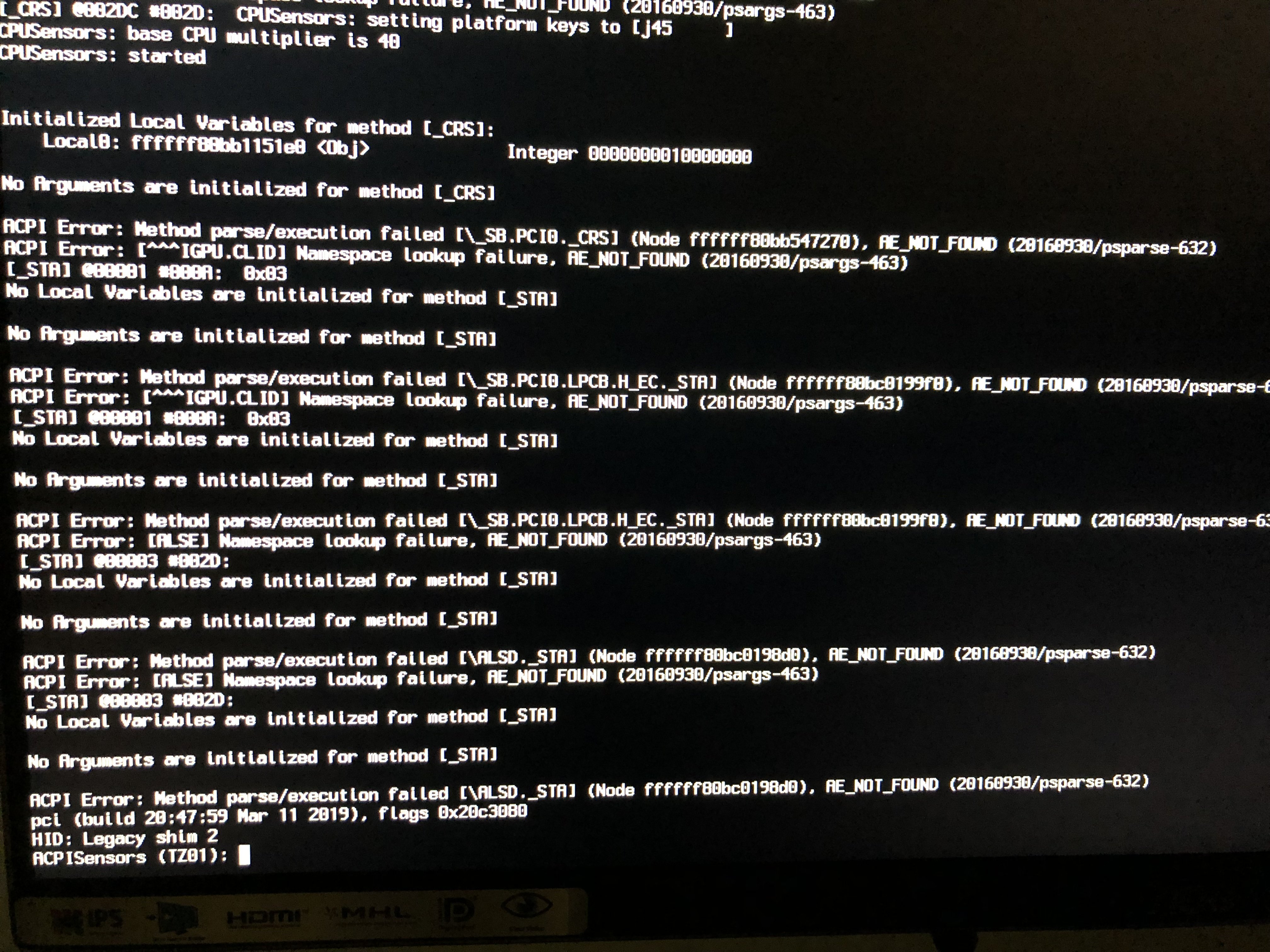

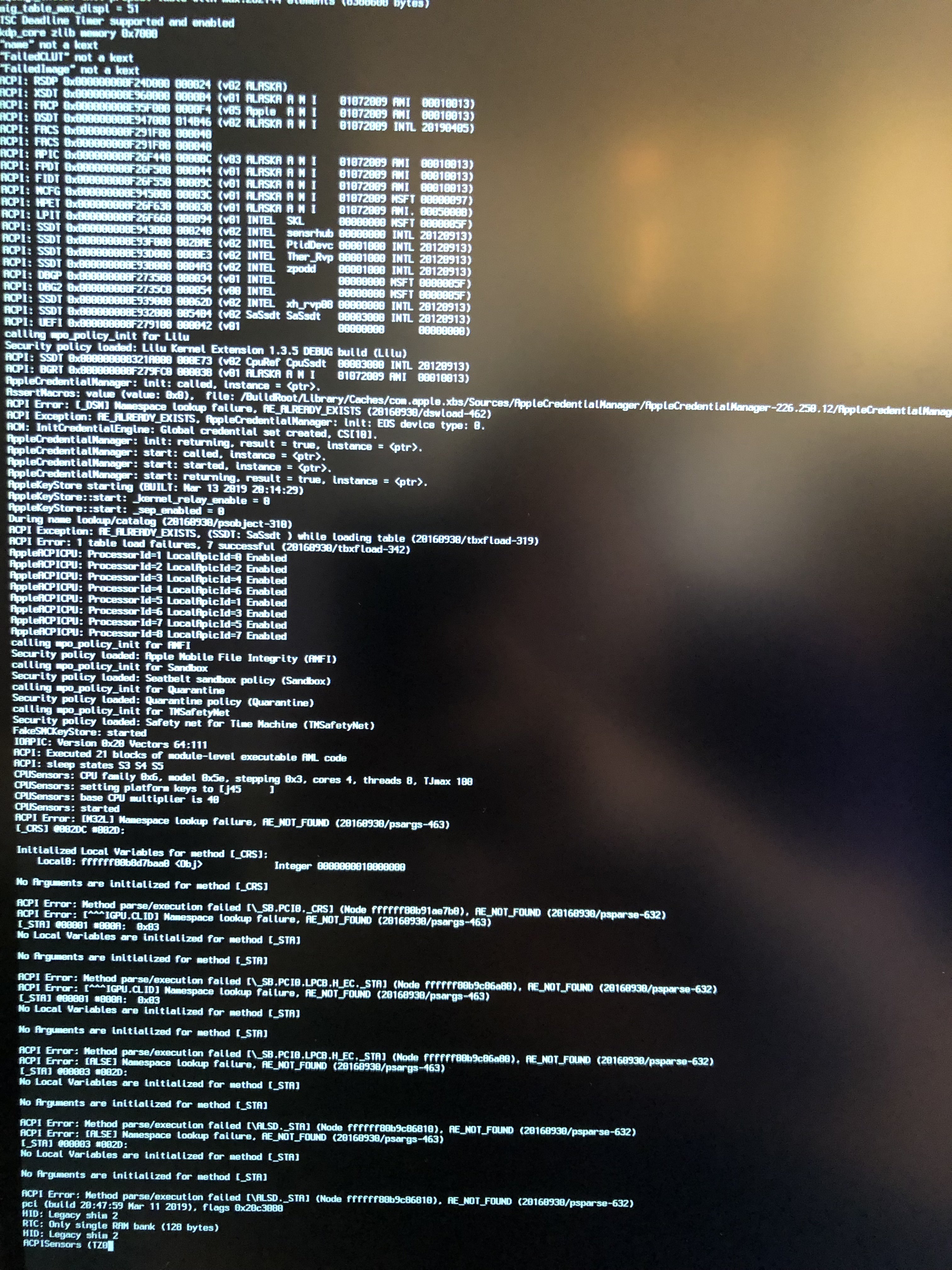

My Information:
MSI z170A Board
Nvidia GTX 1080
Intel I7-6700K (Intel Skylake HD630 Graphics)
I have Windows 10 on one HDD and it works fine with my GTX 1080.
I have Mac OS 10.13.6 (High Sierra) on one HDD and it works fine with my GTX 1080.
Then on another drive I have Mac OS 10.14.4 (Mojave) and it's obvious that it WON'T work (Apple vs. Nvidia blah blah).
However, I want to be able to switch between the three OS's seamlessly without having to plug and unplug constantly. The fairly obvious option is to use my IGPU ={
But 2 out of 3 OS's work with the 1080.
Is there a way to have Mojave use the CPU graphics card but have the other OS's use the Nvidia GPU? I have set in the bios:
IGD Multi-Monitor.
Primary GPU: PEG.
64mb DVMT.
I have also tried:
IGD Multi-Monitor.
Primary GPU: IGD
64mb DVMT.
The problem that arises when I use the IGD is that I get a black screen when using the display port but if I use HDMI I don't get a black screen (for Mojave). For High Sierra I patched the AppleIntelSKLGraphicsFramebuffer and DP works fine but for Mojave it does not. So I came across FrameBuffer Patching with Lilu & WhateverGreen and I used HackinTool 2.3.1 to create a patch (https://www.insanelymac.com/forum/topic/335018-hackintool-v231/). On Mojave it still doesn't work unless I use HDMI.
So now I'm out of options. I can't figure out how to use the IGPU for all the OS's OR the Nvidia GTX 1080 for all the OS's.. I'd prefer to use the 1080 and have it somehow route to the IGPU just for Mojave though.. but that might not be possible? If it's not possible, how can I get the IGPU working for all?
Anyway, here is my config for Mojave:

The High Sierra part works as expected :)
The Mojave part complains about the DSDT method having no arguments.
@Herve; I’m already trying that. They’re on two different drives.

8 hours ago, MaLd0n said:
Mojave
1- Replace Full Clover Folder
2- Install Clover again with correct options
Last Clover Version UEFI
I installed the latest clover right after replacing the entire folder. Same problem.
With that DSDT.aml, it always gives this error for Mojave.

I removed the DSDT (with that DSDT, it never boots.. I tried opening it with MacIASL, it also doesn't open) and I was able to boot Mojave successfully without the errors above. I attached the "RunMe" results..
