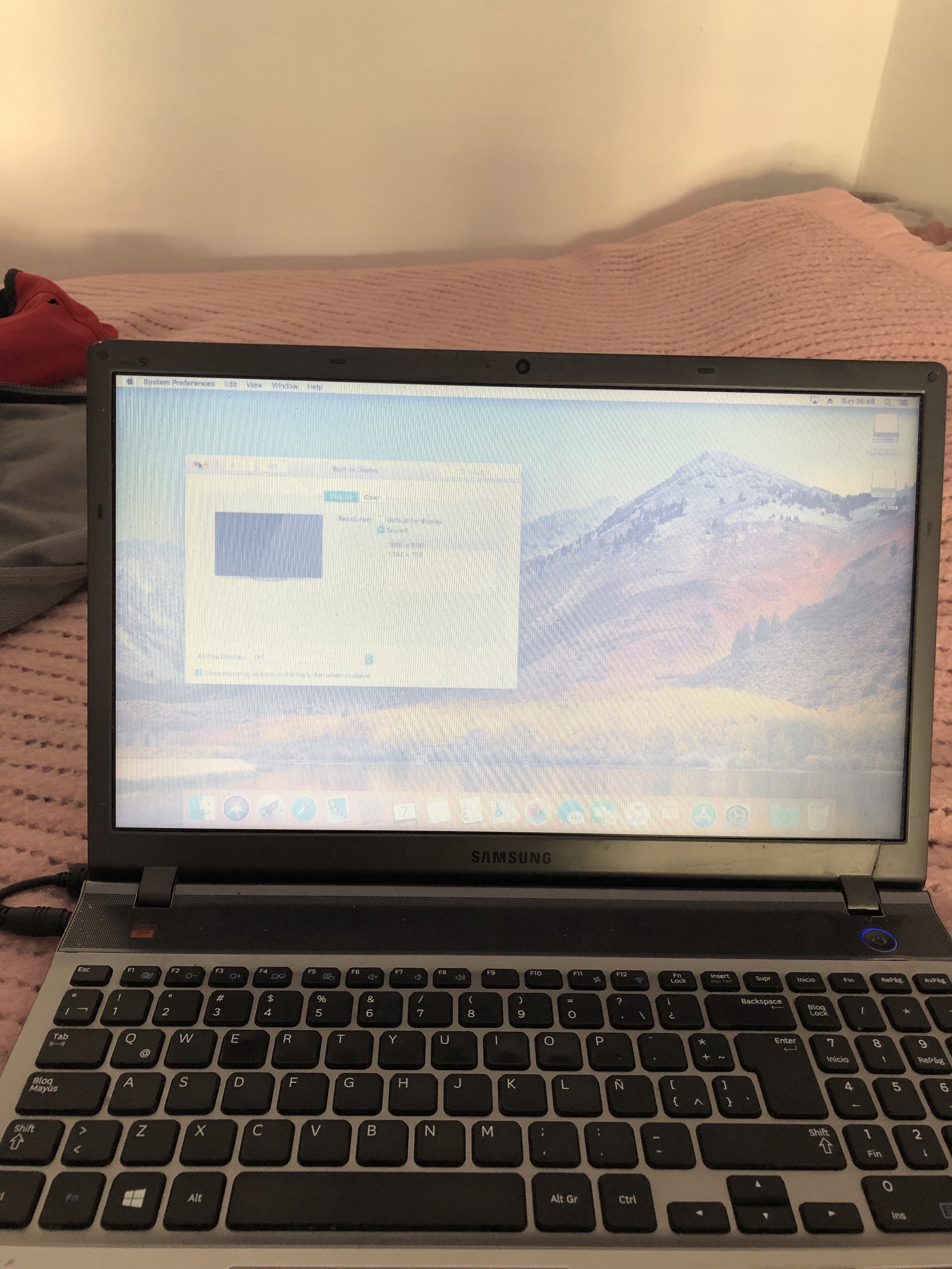

Stompyy Posted April 7, 2019 Author Share Posted April 7, 2019 (edited) On 4/5/2019 at 6:00 PM, Hervé said: GraphicsEnabler is a Chameleon boot option; not applicable to Clover Same for IGPEnabler, except it's a Voldemort's option. Post a zipped copy of your Clover EFI folder, bearing in mind that TMX tools have no support here... Hey! Thanks for reaching out. I actually made some progress and was now able to at least get to Desktop. Did a fresh High sierra install and was able to get to the desktop, which is extremely choppy and garbled as you can see on the attached picture. I tried HS due to the fact I remembered last year being able to boot to the Desktop (what I just accomplished), if I am able to iron out all the bugs, then Ill upgrade to Mojave. * I tried countless ig-platforms-ids for my HD400 and the one which came by default on RehabMans config.plist was the one which actually "worked", choppy af but I got an image at least, all others would just either reboot or give me insane graphics. id being: 04006601. * Also disabled my dGPU by following this guide. (havent checked if it worked though, how can I check that?). **The config.plist provided by RehabMan wasnt bootable at all, I had to untick inject Nvidia and slide=0 (maybe this last one doesnt matter, but inject nvidia had to be unticked afaik). Upon googling, RM suggested this could be fixed by enabling/disabling CSM in BIOS, sadly my BIOS has no toggle related to CSM whatsoever. Ill attach a pic of the garbling as well as my efi folder. Thanks again! PD: Im aware I linked a TM guide as well as tagged a TM moderator, if thats not allowed then my apologies. One things for sure, Im staying the f*** away from any beast related tools :). Stompys EFI.zip Edited April 7, 2019 by Stompyy Link to comment Share on other sites More sharing options...

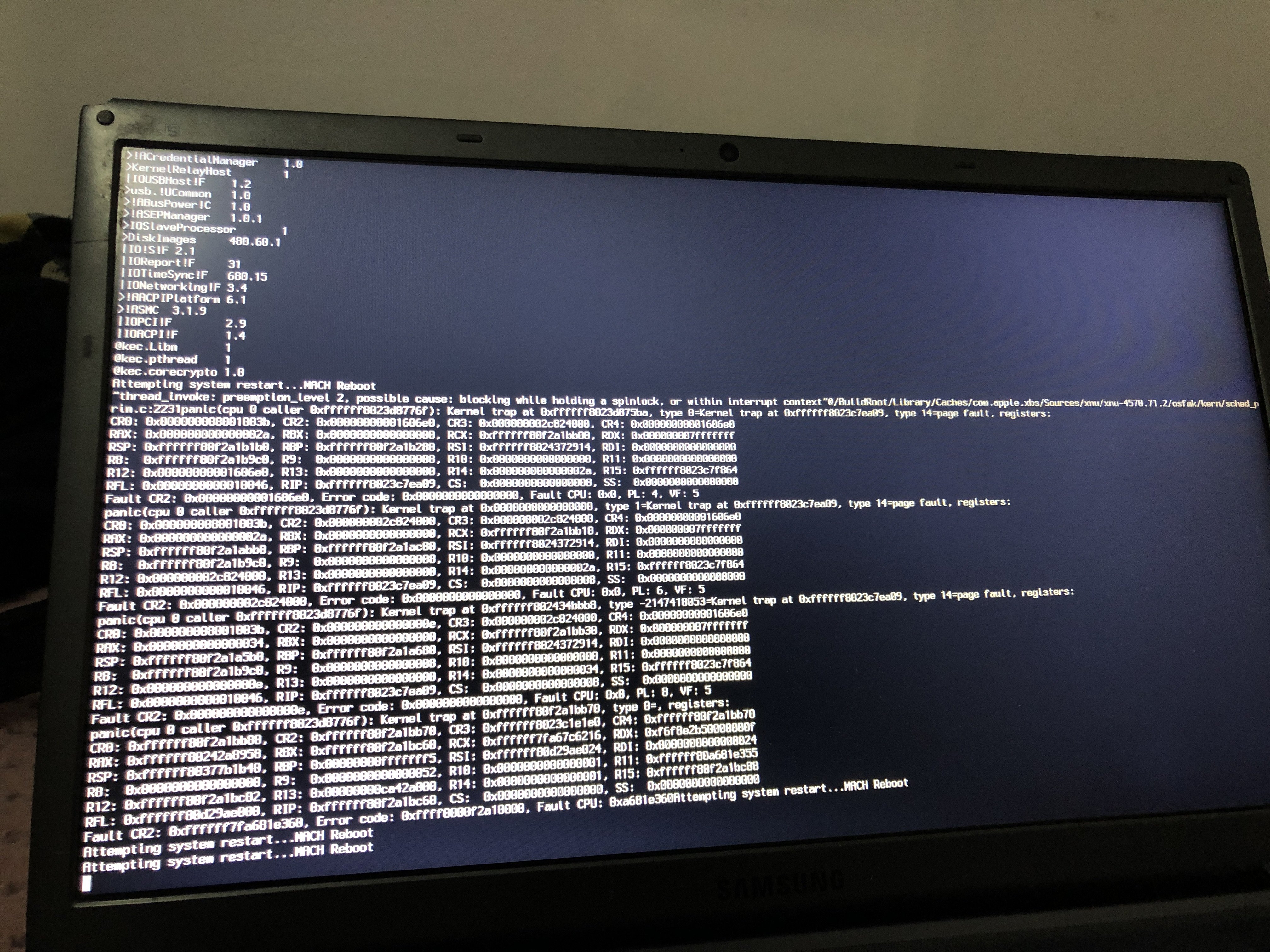

Stompyy Posted April 8, 2019 Author Share Posted April 8, 2019 5 hours ago, Hervé said: Try this config.plist (yours with some cleaining up, especially the removal of ATI graphics injection...) config.plist.zip Thank you for taking the time to provide a custom config. Just tried it. Without touching your config, it goes straight into a black glowing screen (with and without -v). Making a couple changes such as injecting nvidia and using nv_disable=1 results in the attached picture. If you can think of anything else for me to try, let me know please! Thanks. Link to comment Share on other sites More sharing options...
