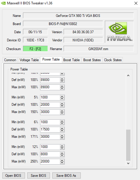

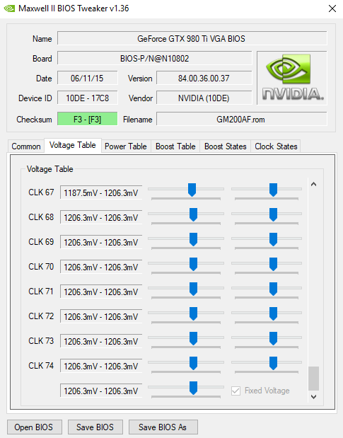

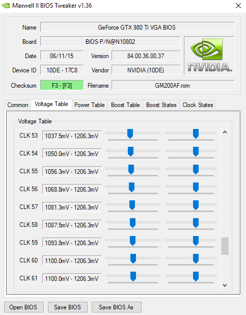

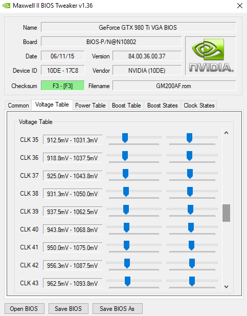

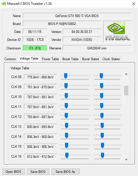

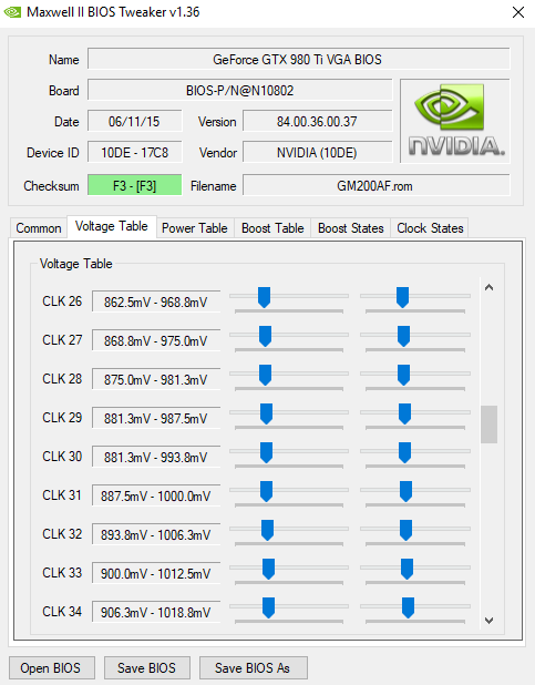

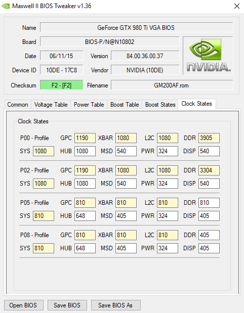

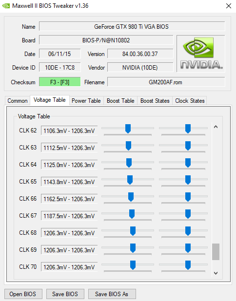

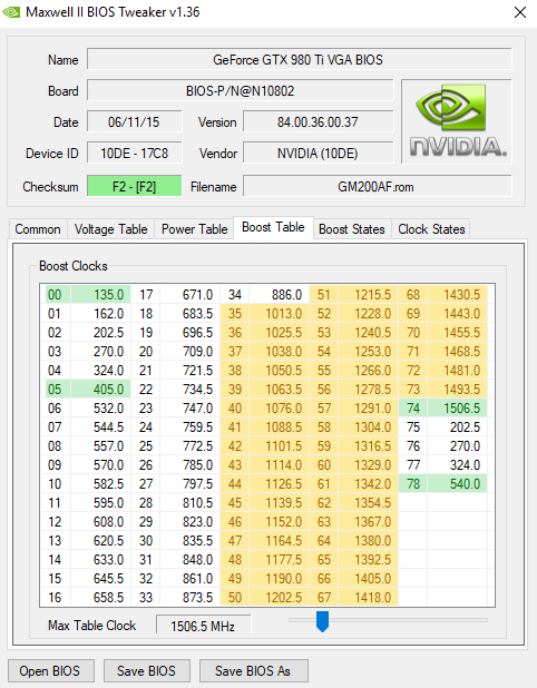

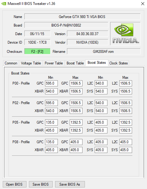

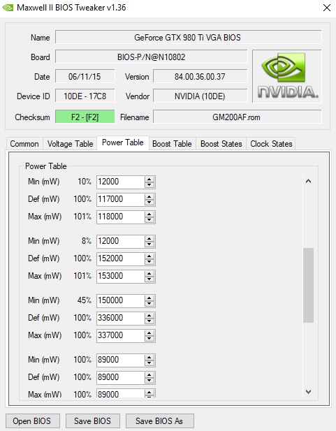

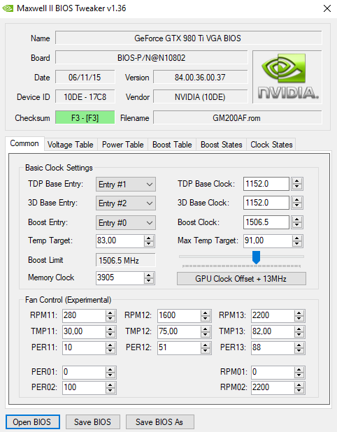

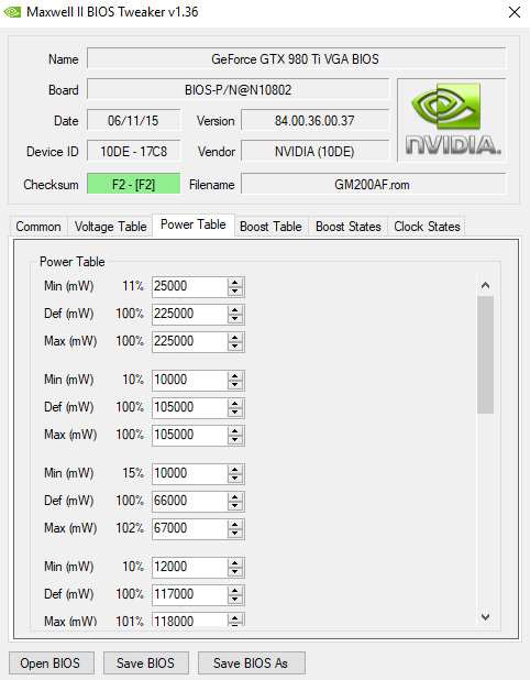

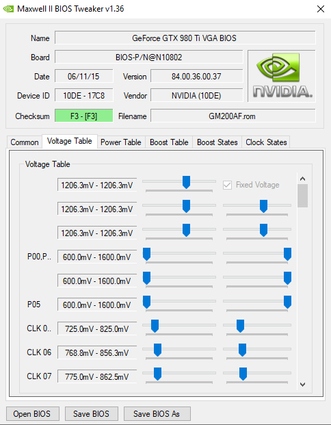

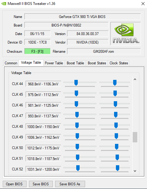

Here are the screenshots of the settings I made in the Maxwell Bios Tweaker:
Spoiler
Screenshots
bm1.PNG.a0c5889142bb1630920230666b106523.PNGbm2.PNG.edfb85e2f3d9f9527d8c7c9b29f5d05a.PNGbm3.PNG.d90dfb2b1a559a2543bd5903ee77a85e.PNGbm4.PNG.c4196ff8e964b08cab2c51f7654011a5.PNGbm5.PNG.ef492a37aa44e1fa81f49137a9957af1.PNGbm6.PNG.93a4c4f7682d5fe1aec7d28c1396ea2e.PNGbm7.PNG.cc1bba0627d43947ccf013d5a9914d7c.PNGbm8.PNG.d9cd976ae169895fc410a664faa22e04.PNGbm9.PNG.26efb1066085df14c6c4912182361162.PNGbm10.PNG.02df2dbb1d342e7a8640e201777715c9.PNGbm11.PNG.a6f98230a492c50ef955aacce4922cbc.PNGbm12.PNG.d688b8a0ce1daec8e8d0862c70cb0ac6.PNGbm13.PNG.e8e7ad5000de710eaaf54d83f868c035.PNGbm14.PNG.76fa1c0c3cd63209ac7d38e2d84857d1.PNGbm15.PNG.8cea0caa76def83cef77e04ffa9ca87c.PNGbm16.PNG.e6196b874d1abab2ce8da25a27bede72.PNG
I really would love to get the extra boost for video editing on my hackintosh. Is there a way to achieve that?
