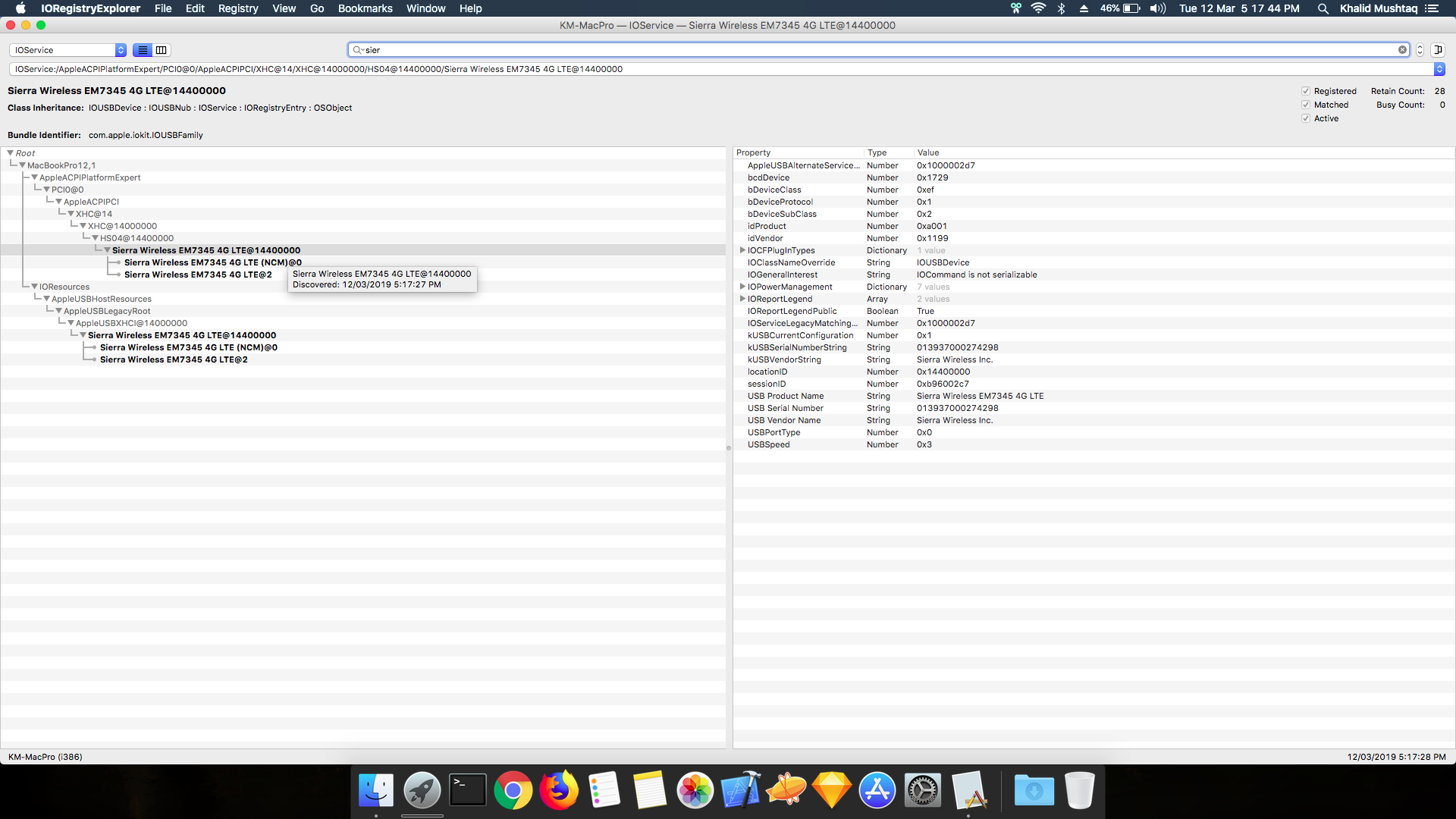

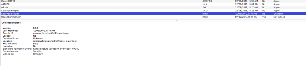

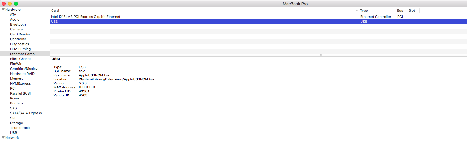

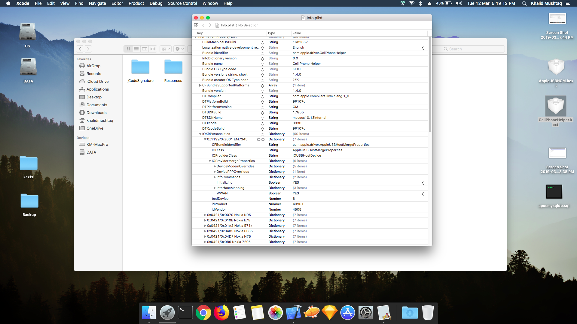

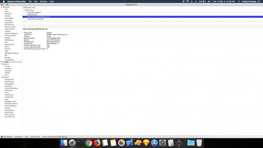

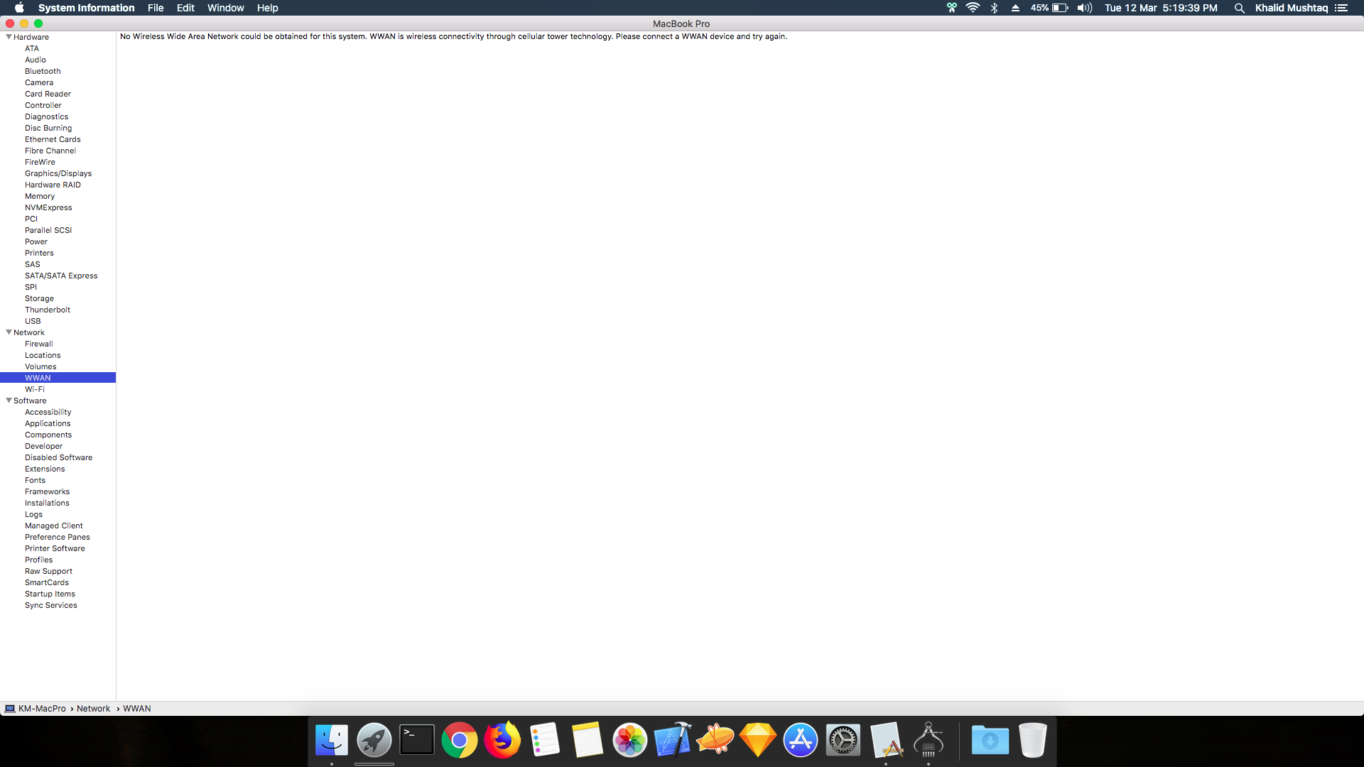

Khalid Mushtaq Posted March 12, 2019 Share Posted March 12, 2019 Hello, I have got Sierra Wireless EM7345 and installed into X1 Carbon 3rd Generation using High Sierra 10.13.6 but I am unable to get it working. - I have renamed CellPhoneHelper.kext in /S/L/E to CellPhoneHelper.kext.bak and moved to /L/E after editing and tried after rebuilding cache but no success ( screenshot attached ) - Card is recognized and I can see it in IOREG, USB but not anything in WWAN ( screenshots attached ) - I am surprised why it is showing as USB under Ethernet Cards in System Information ( screenshot attached ) I have attached screenshots please let me know how I can get it working. Thanks in advance. Khalid Link to comment Share on other sites More sharing options...
Hervé Posted March 12, 2019 Share Posted March 12, 2019 (edited) A few comments: it's not a good idea to rename the CellPhoneHelper in S/L/E whilst placing a patched version in /L/E. What you should do instead is keep the vanilla version untouched in /S/L/E and increase the version of the patched kext in /L/E. In the presence of 2 x kexts carrying the same name, OS X/macOS will only load the highest version. If both kext carry the same version, both will load with unavoidable/inevitable risk of conflict... you've clearly done something wrong if your WWAN module -a USB device by its own very nature- gets listed under the Ethernet category after your attempted CellPhoneHelper patch. Please post details of what you've done interms of CellPhoneHelper patch. I presume you added an entry for your EM7345, albeit incorrectly. Please note that this can be done much more securely in FakeSMC: you simply add your new entry in FakeSMC's Info.plist file as an add-on to CellPhoneHelper's kext. You can will find numerous examples related to this here. I've spent quite a lot of time working with WWAN modules in the past. Patching CellPhoneHelper may not be enough and you may find you have to set the module into the desire mode of operations before you can use it... By default, you may even find that the device is set to airplane mode, i.e. silenced! I believe you should find useful info about what you need to do in this thread. You will find info related to the AT commands by Googling on "EM7345 AT commands". Zukota.com seems excellent. One of the significant points to note with the EM7345 WWAN module is that it runs on an Intel chipset, not a Qualcomm one so behaviour may be totally different than that of EM7305 or EM7455 counterparts. Edited March 12, 2019 by Hervé Link to comment Share on other sites More sharing options...
Khalid Mushtaq Posted March 12, 2019 Author Share Posted March 12, 2019 1 hour ago, Hervé said: you've clearly done something wrong if your WWAN module -a USB device by its own very nature- gets listed under the Ethernet category after your attempted CellPhoneHelper patch. It is showing without CellPhoneHelper patch. Link to comment Share on other sites More sharing options...

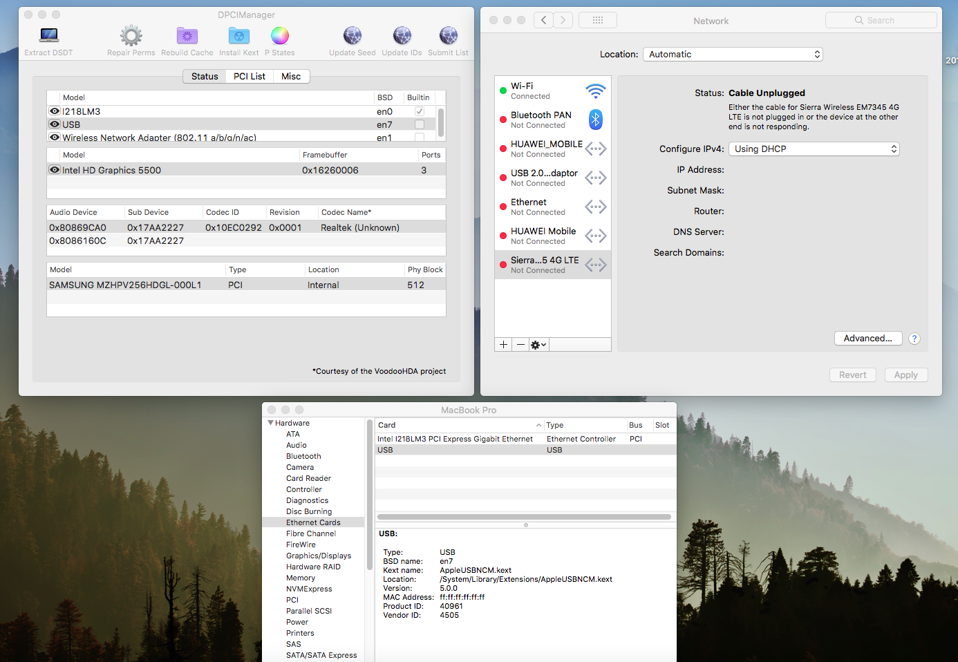

Khalid Mushtaq Posted March 12, 2019 Author Share Posted March 12, 2019 1 hour ago, Hervé said: A few comments: it's not a good idea to rename the CellPhoneHelper in S/L/E whilst placing a patched version in /L/E. What you should do instead is keep the vanilla version untouched in /S/L/E and increase the version of the patched kext in /L/E. In the presence of 2 x kexts carrying the same name, OS X/macOS will only load the highest version. If both kext carry the same version, both will load with unavoidable/inevitable risk of conflict... I have attached screenshots after making this change. Both kexts are showing but no one is being loaded. Why AppleUSBNCM.kext is being loaded? See screenshot please. Link to comment Share on other sites More sharing options...
