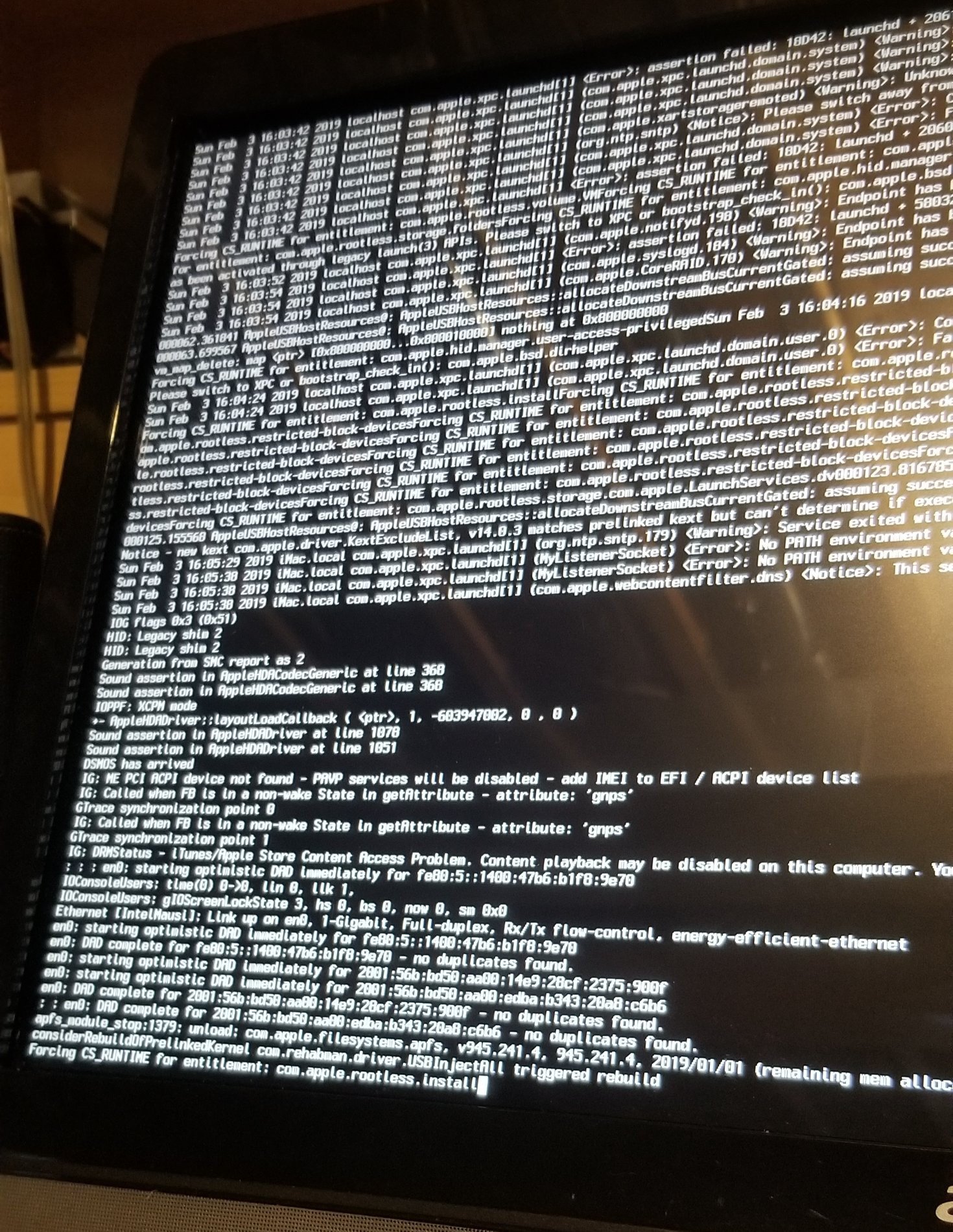

emilevirus Posted February 4, 2019 Share Posted February 4, 2019 I can't get on installation screen. It gets stuck at "usbinjectall triggered rebuild" and a few minutes later, my PC goes into sleep and black screen. Without usbinjectall, it just KP because it can't find USB.Asrock Z170A-X1i7-6700k2x8GB 2400 MHzEVO 850 SSDR9 280 Link to comment https://www.insanelymac.com/forum/topic/337508-cant-get-installation-screen-with-asrock-z170a-x1-i7-6700k/ Share on other sites More sharing options...

ghost9685 Posted February 27, 2019 Share Posted February 27, 2019 I am having the same problem, I have installed but getting KP while booting. .WIll check today and get back if i find anything On 2/5/2019 at 2:15 AM, emilevirus said: I can't get on installation screen. It gets stuck at "usbinjectall triggered rebuild" and a few minutes later, my PC goes into sleep and black screen. Without usbinjectall, it just KP because it can't find USB.Asrock Z170A-X1i7-6700k2x8GB 2400 MHzEVO 850 SSDR9 280 Try installing by pluging your monitor to on board GFX and disable PCI E in bios and enable IGFX, input initial GFX mem to 64 M and Max to 256MB . Link to comment https://www.insanelymac.com/forum/topic/337508-cant-get-installation-screen-with-asrock-z170a-x1-i7-6700k/#findComment-2665473 Share on other sites More sharing options...
