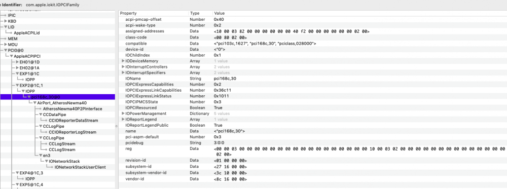

nijhawank Posted January 31, 2019 Author Share Posted January 31, 2019 (edited) Here are some screenshots from ioregistryexplorer and system information app Edited January 31, 2019 by nijhawank Link to comment https://www.insanelymac.com/forum/topic/337430-ar5bhb112-with-chipset-ar9380/#findComment-2662090 Share on other sites More sharing options...
nijhawank Posted January 31, 2019 Author Share Posted January 31, 2019 Perfecto. I will try your suggestions over the weekend. Very much appreciate your prompt responses and help in this regard. Otherwise, the card works fine on Windows 10 with the default drivers automatically discovered by Windows. It's a dual boot (Windows 10 + Mojave) machine (T410). I'm able to connect to both of my home 2.4 and 5ghz networks. I live in USA. Link to comment https://www.insanelymac.com/forum/topic/337430-ar5bhb112-with-chipset-ar9380/#findComment-2662154 Share on other sites More sharing options...
