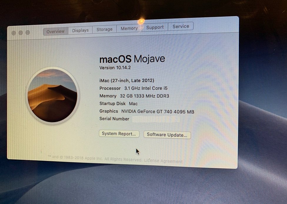

loganMac Posted January 8, 2019 Share Posted January 8, 2019 (edited) ASUS P8B75-M/CSM Corsair 32Gb DDR3-1333 EVGA GeForce GT 740 SC 4GB (Kepler GK107 chip) - OOB Mojave 10.14.2 Samsung SSD 500Gb First of all thanks to Clover teams, theme teams, and InsanelyMac peepz. Format USB: Disk Utility-->Under View, select All Devices Select USB drive-->Partition-->Partition-->MacOS Extended (Journaled) Then Select USB drive-->Earse-->MacOS Extended (Journaled)-->GUID Partition Map Bootable USB: Terminal: sudo /Applications/Install\ macOS\ Mojave.app/Contents/Resources/createinstallmedia --volume /Volumes/USB --nointeraction &&say Done Install Clover Bootloader to USB Select Clover for UEFI booting only and Install Clover in the ESP UEFI Drivers-->ApfsDriverLoader-64, AptioMemoryFix-64, and PartitionDxe-64 FileValve 2 UEFI Drivers-->AppleImageCodec-64 and FirmwareVolume-64 Copy FakeSMC, Lilu, WhateverGreen, RealtekRTL8111, USBInjectAll, and VoodooHDA to EFI\CLOVER\Kext\Other Use Clover Config to edit confit.plist: Boot--> -v and nv_disable=1 KernelAndKextPatches-->Apple RTC, AppleIntelCPUPM, and KernelPM SMBIOS--> iMac 13,2 Install Driver from Clover Config: Driver UEFI 64 Bit-->NTFS-64 and HFSPlus-64 Post Installation: Install Clover Bootloader to HD Select Clover for UEFI booting only and Install Clover in the ESP UEFI Drivers-->ApfsDriverLoader-64, AptioMemoryFix-64, and PartitionDxe-64 FileValve 2 UEFI Drivers-->AppleImageCodec-64 and FirmwareVolume-64 Copy FakeSMC, Lilu, WhateverGreen, RealtekRTL8111, USBInjectAll, and VoodooHDA to EFI\CLOVER\Kext\Other Use Clover Config to edit confit.plist: Boot--> delete TimeOut and put check mark on -1 GUI--> Hide Volume--> Recovery, VM, and Preboot KernelAndKextPatches-->Apple RTC, AppleIntelCPUPM, and KernelPM SMBIOS--> iMac 13,2 Using Clover Config to install blower drivers: Driver UEFI 64 Bit-->NTFS-64 and HFSPlus-64 Reboot For dual boot: Correcting Time in Windows: 1. regedit 2. Navigate to HKEY_LOCAL_MACHINE\SYSTEM\CurrentControlSet\Control\TimeZoneInformation 3. Right click anywhere in the right pane and hit New > DWORD (32-bit) Value. 4. Name it RealTimeIsUniversal, then double click on it and give it a value of 1. 5. reboot 6. login to macOS 7. Reboot 8. login to Windows 9. Your time your be right Edited January 10, 2019 by loganMac change iMac18,2 to iMac13,2. 13,2 sound more right on my system Link to comment https://www.insanelymac.com/forum/topic/337137-guide-asus-p8b75m-csm-mojave-10142-success/ Share on other sites More sharing options...
loganMac Posted January 23, 2019 Author Share Posted January 23, 2019 (edited) Updated to 10.14.3 at no problem using Software Update Edited January 23, 2019 by loganMac Link to comment https://www.insanelymac.com/forum/topic/337137-guide-asus-p8b75m-csm-mojave-10142-success/#findComment-2660740 Share on other sites More sharing options...
