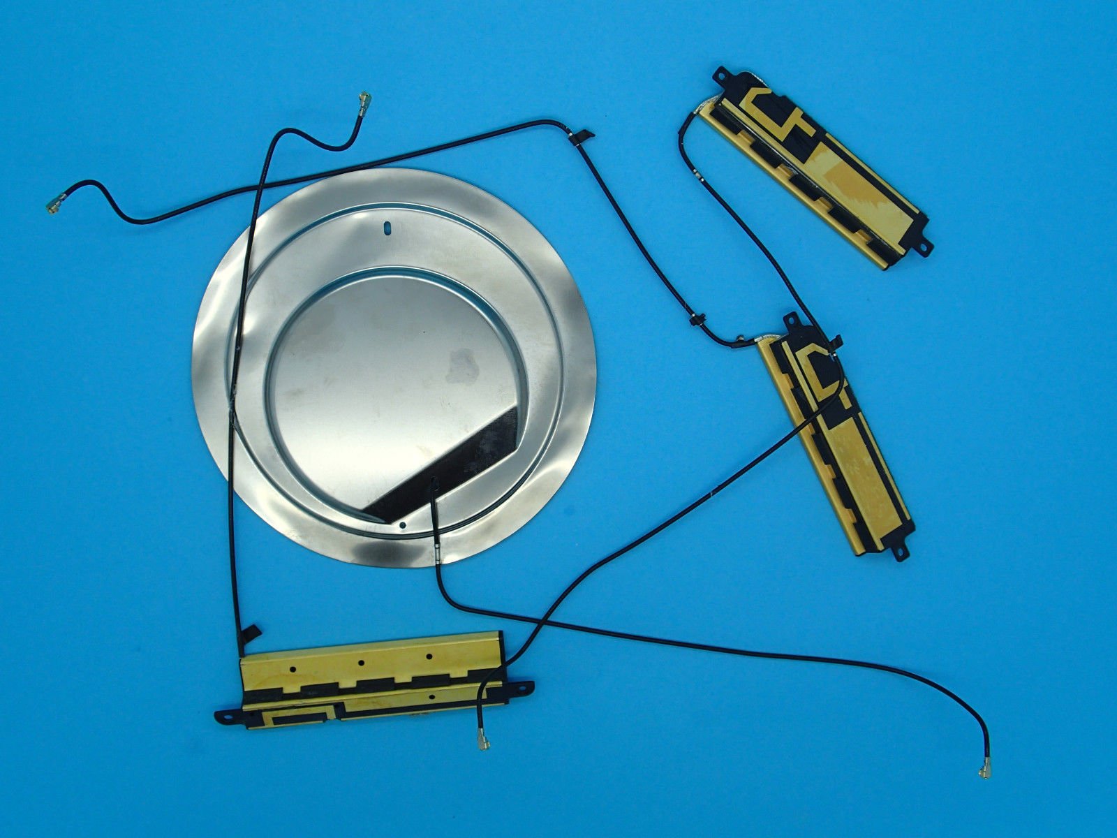

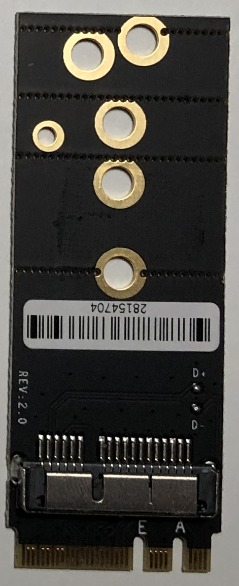

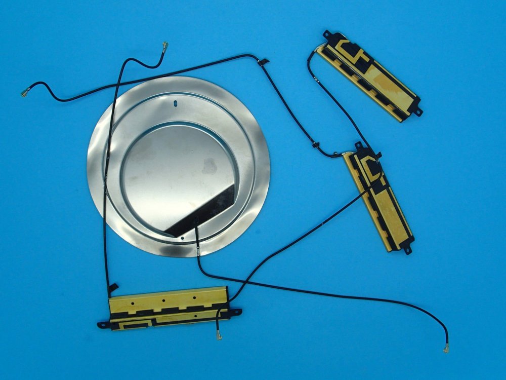

Joni_78 Posted December 14, 2018 Share Posted December 14, 2018 (edited) Hi, I finally bought an NGFF M.2 adapter and tried it with 2017 iMac BCM943602CDP. I just wanted to write this since I didn't found anything about BT4.2 and incase someone is wondering about the same thing. Works OOTB, wakes up by Magic Mouse and Magic Keyboard. Mouse and keyboard also works on BIOS too. Adapter shipping took slightly over a week. I also bought the three WiFi and one BT internal antennas from iMac so I could get the antennas inside the case. Antennas are from 2013 27" iMac. 2015 iMac BT WiFi card is also BCM943602CDP but it is 4.1, so make sure to check that the card came from 2017 iMac. Edited December 15, 2018 by Amble Link to comment https://www.insanelymac.com/forum/topic/336894-bluetooth-42-with-bcm943602cdp-and-ngff-m2-adapter/ Share on other sites More sharing options...
Joni_78 Posted December 14, 2018 Author Share Posted December 14, 2018 (edited) 10 minutes ago, Hervé said: Erm, it's not an NGFF to M.2 adapter. It's an NGFF/M.2 adapter for Apple's combo PCIe/BT cards that have a proprietary PCIe connector. Thanks, edited title. I always thought its NGFF to M.2 Edited December 14, 2018 by Amble Link to comment https://www.insanelymac.com/forum/topic/336894-bluetooth-42-with-bcm943602cdp-and-ngff-m2-adapter/#findComment-2653791 Share on other sites More sharing options...
