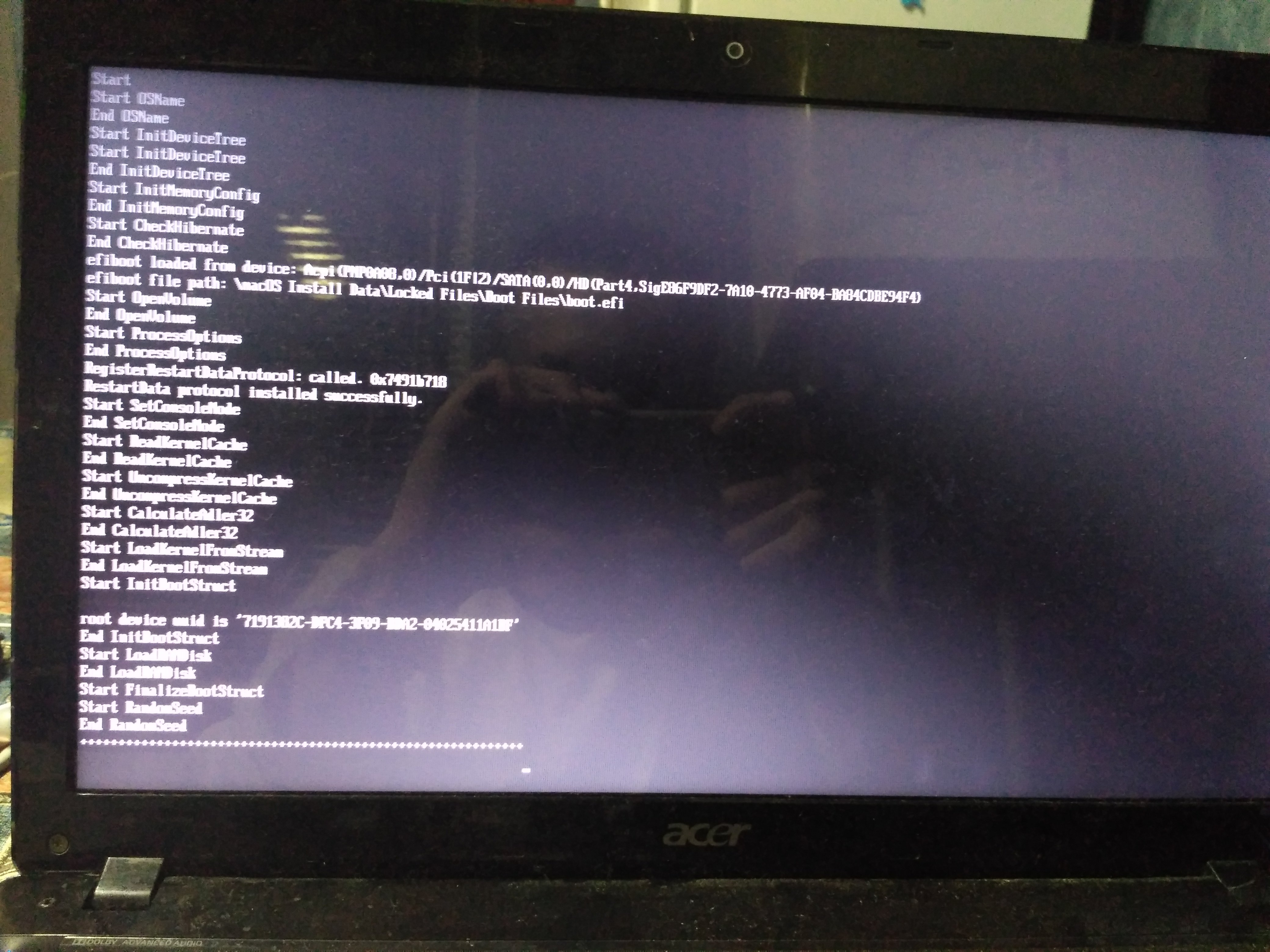

rvi64 Posted November 25, 2018 Share Posted November 25, 2018 (edited) I've been using Yosemite for a bit on my laptop and so apple decided to give me an update that is High Sierra, I've ran High Sierra Installer and chose the other partition in case something happens to not destroy my main Yosemite. Now when I load to continue installing High Sierra is loads to (see attached photo) and then restarts my laptop. Yosemite still works "fine". My kexts: 10.13 & Other: FakeSMC.kext FakeSMC_SMMSensors.kext FakeSMC_ACPISensors.kext GenericUSBXHCI.kext FakeSMC_CPUSensors.kext USBInjectAll.kext FakeSMC_GPUSensors.kext VoodooPS2Controller.kext FakeSMC_LPCSensors.kext My drivers64UEFI: DataHubDxe-64.efi FSInject-64.efi SMCHelper-64.efi VBoxHfs-64.efi apfs.efi My config.plist:http://ix.io/1upe Clover version v2.4k_r4769 Specs: Model: Acer Aspire 5750G P5WE0 CPU: Intel Core I3-2310M RAM: 2G SSD: 128G Graphics: Intel HD Graphics Integrated, NVIDIA GeForce GT 520M (disabled in BIOS) Ethernet: Broadcom (working with FakePCIID_BCM57XX_as_BCM57765.kext) Audio: Dolby HDA (Working with a specific VoodooHDA 2.8.7) Problems on Yosemite: Graphic glitches (lines) in Chrome after some intense work (overheating??). Keyboard doesn't work in Yosemite (works in Clover), USB keyboard works fine, USB mouse too. When I start Yosemite i put laptop to sleep, when it goes to complete sleep i wake it up and keyboard starts working, but screen becomes more dim (like 80-90%), still ok but i hope it is fixable. I cannot control screen brightness at all, patched DSDT only helped me with battery indicator. But the main problem is i want to update to High Sierra. What could I do? Edited November 28, 2018 by rvi64 remove yosemite problem Link to comment https://www.insanelymac.com/forum/topic/336598-solved-acer-aspire-5750g-yosemite-high-sierra-update/ Share on other sites More sharing options...
rvi64 Posted November 25, 2018 Author Share Posted November 25, 2018 How exactly do i boot it? Link to comment https://www.insanelymac.com/forum/topic/336598-solved-acer-aspire-5750g-yosemite-high-sierra-update/#findComment-2649792 Share on other sites More sharing options...
rvi64 Posted November 26, 2018 Author Share Posted November 26, 2018 11 hours ago, Hervé said: You should see it at Clover's main menu, to the left of your ex-Yosemite partition. That is what im loading and then it goes to the (see screenshot) and laptop restarts, and then nothing happens. Link to comment https://www.insanelymac.com/forum/topic/336598-solved-acer-aspire-5750g-yosemite-high-sierra-update/#findComment-2649866 Share on other sites More sharing options...
rvi64 Posted November 26, 2018 Author Share Posted November 26, 2018 solved(kinda) fix: add ram fields to SMBIOS in clover config Link to comment https://www.insanelymac.com/forum/topic/336598-solved-acer-aspire-5750g-yosemite-high-sierra-update/#findComment-2649981 Share on other sites More sharing options...
