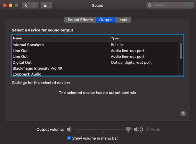

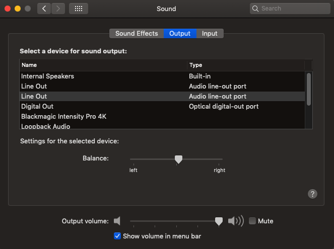

fuzzylogic Posted November 11, 2018 Share Posted November 11, 2018 (edited) audio id = 1 both sets of Audio line out ports work Internal Speakers Green port on the back does not have an output have tried all audio id and it did not make any difference os Mojave Edited November 12, 2018 by osxone update Link to comment Share on other sites More sharing options...

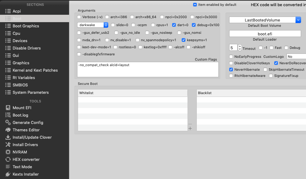

Andres ZeroCross Posted November 12, 2018 Share Posted November 12, 2018 Try to use bootargumen "alcid=layout" then set layoutid at your config.plist to "1" and another layoutid. Remember to use the boot-argument 1 Link to comment Share on other sites More sharing options...

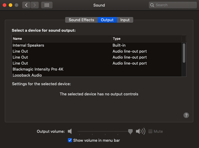

fuzzylogic Posted November 12, 2018 Author Share Posted November 12, 2018 Hi Thanks for . your reply adding the above to the boot arg made all speakers and inputs disappear, i did try with different layout id but did not produce a result. Link to comment Share on other sites More sharing options...

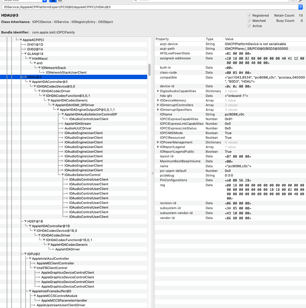

Andres ZeroCross Posted November 13, 2018 Share Posted November 13, 2018 8 hours ago, osxone said: Are you normal person???? I ask about problem reporting files,, where is the files?? Upload the IOREG Output?? Why did you upload the image?? I don't need image. 1 Link to comment Share on other sites More sharing options...

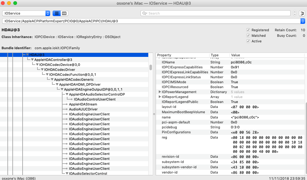

fuzzylogic Posted November 14, 2018 Author Share Posted November 14, 2018 osxone’s iMac.ioregAudioDeviceName.txt Link to comment Share on other sites More sharing options...

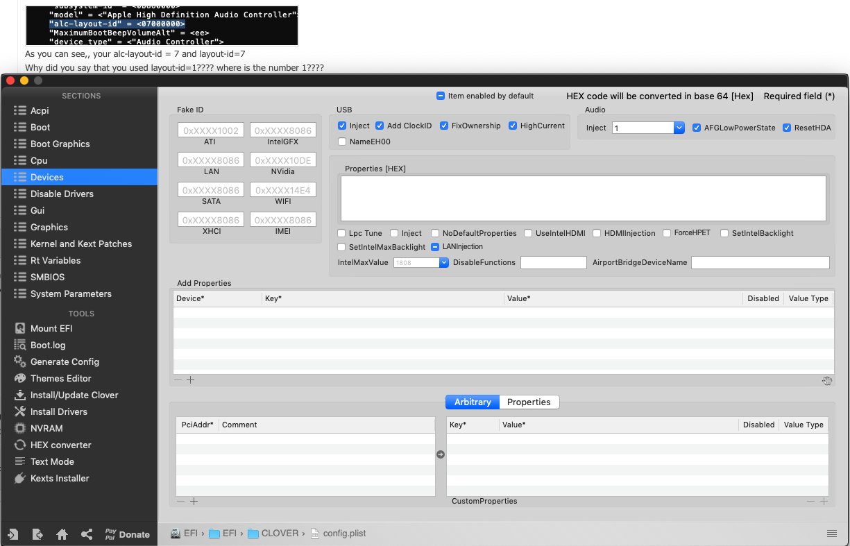

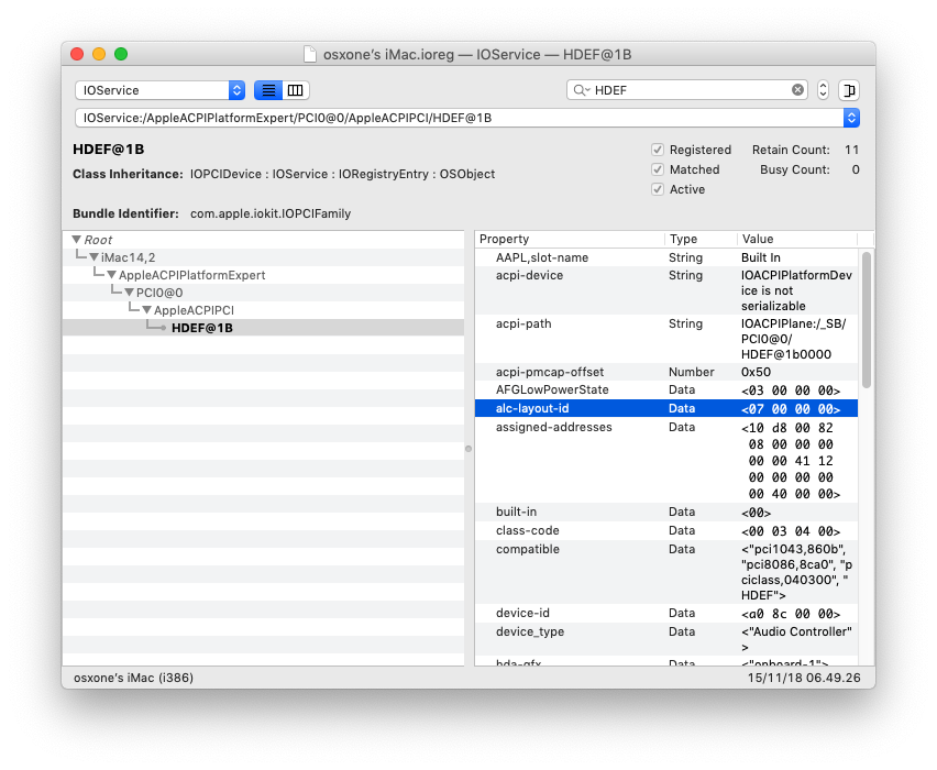

Andres ZeroCross Posted November 15, 2018 Share Posted November 15, 2018 As you can see,, your alc-layout-id = 7 and layout-id=7 Why did you say that you used layout-id=1???? where is the number 1???? Link to comment Share on other sites More sharing options...
fuzzylogic Posted November 15, 2018 Author Share Posted November 15, 2018 Thought you was going to offer a solution, since you question where is the layout id number it is in clover see below, I would however appreciate a possible answer, if you cannot provide an answer I will ask Mirone, who put the dst.aml and files together for me. Link to comment Share on other sites More sharing options...
Andres ZeroCross Posted November 15, 2018 Share Posted November 15, 2018 Thought you was going to offer a solution, since you question where is the layout id number it is in clover see below, I would however appreciate a possible answer, if you cannot provide an answer I will ask Mirone, who put the dst.aml and files together for me.So you don't know how to make audio working. Did you really know how to set layout id with AppleALC.kext???You ioreg show alc-layout-id=7 and layoutid=7. You said you set layout-id=1. So, Did you understand?? You have wrong configuration, and must learn how to set alc-layout-id. If you ask mirone or toleda. Then you will get same answer. It's not about your clover or ssdt, all your configuration is shown in your Ioreg. Got it???Sent from my Mi Note 2 using Tapatalk Link to comment Share on other sites More sharing options...
Andres ZeroCross Posted November 15, 2018 Share Posted November 15, 2018 So you don't know how to make audio working. Did you really know how to set layout id with AppleALC.kext???You ioreg show alc-layout-id=7 and layoutid=7. You said you set layout-id=1. So, Did you understand?? You have wrong configuration, and must learn how to set alc-layout-id. If you ask mirone or toleda. Then you will get same answer. It's not about your clover or ssdt, all your configuration is shown in your Ioreg. Got it???Sent from my Mi Note 2 using TapatalkYou must provide Ioreg output with ioregistry explorer.app and upload your clover folder if you need for help. Not just useless txt output of ioreg.Sent from my Mi Note 2 using Tapatalk Link to comment Share on other sites More sharing options...

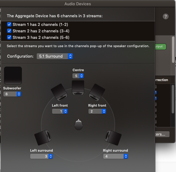

fuzzylogic Posted November 15, 2018 Author Share Posted November 15, 2018 At sixty years of age I dont think I am doing too bad, I have sound and its great out of four chanels, in the diagram below 3 and 4 are the only ones not working osxone’s iMac.ioreg Link to comment Share on other sites More sharing options...
Andres ZeroCross Posted November 16, 2018 Share Posted November 16, 2018 9 hours ago, osxone said: At sixty years of age I dont think I am doing too bad, I have sound and its great out of four chanels, in the diagram below 3 and 4 are the only ones not working osxone’s iMac.ioreg Why you still persist??? Did you see???? your alc-layout-id=7. Just try change it to 1 or another layout. just make configuration for HDEF from SSDT for better result Link to comment Share on other sites More sharing options...

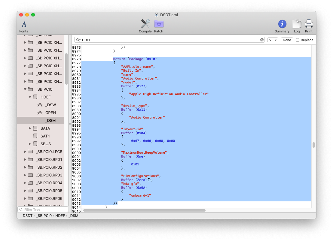

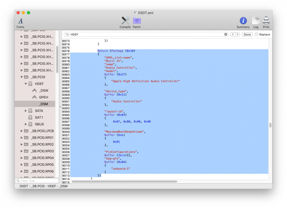

fuzzylogic Posted November 18, 2018 Author Share Posted November 18, 2018 patched.zip Link to comment Share on other sites More sharing options...
Andres ZeroCross Posted November 18, 2018 Share Posted November 18, 2018 (edited) 6 minutes ago, osxone said: patched.zip Then this is your problem,,, there is _DSM method in HDEF Device You must change Return (Package (0x10) { "AAPL,slot-name", "Built In", "name", "Audio Controller", "model", Buffer (0x27) { "Apple High Definition Audio Controller" }, "device_type", Buffer (0x11) { "Audio Controller" }, "layout-id", Buffer (0x04) { 0x07, 0x00, 0x00, 0x00 }, "MaximumBootBeepVolume", Buffer (One) { 0x01 }, "PinConfigurations", Buffer (Zero){}, "hda-gfx", Buffer (0x0A) { "onboard-1" } }) to Return (Package (0x12) { "AAPL,slot-name", "Built In", "name", "Audio Controller", "model", Buffer (0x27) { "Apple High Definition Audio Controller" }, "device_type", Buffer (0x11) { "Audio Controller" }, "alc-layout-id", Buffer (0x04) { 0x5c, 0x00, 0x00, 0x00 }, "layout-id", Buffer (0x04) { 0x07, 0x00, 0x00, 0x00 }, "MaximumBootBeepVolume", Buffer (One) { 0x01 }, "PinConfigurations", Buffer (Zero){}, "hda-gfx", Buffer (0x0A) { "onboard-1" } }) Don't forget to say thanks again Edited November 18, 2018 by Andres ZeroCross Link to comment Share on other sites More sharing options...
