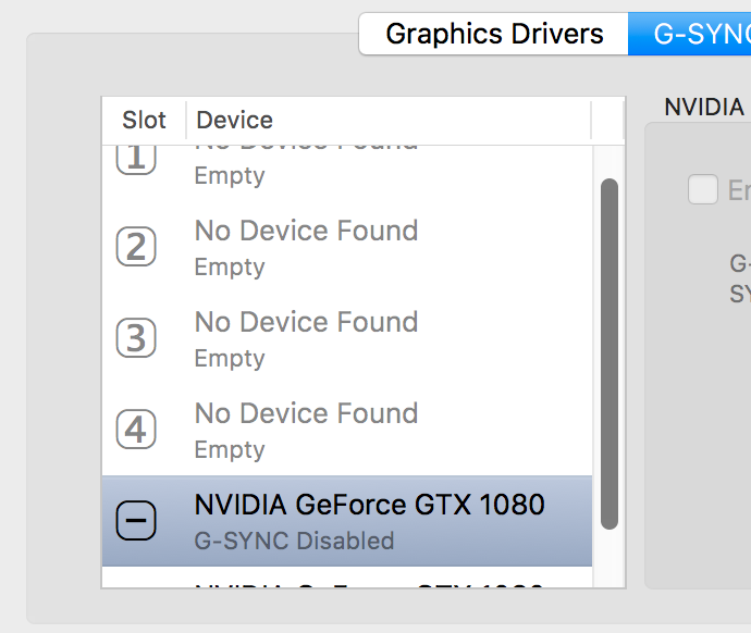

sebtech Posted November 5, 2018 Author Share Posted November 5, 2018 I found the solution myself. It came from the setting "Above 4G Decoding". When enabled, macOS won't boot correctly with 2 Nvidia GPUs.When I turned it off, it boots quickly and my 2 cards are seen by the system with webdrivers. Anybody got an explication ? Link to comment https://www.insanelymac.com/forum/topic/336338-need-help-with-10136-su-and-gtx-1080/#findComment-2645581 Share on other sites More sharing options...
