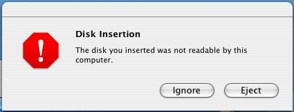

warped1 Posted November 19, 2006 Share Posted November 19, 2006 Okay, 10.4.8 amd machine. If I put the DVD Rom (Pioneer DVR-108) on the same IDE chain as the hard drive (master slave), the drive is slower (expected) and I get diskarb errors booting that delay it. Once its booted everything is fine and I can burn. Hard drive Master and DVD Secondary Master boots killer fast. Diskarbs are gone BUT my DVD no longer works. It's detected but can't recongnize disks. see pic. Any Ideas? Link to comment https://www.insanelymac.com/forum/topic/33623-crazy-diskarb-dvd-drive-thing/ Share on other sites More sharing options...

warped1 Posted November 19, 2006 Author Share Posted November 19, 2006 SOLUTION: Different IDE cable! I tried muliple IDE cables before, all of which worked in Windows and OSX when the second drive was attached but after my last test just didn't make sense. I tried another cable and it works flawless now. I am a very happy camper. Link to comment https://www.insanelymac.com/forum/topic/33623-crazy-diskarb-dvd-drive-thing/#findComment-237841 Share on other sites More sharing options...
