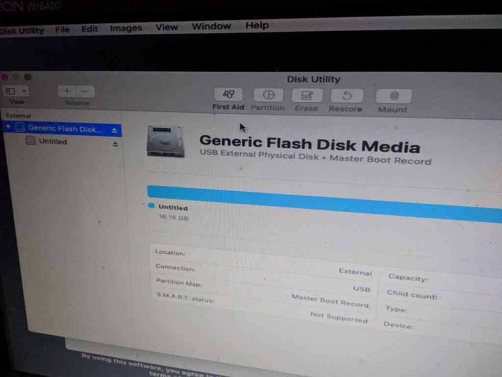

robif2002 Posted October 10, 2018 Share Posted October 10, 2018 Help, I'm wanna try to install newer version of macOS on my old PC, then i'm download mojave from AppStore then create bootable using mojave patcher program from dosdude and clover then. After succsesfull booting from USB then open disk utility hard drive not showing/detect on there and when os install also (only flashdisk installer showing), before i'm tried make bootable previous version macos and this same problem :'( also But i'm not faced this problem on installer from distro hackintosh zone in Yosemite-Sierra Now i'm using Sierra zone for while.... please anyone explain how to fix this. my PC specification : Intel Core 2 duo e8500 Asus p5k nVidia 9500gt thanks, Link to comment https://www.insanelymac.com/forum/topic/335911-cant-detect-hard-drive-internal-on-mac-os-mojave/ Share on other sites More sharing options...

robif2002 Posted October 11, 2018 Author Share Posted October 11, 2018 solved, upadate bios then i have ahci option Link to comment https://www.insanelymac.com/forum/topic/335911-cant-detect-hard-drive-internal-on-mac-os-mojave/#findComment-2640255 Share on other sites More sharing options...
