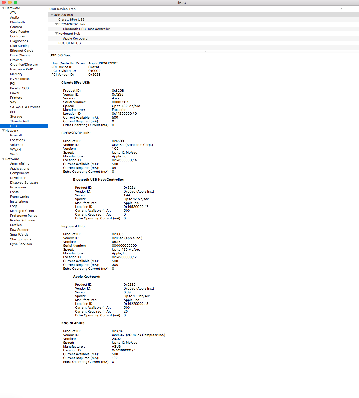

Haive_Music Posted September 15, 2018 Share Posted September 15, 2018 (edited) Hey Guys,I'm battling my last remaining issue on my Hackintosh build, and it's a puzzling one. I've suspected there's still something just 'not quite right' with my USB for a while now, but I haven't really been able to pinpoint anything specifically, other than having a hunch, ... until now. This issue seems to happen when working with audio. It doesn't happen non-stop, but frequently enough that it's annoying. Basically what happens is occasionally, and seemingly randomly, audio just drops out for 1ms, then comes back.I can't seem to find a correlation of what causes the issue. I've tried different sample rates, as well as different USB Audio Interfaces. Onboard audio is completely disabled, and BIOS is upgraded to the latest firmware. Searching around, I've found a lot of issues related to people running into similar issues with on-board audio, but found nothing helpful or relevant specifically to USB audio interface problems (AppleUSBAudioDevice), except for one guy who had his graphics card installed in the incorrect slot (I don't). I finally managed to capture some logs of this and have attached them below, along with a copy of my Clover config in case it's applicable. I'm nearly about ready to try another motherboard, but.... I'd really hard to do that if it won't resolve the issue, especially since everything else seems to be working finally. Thanks for any help anyone can offer. error 23:35:13.794035 -0400 coreaudiod HALS_IOA1Engine.cpp:312:EndReading: HALS_IOA1Engine::EndReading: got an error from the kernel trap, Error: 0xE00002D7 default 23:35:13.794254 -0400 Live HALC_ProxyIOContext.cpp:1068:IOWorkLoop: HALC_ProxyIOContext::IOWorkLoop: skipping cycle due to overload default 23:35:13.870976 -0400 coreaudiod HALS_OverloadMessage.cpp:159:perform: Audio IO Overload inputs: 'AppleUSBAudioEngine:Focusrite:Clarett 8Pre USB:567:1,2' outputs: 'AppleUSBAudioEngine:Focusrite:Clarett 8Pre USB:567:1,2' cause: 'Unknown' prewarming: no recovering: no default 23:35:13.920695 -0400 kernel USB Sound assertion (Resetting engine due to immediate error on read) in /BuildRoot/Library/Caches/com.apple.xbs/Sources/AppleUSBAudio/AppleUSBAudio-312.6/AppleUSBAudioDevice.cpp at line 6199 default 23:35:14.048899 -0400 kernel USB Sound assertion (Input Fell Behind) in /BuildRoot/Library/Caches/com.apple.xbs/Sources/AppleUSBAudio/AppleUSBAudio-312.6/AppleUSBAudioDevice.cpp at line 6185 config.plist Edited September 15, 2018 by Haive_Music Link to comment https://www.insanelymac.com/forum/topic/335536-usb-overload-dropouts-usb-sound-assertion-overload-kernel-errror-appleusbaudiodevice/ Share on other sites More sharing options...

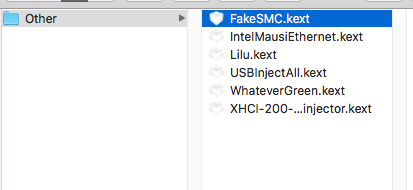

tkddkt Posted March 28, 2019 Share Posted March 28, 2019 How about using 10.9.5 AppleUSBAudio.kext ? Link to comment https://www.insanelymac.com/forum/topic/335536-usb-overload-dropouts-usb-sound-assertion-overload-kernel-errror-appleusbaudiodevice/#findComment-2668247 Share on other sites More sharing options...
Haive_Music Posted April 1, 2019 Author Share Posted April 1, 2019 On 3/28/2019 at 12:21 AM, tkddkt said: How about using 10.9.5 AppleUSBAudio.kext ? Interesting idea. I haven't tried this yet and just did. Initial results are mixed. It seems that it resolves the audio dropout error issue I was having. However, it's introduced a side effect in doing so. I personally don't notice this issue much anymore after switching to the Thunderbolt Interface, the issue is that it still affects other aspects of the audio sub system. For instance, if I stream to Twitch using OBS, even though I'm hearing stutter-free audio, the audio feed sent out to Twitch is now (instead of doing random drop outs), it's almost like it records and streams cleanly for 2-3 seconds, and then it starts almost looping/delaying back into it self "click click click click click" and the clicking noises progressively get faster and louder as time goes on. It's like a backfeed or something. It's interesting. The problem itself seems directly related to the USB Audio subsystem of OSX. It's really annoying. Link to comment https://www.insanelymac.com/forum/topic/335536-usb-overload-dropouts-usb-sound-assertion-overload-kernel-errror-appleusbaudiodevice/#findComment-2668720 Share on other sites More sharing options...
Haive_Music Posted April 1, 2019 Author Share Posted April 1, 2019 Today I ended up re-enabling my front case ports (USB 2.0 ones) and trying to use those with the original version of the AppleUSB kext. Problem definitely seems improved, and I can utilize the USB input. For some reason, the problem seems to revolve around using the USB 3.0 ports on the board. Link to comment https://www.insanelymac.com/forum/topic/335536-usb-overload-dropouts-usb-sound-assertion-overload-kernel-errror-appleusbaudiodevice/#findComment-2668787 Share on other sites More sharing options...
