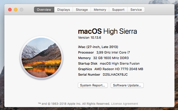

El Capitan Posted July 23, 2018 Share Posted July 23, 2018 (edited) I have an AMD FirePro W4100 2GB fully functioning (resume from sleep, HDMI audio, all ports working) under High Sierra 10.13.6 There is only one problem: the Cinebench 3D OpenGL benchmark is only 15 frames per second (fps). If I reboot my computer into Windows 10 then run the Cinebench 3D OpenGL benchmark the result is 55 fps. Now, if I REBOOT (with out turning off the power) into High Sierra then re-run Cinebench 3D OpenGL benchmark the result is 44 fps. It is obvious that the windows 10 Cinebench 3D OpenGL benchmark is initialising the W4100. Does anyone have any ideas how to create the Windows initialising action under High Sierra? In order to get the W4100 to work under High Sierra 10.13.6, I patched the Futomaki framebuffer to be consistent with the W4100, set CAIL_DisableGfxCGPowerGating to 1 - in the respective kext, and injected a graphics ID of 0x683d1002. Edit: It is not necessary to run Cinebench 3D OpenGL benchmark under Windows 10 to initialise the W4100: just booting to Windows 10 and then re-booting to High Sierra results in a high Cinebench 3D OpenGL benchmark score. If the computer is put to sleep and then resumed the Cinebench 3D OpenGL benchmark drops back to 15 fps. Edited July 23, 2018 by El Capitan clarification Link to comment Share on other sites More sharing options...
