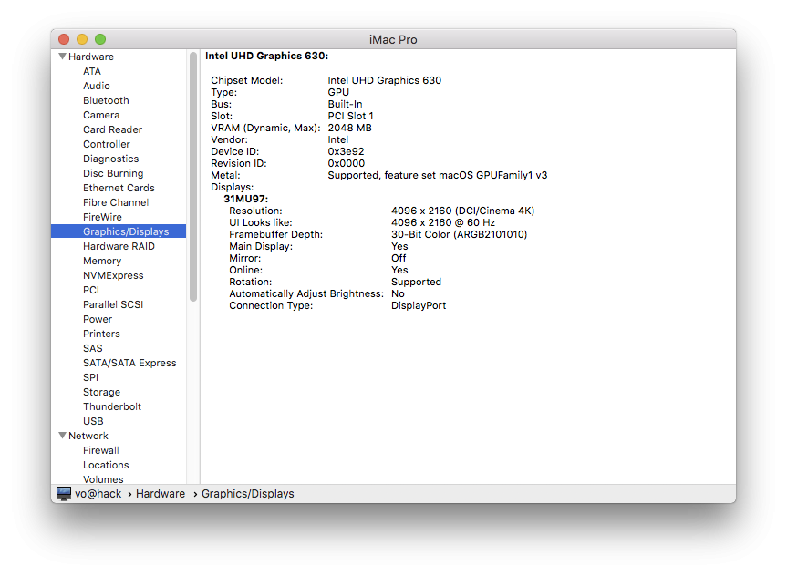

v.osypets Posted July 23, 2018 Author Share Posted July 23, 2018 (edited) 4 hours ago, millusions said: There's a lot of google results with Dell monitors not waking up, so I blame Dell... specially the horror 32 inch - it's a nightmare screen - so many issues since day 1. but if you find a fix please share btw. do you get 4k at 60Hz on your LG? is it MST screen? At this time it's works with 3840 x 2160 x 30bit @ 60 Hz. It's SST monitor. But it's not a native resolution for that monitor. Native res is - 4096 x 2160, but I can't run it with this resolution. Seems MacOS not supported it with Intel UHD 630. Edited July 23, 2018 by v.osypets Link to comment https://www.insanelymac.com/forum/topic/334926-solved-lg-31mu97z-b-monitor-sometimes-sleeping-after-system-wake/#findComment-2627116 Share on other sites More sharing options...
v.osypets Posted July 23, 2018 Author Share Posted July 23, 2018 8 hours ago, millusions said: nice! on Intel 630? far out, thats great result. I can't get 4k 60hz on GTX780ti, have tried other cards as well. It's works for me without any fixes. 8 hours ago, millusions said: try SwitchResX . I'm tried today, but can't create custom 4096 x 2160 resolution. 8 hours ago, millusions said: mine wouldn't even do 2k 60Hz without that. I'm not sure it will work for you but I fiddled with this a lot an no install would give me 2k at 60Hz without SwitchResX on this 32 inch MST screen (have tried all OS versions and all possible Did you tried this patch? Maybe it's help in your case - https://github.com/Floris497/mac-pixel-clock-patch-V2 Link to comment https://www.insanelymac.com/forum/topic/334926-solved-lg-31mu97z-b-monitor-sometimes-sleeping-after-system-wake/#findComment-2627189 Share on other sites More sharing options...
v.osypets Posted August 2, 2018 Author Share Posted August 2, 2018 (edited) On 7/24/2018 at 12:56 AM, millusions said: thanks. i have tried that patch, a while ago, i cant remember exactly but it didnt work for me, but maybe it will work, from memory i was on 10.11 when i tried it. so thanks, thats a great idea. 4k works perfectly without fuss in windows. With latest Mac OS special update 10.13.6 (17G2112) and Whatevergreen.kext I have support for CoffeLake video and native resolution (4096 x 2160 @ 60 Hz) on my monitor, but problem with sleeping still persist. Edited August 2, 2018 by v.osypets Link to comment https://www.insanelymac.com/forum/topic/334926-solved-lg-31mu97z-b-monitor-sometimes-sleeping-after-system-wake/#findComment-2628560 Share on other sites More sharing options...

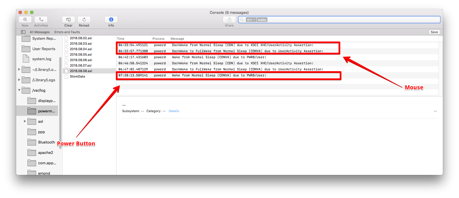

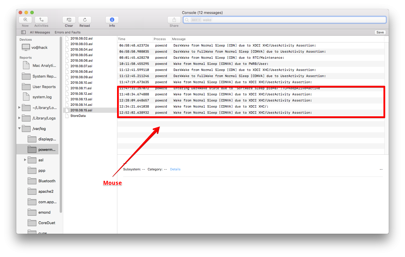

v.osypets Posted August 8, 2018 Author Share Posted August 8, 2018 I think it's not monitor problem. If I push button on mouse my PC wakes in two stages (please see screenshot) - DarkWare from Normal Sleep and after DarkWake to FullWake from normal sleep. If I pushing power button on case we have wake in one stage - Wake from Normal Sleep. Is there possible to program wake with mouse and keyboard same as with power button? Link to comment https://www.insanelymac.com/forum/topic/334926-solved-lg-31mu97z-b-monitor-sometimes-sleeping-after-system-wake/#findComment-2629305 Share on other sites More sharing options...
