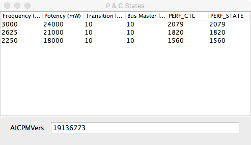

...well, I've been dsdt diving...lol, and have a semi-working dsdt22.aml....the result however leaves me with higher than normal temps for cpu cores and heatsink and no AICPMvers in ioreg....I'm including one: dsdt.aml that does give me AICPM...and two: the dsdt22.aml that I want to use...but does not activate AICPM...dsdt22 needs the fix....
...a little guidance please...

edit: found my solution....moved scope, P001,P002,P003,P004 from dsdt to dsdt22, replacing existing... compiled and loaded up  :trumpet: ... now for onboard sound, as hdmi audio already works thru gfx card... :smoke:
...all this on Box 2 (P5N7A-VM)

hey Herve' ...my initial reason for the dsdt mucking was to get my chipset identified as MCP79(Nvidia) and not generic...in doing so, I lost AICPM support and temps increased on average 15 degrees C....around 51 -57 degrees C at idle....after this fix, temps are high 20s at idle and mid 50s under full load...and chipset is recognized.....so yes, I can run Box2 without dsdt edit...still, ...this board was a royal pain...mostly from outdated info circa 2009...but it just works!!
...thanks for the reply
edit: removed this bold  text reference too from clover..just p and c state generation now
.clover does a drop cpupm table in ssdt  to avoid a kp at boot...and generates p and c states and enables c6
