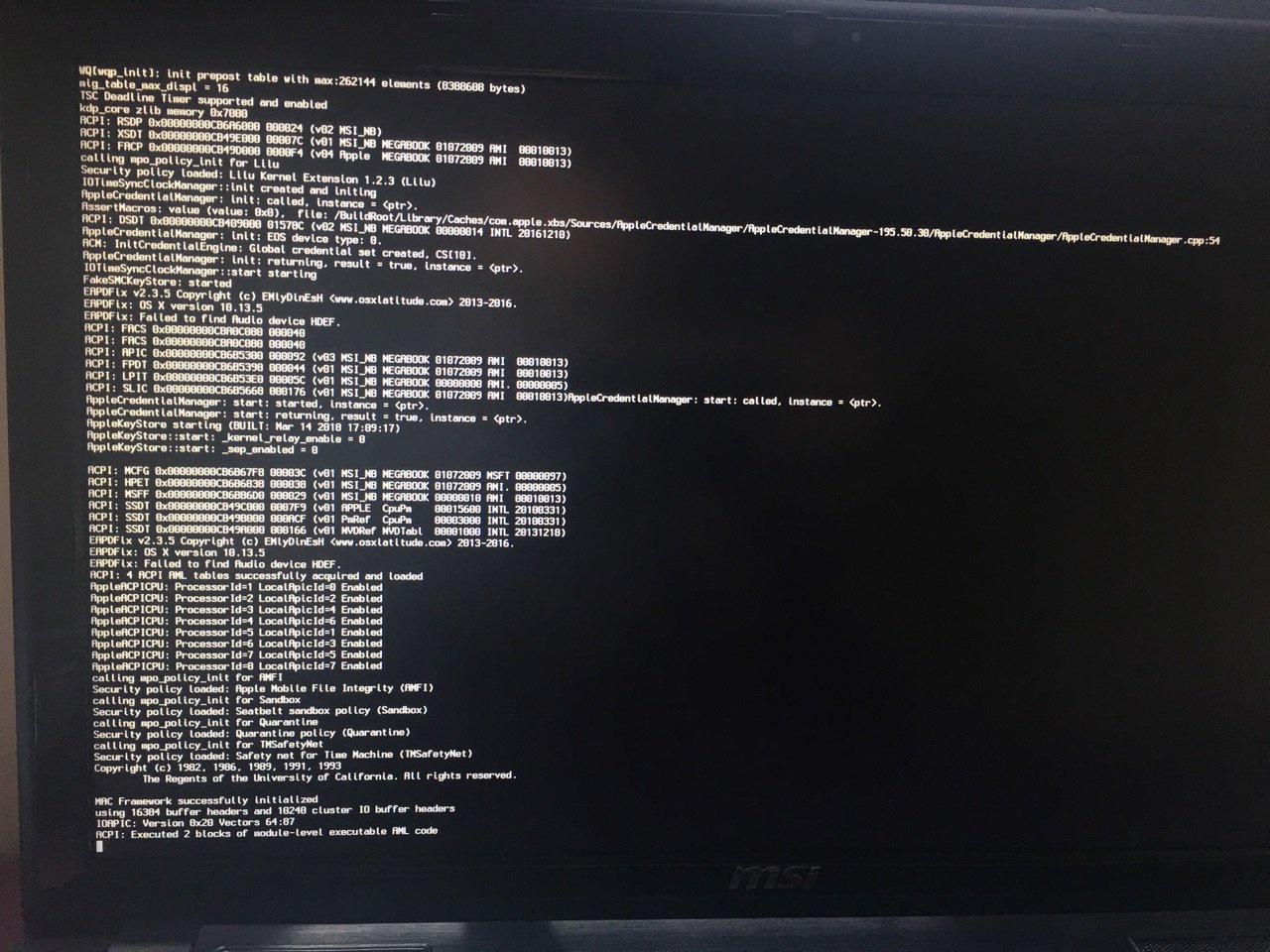

Komar aka Kali Posted May 13, 2018 Share Posted May 13, 2018 (edited) Hi my friends... I have a problem to patch my DSDT&SSDT in High Sierra. I have compiled my DSDT&SSDT to patch nVidia off by two methods... Only by DSDT and an other by DSDT&SSDT. In Yosemite two methods work fine, but in High Sierra, two methods stop my boot in like point. Can any one help me with this issue...? Thanks in advanced... PD. I add my files DSDT&SSDT nVidia patch by DSDT, DSDT&SSDT nVidia patch by SSDT and config plist file from Clover EFI. Add a picture from stop point in High Sierra boot too. Files.zip Edited May 13, 2018 by kali2000 Orthography Link to comment https://www.insanelymac.com/forum/topic/334078-dsdtssdt-high-sierra/ Share on other sites More sharing options...

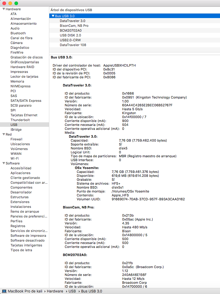

Komar aka Kali Posted May 13, 2018 Author Share Posted May 13, 2018 (edited) 41 minutes ago, MaLd0n said: DSDT.aml.zip use change EHC1 to EH01 45484331 45483031 change EHC2 to EH02 45484332 45483032 change GFX0 to IGPU 47465830 49475055 change HECI to IMEI 48454349 494d4549 Ok... now can boot High Sierra and nVidia off patch work, but I haven't audio and my USB tree is not right. https://mega.nz/#!HBMRHTRB!OAkOPAA9tXtuXUwC0JAYDaNVj3UXzSlZst-un0a8fFw When I connect any pen drive to any USB port I have this message... see picture... Edited May 13, 2018 by kali2000 Link to comment https://www.insanelymac.com/forum/topic/334078-dsdtssdt-high-sierra/#findComment-2613462 Share on other sites More sharing options...

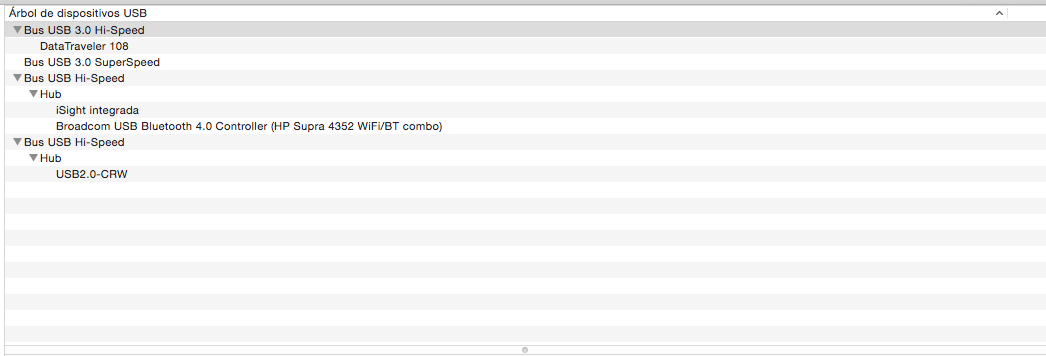

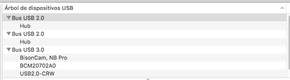

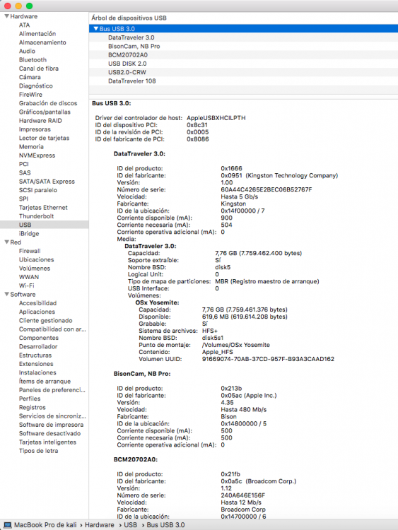

Komar aka Kali Posted May 14, 2018 Author Share Posted May 14, 2018 7 hours ago, MaLd0n said: test usb with this DSDT DSDT.aml.zip HDMI is just a config.plist config, need check USB port works, but the USB2 tree has disappeared. See pictures... First picture is with old DSDT from Yosemite. Second picture is with old DSDT from High Sierra. Third picture is with your last DSDT from High Sierra Link to comment https://www.insanelymac.com/forum/topic/334078-dsdtssdt-high-sierra/#findComment-2613511 Share on other sites More sharing options...
MaLd0n Posted May 14, 2018 Share Posted May 14, 2018 4 hours ago, kali2000 said: USB port works, but the USB2 tree has disappeared. See pictures... First picture is with old DSDT from Yosemite. Second picture is with old DSDT from High Sierra. Third picture is with your last DSDT from High Sierra the correct is all ports work inside USB3 BUS, test all ports with device USB 3 and let me know if work Link to comment https://www.insanelymac.com/forum/topic/334078-dsdtssdt-high-sierra/#findComment-2613531 Share on other sites More sharing options...
Komar aka Kali Posted May 14, 2018 Author Share Posted May 14, 2018 16 minutes ago, MaLd0n said: the correct is all ports work inside USB3 BUS, test all ports with device USB 3 and let me know if work Yes... All work fine... Link to comment https://www.insanelymac.com/forum/topic/334078-dsdtssdt-high-sierra/#findComment-2613541 Share on other sites More sharing options...

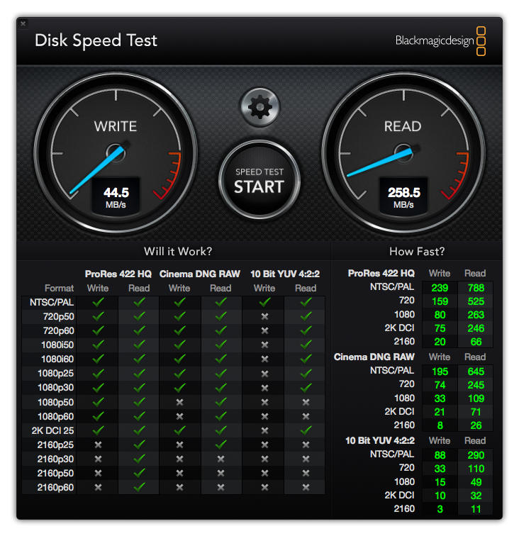

Komar aka Kali Posted June 13, 2018 Author Share Posted June 13, 2018 On 5/14/2018 at 3:11 AM, MaLd0n said: test usb with this DSDT DSDT.aml.zip HDMI is just a config.plist config, need check Hi again... after update to 10.13.5 I have issues in USB port related in this post... I solved my HDMI issue patching AIFAzul.kext. But I can't solve USB energy... Help me please... Link to comment https://www.insanelymac.com/forum/topic/334078-dsdtssdt-high-sierra/#findComment-2619279 Share on other sites More sharing options...
