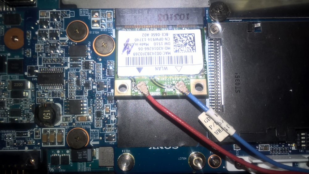

vrondena Posted March 30, 2018 Author Share Posted March 30, 2018 thanks for the support Hervè,now I'm going to try isolating pin20.now I have put back BCM94322 DW1510 . I'm waiting for the support half size to full size. I have a little doubt about cable colors if properly positioned. but also inverted does not change. no hardware wifi only bluetooth. Link to comment https://www.insanelymac.com/forum/topic/333489-qualcomm-gobi-2000-how-replace/#findComment-2606415 Share on other sites More sharing options...

vrondena Posted March 31, 2018 Author Share Posted March 31, 2018 finally resolved, the wlan card is in another position (under the wwan, you have to remove the base), inserted the brcm is recognized natively. now everything really works, spectacular grazie mille Hervè ps: now what do I do with vpsc13 I'm finished I have to take another pc, suggestions Link to comment https://www.insanelymac.com/forum/topic/333489-qualcomm-gobi-2000-how-replace/#findComment-2606634 Share on other sites More sharing options...
