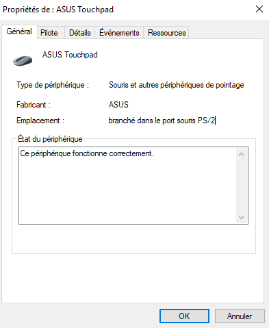

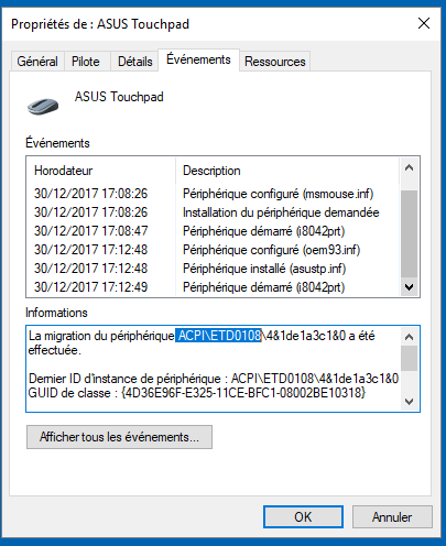

walidos89 Posted March 18, 2018 Author Share Posted March 18, 2018 Thank you for your reply i checked in windows the trackpad is : - Asus Touchpad PS/2 - ACPI ETD0108 The problem that in system preferences trackpad i see the trackpad options and the animations images but wen i touch nothing work The second problem i have the sound working but the mic d'ont work and on the input tab i have built-in speaker like input Thank you for help Link to comment Share on other sites More sharing options...
