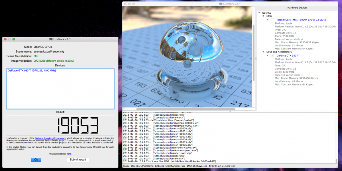

Luxmark test with one gtx and 2 monitors plugged in

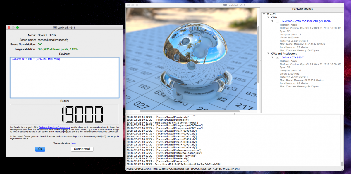

2nd gtx inserted an both monitors plugged in one gtx and UI works smooth and fine.
But, on LuxMark only one gtx is readable, check screenshot.

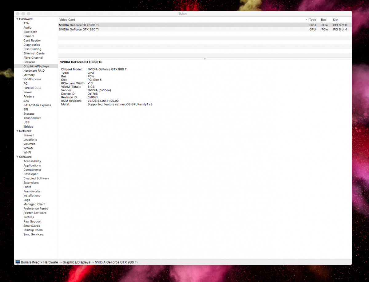

and on system report there is 2 gtx installed ?

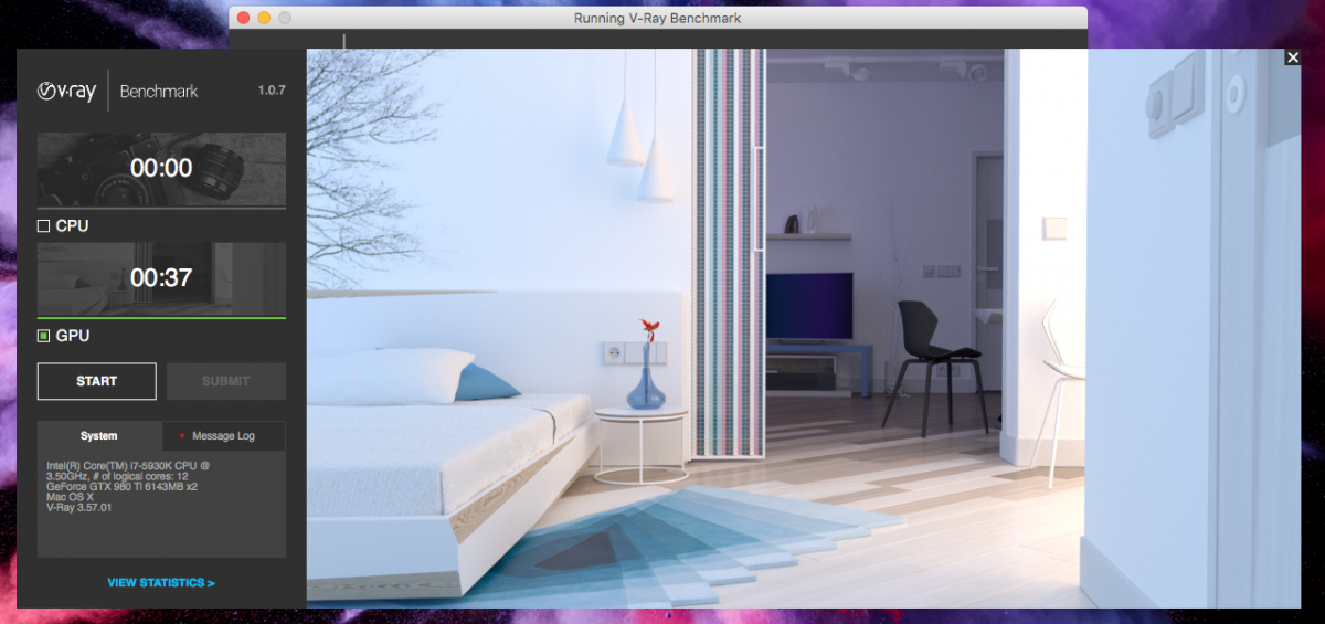

on Vray benchmark it reads 2 gtx and running fine it seams.
