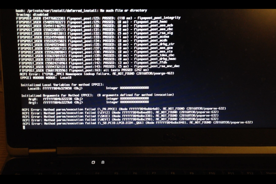

Trung_Nguyen Posted February 1, 2018 Share Posted February 1, 2018 Hello everyone, I'm getting these error at verbose boot, It waits at this line a little bit long. I think it's a DSDT error: Here is my DSDT:DSDT.zip Could someone help me fix this? Thank you all!. Link to comment https://www.insanelymac.com/forum/topic/332227-acpi-error-slow-boot-down/ Share on other sites More sharing options...
MaLd0n Posted February 1, 2018 Share Posted February 1, 2018 DSDT.aml.zip use patch ECDV to EC change ECDV to EC 45434456 45435f5f 1 Link to comment https://www.insanelymac.com/forum/topic/332227-acpi-error-slow-boot-down/#findComment-2582000 Share on other sites More sharing options...
Trung_Nguyen Posted February 1, 2018 Author Share Posted February 1, 2018 DSDT.aml.zip use patch ECDV to EC change ECDV to EC 45434456 45435f5f Things got worse, unsolved, got more message like that, at [^CPU0.PPC] Link to comment https://www.insanelymac.com/forum/topic/332227-acpi-error-slow-boot-down/#findComment-2582015 Share on other sites More sharing options...
