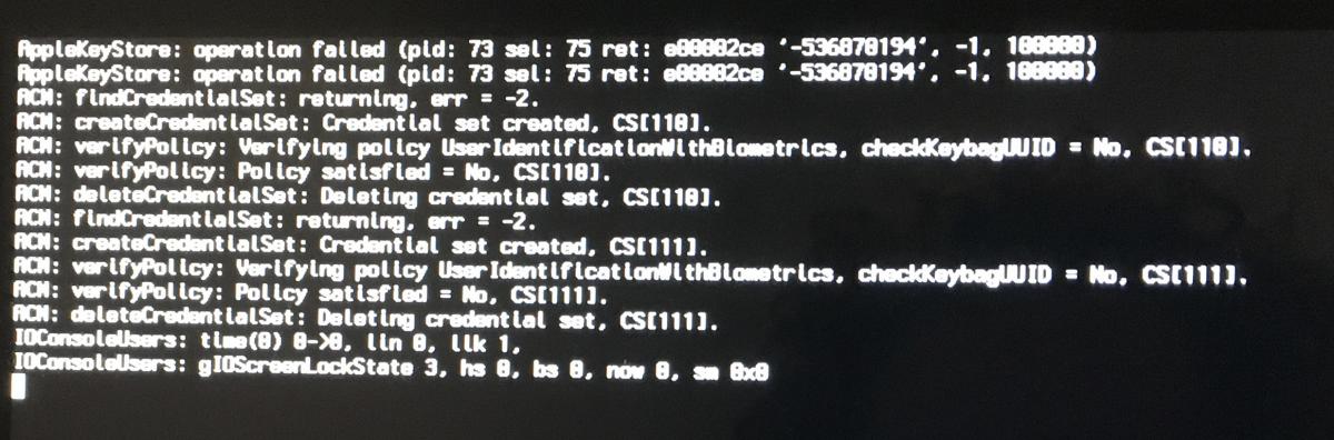

r!ppz Posted January 17, 2018 Share Posted January 17, 2018 My Hack is working fine with apple nvidia driver for the GTX 660Ti. I wanted to try the webdriver for possible performance gains in games. I have macOS High Sierra Build 17C205 and installed the matching driver with Nvidia Web Driver Updater 1.5. When I boot with the driver activated it loads up until some point where it shows a spinner like the one when you shutdown. When I boot in verbose mode it says: AppleKeyStore: operation failed It prints it out together with some other information (see screenshot) and then does it all over again forever. What could be the problem here? I have the newest clover and fakesmc from RehabMan installed. Link to comment https://www.insanelymac.com/forum/topic/331700-boot-stalls-with-gtx-660ti-and-webdriver/ Share on other sites More sharing options...
Guest Posted January 17, 2018 Share Posted January 17, 2018 My Hack is working fine with apple nvidia driver for the GTX 660Ti. I wanted to try the webdriver for possible performance gains in games. I have macOS High Sierra Build 17C205 and installed the matching driver with Nvidia Web Driver Updater 1.5. When I boot with the driver activated it loads up until some point where it shows a spinner like the one when you shutdown. When I boot in verbose mode it says: AppleKeyStore: operation failed It prints it out together with some other information (see screenshot) and then does it all over again forever. What could be the problem here? I have the newest clover and fakesmc from RehabMan installed. I have had that problem if I have SIP csractiveconfig set to 0X0 with 0x67 or 0x03 all is fine for me Also try to force with space bar in clover boot menu flag on nvda_drv=1 Link to comment https://www.insanelymac.com/forum/topic/331700-boot-stalls-with-gtx-660ti-and-webdriver/#findComment-2570713 Share on other sites More sharing options...
r!ppz Posted January 19, 2018 Author Share Posted January 19, 2018 You are right. When I set the csractiveconfig from 0x01 to 0x03 it does work. But I really don't want to disable file system protection. Why the hell does the driver require this. I guess there is some hardcoded check inside the driver to check one of the two supported csractiveconfig values are set (completely on or completely off). Braindead. Link to comment https://www.insanelymac.com/forum/topic/331700-boot-stalls-with-gtx-660ti-and-webdriver/#findComment-2572228 Share on other sites More sharing options...
