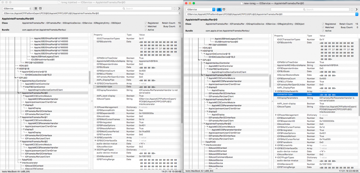

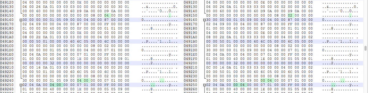

VanessaG Posted January 17, 2018 Author Share Posted January 17, 2018 Ok. Update. I edited the AppleIntelFramebufferAzul.kext but with "no" success The connector type in ioreg is changed from LVDS 0200 0000 to eDP 0400 0000. But also only external Monitor works. I attach the new IOREG and the edited hextables. I am grateful for every suggestion Update: OK. I belive the internal Display is AppleInternalFramebuffer@2 . But after changing this the same problem. connector-type 04000000. but nothing happens. new-ioreg.zip Link to comment https://www.insanelymac.com/forum/topic/331613-edp-on-samsung-ativ-9-plus-hd4400/#findComment-2571136 Share on other sites More sharing options...
