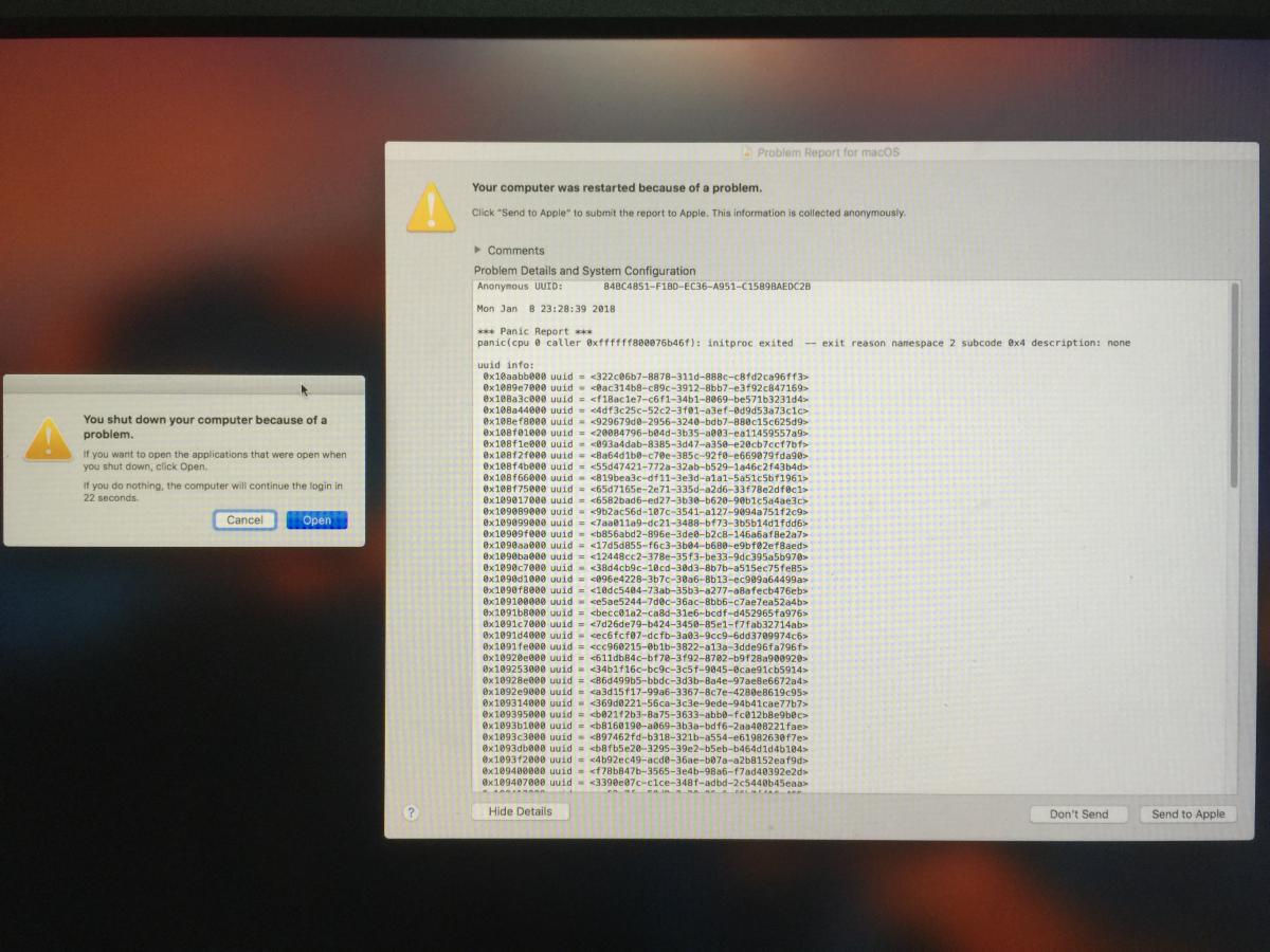

Marv. Posted January 8, 2018 Share Posted January 8, 2018 There are two message box appearing right after login. No sure what happened. Is it the fakeCPU ID not right? My CPU is G3220 (very old huh!), what's the right CPU ID should i use? My computer hardwares include: CPU G3220 ASUS B85M-E RAM 8G DDR3 1600 HDD Samsung 840EV SSD + 3 WD 2TB Graphics Nvida GTX1050 Audio ALC887 LAN RTL8168 + TP LINK wireless Link to comment https://www.insanelymac.com/forum/topic/331397-1012-sierra-error-messages-show-right-after-login/ Share on other sites More sharing options...

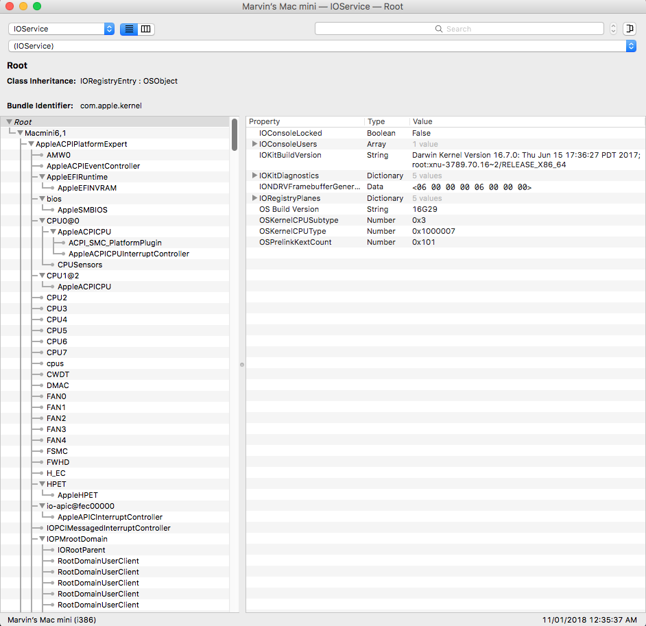

MaLd0n Posted January 8, 2018 Share Posted January 8, 2018 -Post your full Clover folder -Send me tables http://www.insanelymac.com/forum/index.php?app=core&module=attach§ion=attach&attach_id=278494 -Send me one Ioreg too http://www.insanelymac.com/forum/index.php?app=core&module=attach§ion=attach&attach_id=278495 Link to comment https://www.insanelymac.com/forum/topic/331397-1012-sierra-error-messages-show-right-after-login/#findComment-2564515 Share on other sites More sharing options...
Marv. Posted January 9, 2018 Author Share Posted January 9, 2018 Please see the attachments. Thanks a lot! -Post your full Clover folder -Send me tables http://www.insanelymac.com/forum/index.php?app=core&module=attach§ion=attach&attach_id=278494 -Send me one Ioreg too http://www.insanelymac.com/forum/index.php?app=core&module=attach§ion=attach&attach_id=278495 I guess I have been having problem uploading attachments....I just can't find the attachment I have uploaded. Can I send the files to you by email? If yes, please let me know your email address. Thanks very much! 1 Link to comment https://www.insanelymac.com/forum/topic/331397-1012-sierra-error-messages-show-right-after-login/#findComment-2565362 Share on other sites More sharing options...

Marv. Posted January 10, 2018 Author Share Posted January 10, 2018 Wow! I can now uploaded a attachment finally with VPN..... The capture shows the error message I have been seeing every time I restart or power on my PC. I can upload the information I got after running the two program you just sent above, since I have been out of office for work couple days. Thank you again! 1 Link to comment https://www.insanelymac.com/forum/topic/331397-1012-sierra-error-messages-show-right-after-login/#findComment-2565943 Share on other sites More sharing options...
Marv. Posted January 11, 2018 Author Share Posted January 11, 2018 -Post your full Clover folder -Send me tables http://www.insanelymac.com/forum/index.php?app=core&module=attach§ion=attach&attach_id=278494 -Send me one Ioreg too http://www.insanelymac.com/forum/index.php?app=core&module=attach§ion=attach&attach_id=278495 Done. Let me know if there anything more needed. Send me Marv’s Mac mini.zip Link to comment https://www.insanelymac.com/forum/topic/331397-1012-sierra-error-messages-show-right-after-login/#findComment-2566723 Share on other sites More sharing options...
MaLd0n Posted January 11, 2018 Share Posted January 11, 2018 check CLOVER.zip we try a full solution, full clover folder, just install a web driver, check if FakeCUPID is correct send me new ioreg with new files after reboot Link to comment https://www.insanelymac.com/forum/topic/331397-1012-sierra-error-messages-show-right-after-login/#findComment-2566735 Share on other sites More sharing options...
Marv. Posted January 11, 2018 Author Share Posted January 11, 2018 check CLOVER.zip we try a full solution, full clover folder, just install a web driver, check if FakeCUPID is correct send me new ioreg with new files after reboot Can't reboot successfully with this Clove folder. It stopped soon. I guess the config.plist doesn't work for my pc? I attached the screen shot and my own config.plist for your reference. Archive.zip Link to comment https://www.insanelymac.com/forum/topic/331397-1012-sierra-error-messages-show-right-after-login/#findComment-2566994 Share on other sites More sharing options...
MaLd0n Posted January 11, 2018 Share Posted January 11, 2018 the problem is a AICPUPM kext, native PM in old processors(last is SandyBridge) ur config.plist have a -xcpm, try add in mine, or use ur config.plist with my files, if dont solve, i remove plugtype=1 in DSDT Link to comment https://www.insanelymac.com/forum/topic/331397-1012-sierra-error-messages-show-right-after-login/#findComment-2567119 Share on other sites More sharing options...
