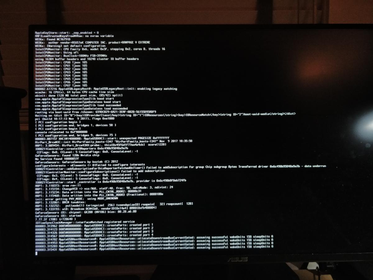

Hi guys, currently I have El Capitan booting of an External WD HDD, and I'm trying to fresh install High Sierra on a Samsung T3 external SSD. However, when I try and boot into the High Sierra installer I get a permissions error! Here are the steps I used to make my High Sierra installer USB drive:
--ran "sudo /Applications/Install\ macOS\ Sierra.app/Contents/Resources/createinstallmedia --volume /Volumes/Installer --applicationpath /Applications/Install\ macOS\ Sierra.app --no interaction"
--ran a fresh install of Clover with "Install for UEFI booting only," "Install Clover in the ESP," only checked "CsmVideoDxe-64.efi" under "Drivers64UEFI," and "Install RC scripts on target volume"
--Used a prebuilt EFI, and added the Haswell-E patches and modified the VoodooTSCSync.kext to 15 for my CPU (EFI.zip is >10MB so here's a drive link): https://drive.google.com/file/d/1f22p2F7kYaJgSRy659g8FBLSdD9xyjOH/view?usp=sharing
--Used the BIOS settings found in the Archive.zip attached, and also did CodeRush's UEFI BIOS patch and flashed using the ASUS BIOS flashback
--Used the files found here (http://www.insanelymac.com/forum/topic/330598-solution-does-printf-work-freeze-with-osxaptiov2/?p=2553095) to break through the "does printf work??" error

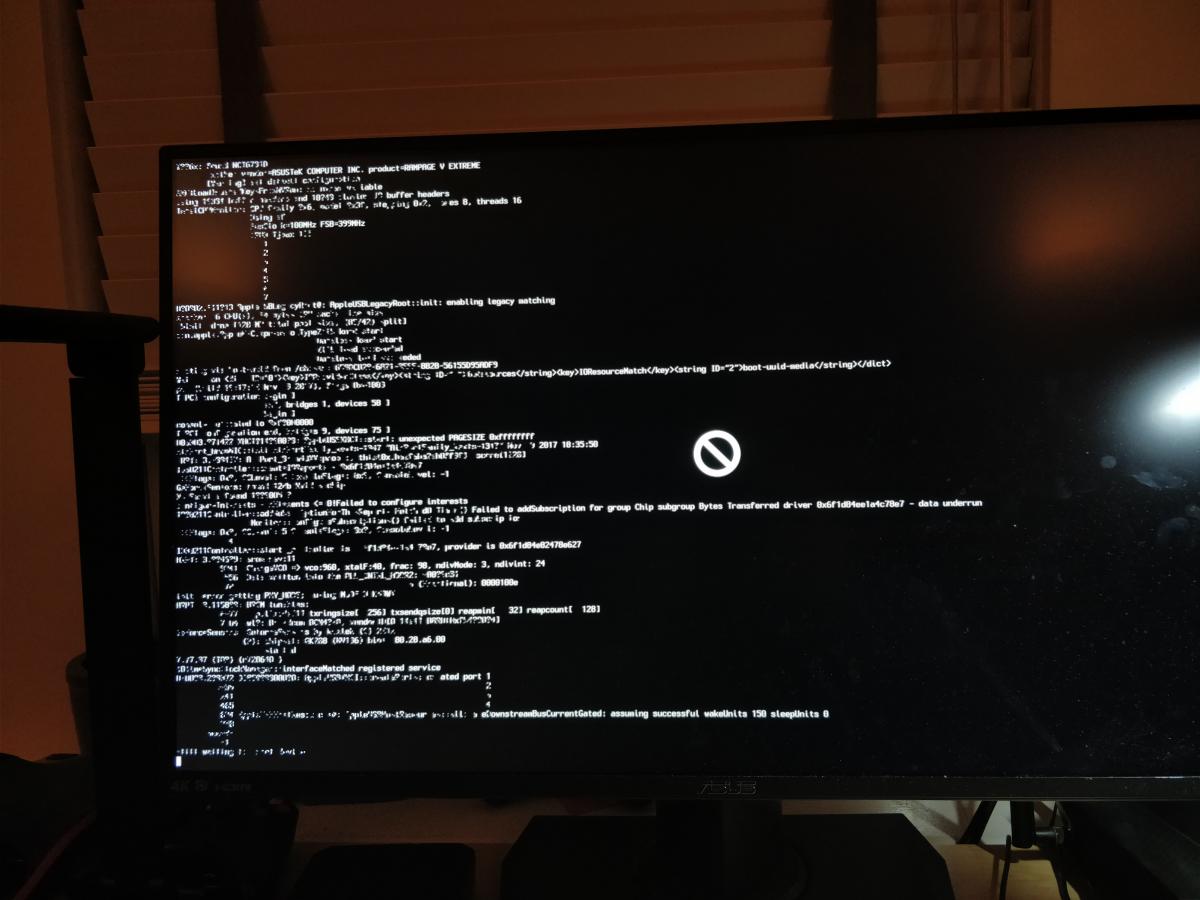

Getting this error (first attached screenshot), which was followed by a permissions error (second attached screenshot), when I try and boot into the High Sierra installer.
PLEASE can someone help? Thanks! :D

Whoops, forgot a few things in the OP, updated now. Is the MRS 0xE2 writeable the CodeRush UEFI Patch? If so, I've done that. CSM is disabled now too. I also have 2x Titan X (Maxwell) in my rig, but for now I have them unplugged. I bought a GT710 off Amazon because I heard they were supported by High Sierra natively and didn't need any additional patches. I'm booting off the GT710 for now, and I'm still getting errors.

Did you look at the config.plist in the EFI I posted? The Brumbaer patch is already there...
