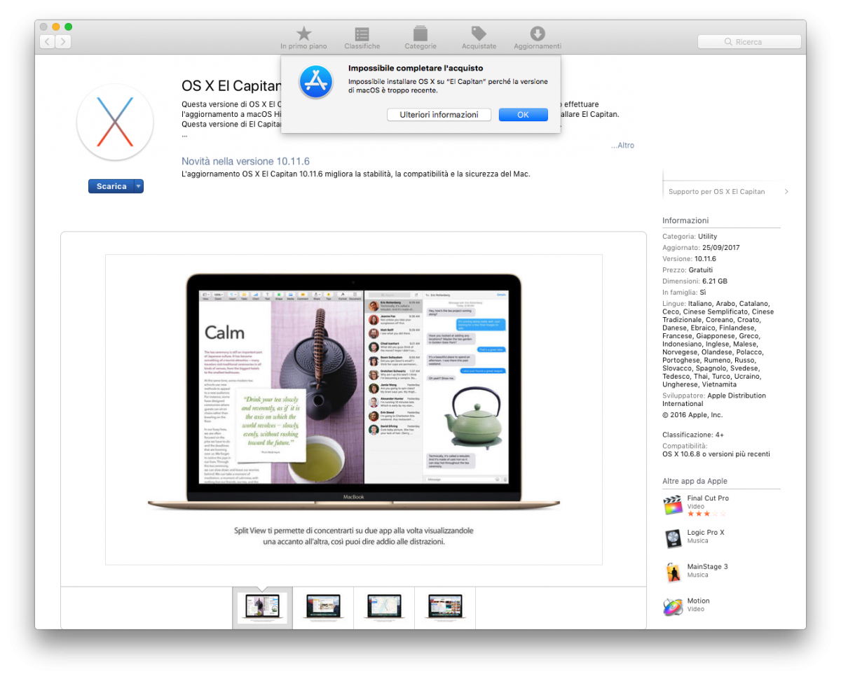

EdoardoConti Posted November 6, 2017 Author Share Posted November 6, 2017 (edited) On paper, you should theoretically be able to install OS X on that platform, yes. Anything from Snow Leopard 10.6 to El Capitan 10.11. Sierra and above require a CPU with SSE4 instructions set, something this 10yr-old Kentsfield model does not possess. http://www.cpu-world.com/CPUs/Xeon/Intel-Xeon%20X3210%20-%20HH80562QH0468M%20(BX80562X3210).html Got it. There would be no support for the integrated graphics of the Q45 chipset which should be GMA 4500 family, so a supported PCIe x16 graphics card would indeed be necessary. Your nVidia GT710 normally works OOB with El Capitan. I don't know about support in earlier OS X versions but it's a fairly recent card that replaced the GT610 and the GT610 was only supported from Lion 10.7.5 and Mountain Lion 10.8.3 onwards. I'm going to use the gt710 on macOS 10.11 If i try to download El Capitan from App Store I get this message. It means that i've already the recent version of macOS ( 10.13.1 ) . How can I download it? Edited November 6, 2017 by EdoardoConti Link to comment https://www.insanelymac.com/forum/topic/329384-intel-dq45cb-and-xeon/#findComment-2530117 Share on other sites More sharing options...
