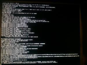

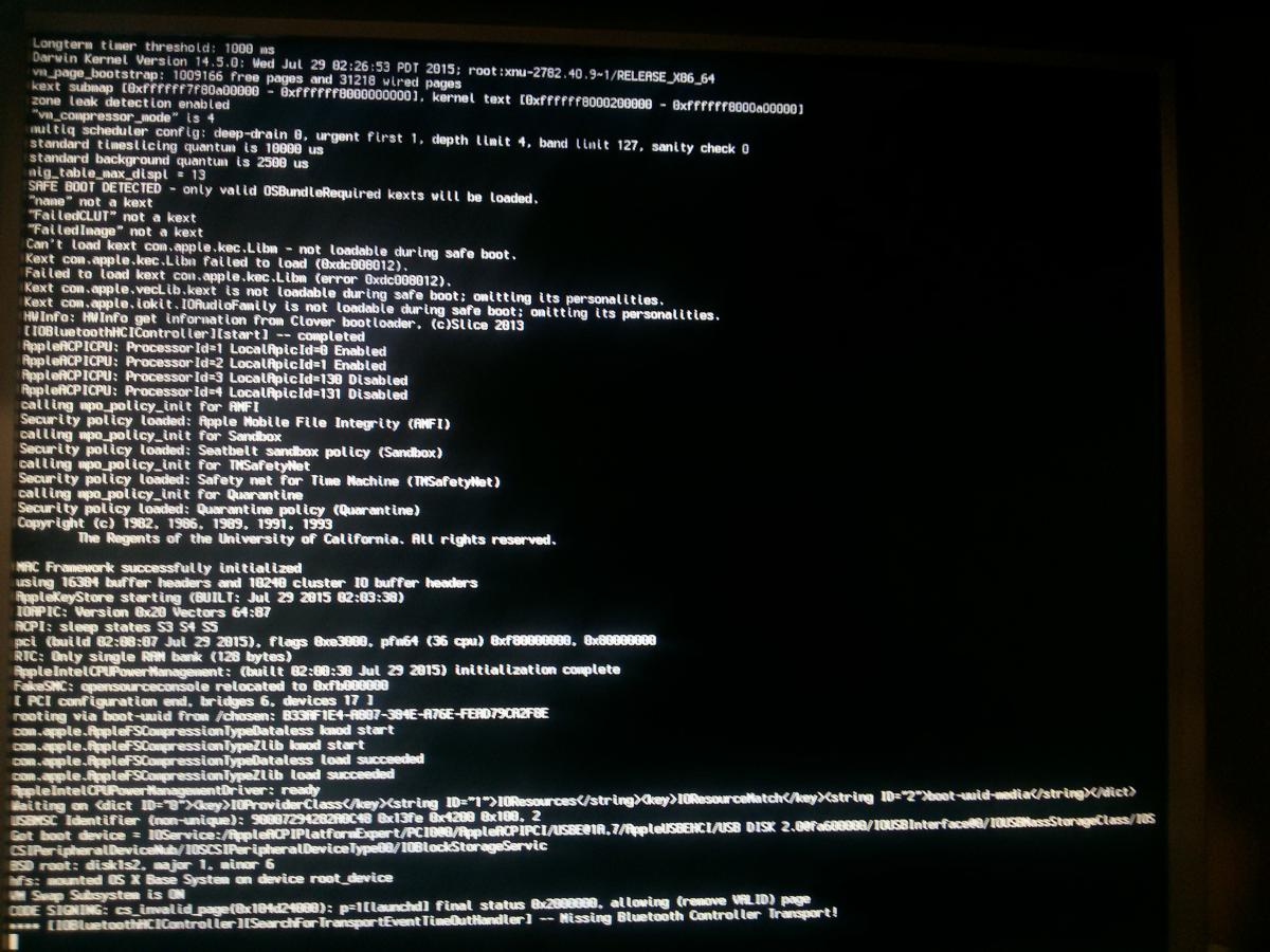

SPokets Posted September 21, 2017 Share Posted September 21, 2017 Hi all. At starting the installer from the USB flash drive, the download stops on the Missing Bluetooth Controller Transport line. As no line "DSMOS has arrived", so I think, that FakeSMC doesn't start. I tried to change versions of the Clover, others FakeSMC, put them in the folder 10.10 and in the Other. What can help? Thank you. My hardware: Boot flash drive via BDU P5K-SE EPU Core 2 Duo 7200 Nv gt9600 4gb ram. On the mother patched bios, Ahci on NvidiaInject on Link to comment https://www.insanelymac.com/forum/topic/327374-fakesmc-doesnt-start/ Share on other sites More sharing options...
LockDown Posted September 21, 2017 Share Posted September 21, 2017 Fakesmc is loaded Link to comment https://www.insanelymac.com/forum/topic/327374-fakesmc-doesnt-start/#findComment-2498425 Share on other sites More sharing options...
SPokets Posted September 21, 2017 Author Share Posted September 21, 2017 Fakesmc is loaded Well, how do you understand this? And what could be the problem? Link to comment https://www.insanelymac.com/forum/topic/327374-fakesmc-doesnt-start/#findComment-2498437 Share on other sites More sharing options...
LockDown Posted September 21, 2017 Share Posted September 21, 2017 try nv_disable=1 or use netkas's fakesmc w/o the plugins Link to comment https://www.insanelymac.com/forum/topic/327374-fakesmc-doesnt-start/#findComment-2498456 Share on other sites More sharing options...
SPokets Posted September 21, 2017 Author Share Posted September 21, 2017 try nv_disable=1 Already tried. Doesn't work Link to comment https://www.insanelymac.com/forum/topic/327374-fakesmc-doesnt-start/#findComment-2498458 Share on other sites More sharing options...
LockDown Posted September 21, 2017 Share Posted September 21, 2017 https://sourceforge.net/projects/hwsensors3.hwsensors.p/?source=navbar install only fakesmc w/o the plugins Link to comment https://www.insanelymac.com/forum/topic/327374-fakesmc-doesnt-start/#findComment-2498464 Share on other sites More sharing options...
SPokets Posted September 21, 2017 Author Share Posted September 21, 2017 https://sourceforge.net/projects/hwsensors3.hwsensors.p/?source=navbar install only fakesmc w/o the plugins Thanks, after installation, I will report the result Link to comment https://www.insanelymac.com/forum/topic/327374-fakesmc-doesnt-start/#findComment-2498485 Share on other sites More sharing options...
zzendle Posted September 21, 2017 Share Posted September 21, 2017 Since you're running an nVidia card on Yosemite, I suggest booting in -s (single user mode) and navigating to you're kext folder and deleting all graphics kexts. You can install the correct ones later. I had that same issue on Yosemite with a GTX 750 Ti. If you are using Niresh's Yosemite zone installer, there's a special code you can do in Yosemite zone:: mount -uw / grafix backup all If you get an error, it means ur not using niresh. I reccomend you try using niresh if you can't get this to work. You May also want to try the boot flag: npci=0x2000 or npci=0x3000 Link to comment https://www.insanelymac.com/forum/topic/327374-fakesmc-doesnt-start/#findComment-2498512 Share on other sites More sharing options...
Guest ricoc90 Posted September 23, 2017 Share Posted September 23, 2017 There is no need to delete any kexts. First of all, the problem is not graphics related. Second of all, nv_disable=1 is sufficient to disable the Nvidia drivers. How did you create the installer? And did you download Yosemite from the AppStore? P.S: I see alot of people giving the *advise* to use Niresh’s “distro” lately. Are you guys getting paid for that or something? Verzonden vanaf mijn iPhone met Tapatalk Link to comment https://www.insanelymac.com/forum/topic/327374-fakesmc-doesnt-start/#findComment-2499436 Share on other sites More sharing options...
zzendle Posted September 23, 2017 Share Posted September 23, 2017 No. I'm not getting paid for it. I was just saying that if he had used it, the "grafix backup all" function would be very useful. The only reason I even mentioned it is because I used it to install Yosemite 10.10.1 with a GTX 750 Ti, and I literally had the exact same problem. The only way to fix it for me was to delete the graphics kexts and then install the correct nVidia web driver later. Also, this is definitely a graphics problem, and nv_disable=1 doesn't work for this. Apple actually loads their graphics drivers just after bluetooth, so thats why it hangs on [iOBluetoothHCIController.... Link to comment https://www.insanelymac.com/forum/topic/327374-fakesmc-doesnt-start/#findComment-2499452 Share on other sites More sharing options...
