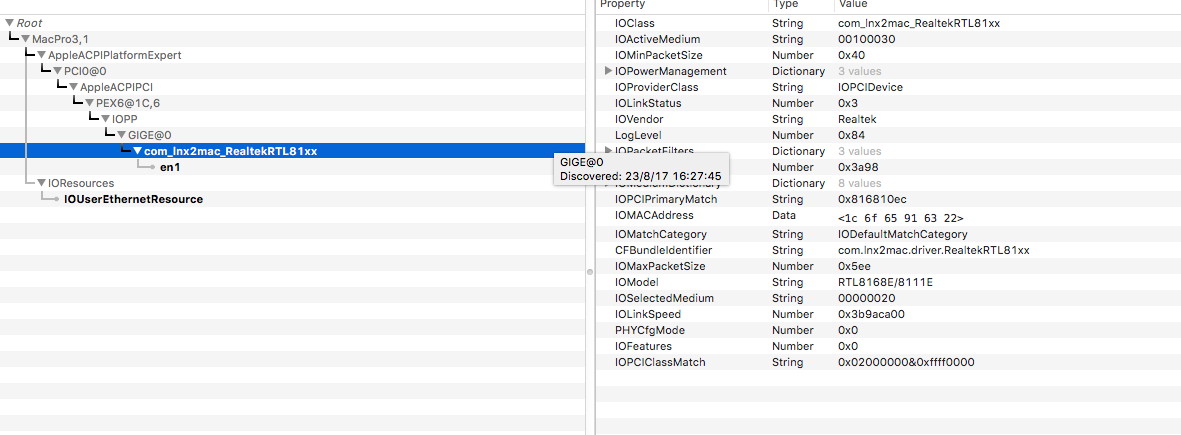

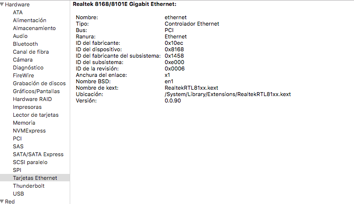

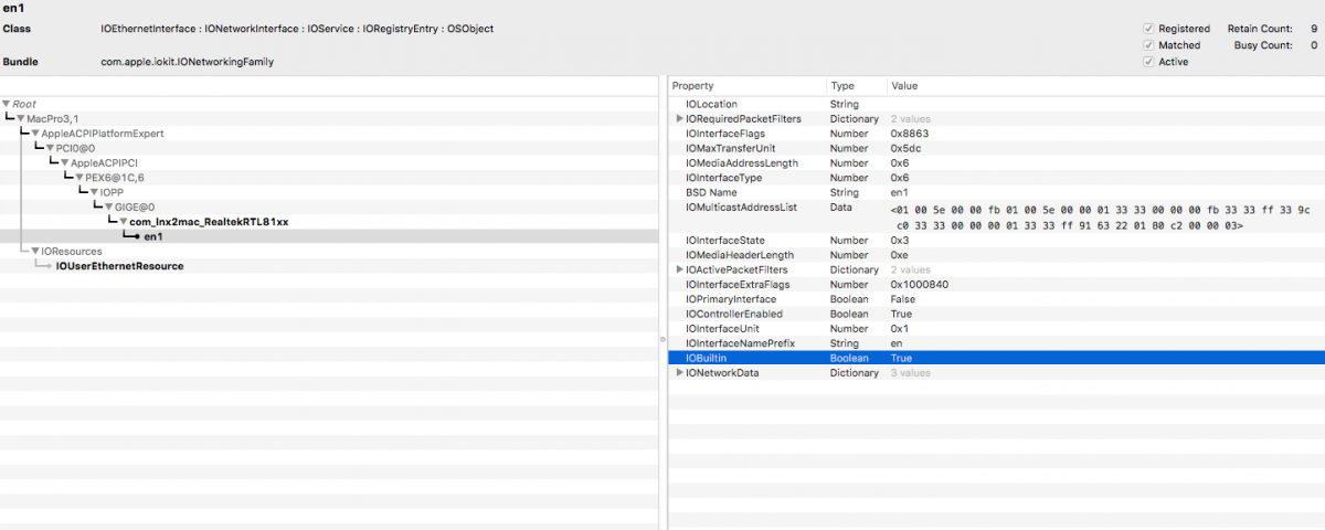

riffrico Posted August 23, 2017 Share Posted August 23, 2017 Hi everyone. I've updated my hackie to El Capitan 10.11.6. I can connect to iCloud and iTunes, but not to App Store. Maybe my Lan is en1? How could change this feature? Should I compile DSDT to change it? Thanks in advance. DSDT.aml.zip Link to comment https://www.insanelymac.com/forum/topic/326447-no-access-to-app-store-after-update-to-10116/ Share on other sites More sharing options...
RehabMan Posted August 23, 2017 Share Posted August 23, 2017 Hi everyone. I've updated my hackie to El Capitan 10.11.6. I can connect to iCloud and iTunes, but not to App Store. Maybe my Lan is en1? How could change this feature? Should I compile DSDT to change it? Thanks in advance. Try resetting the network interfaces. To do that, go into SysPrefs->Network and remove all interfaces, Apply, then remove /Library/Preferences/SystemConfiguration/NetworkInterfaces.plist. Reboot, then add all your network interfaces back, starting with Ethernet. 1 Link to comment https://www.insanelymac.com/forum/topic/326447-no-access-to-app-store-after-update-to-10116/#findComment-2483942 Share on other sites More sharing options...
