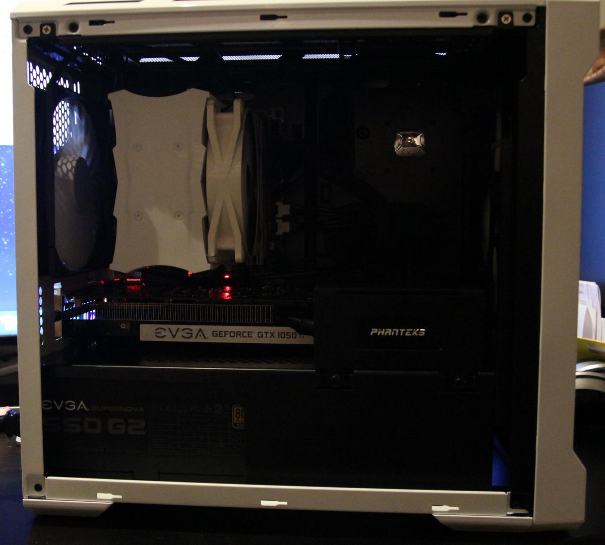

Mini-ITX Storm Trooper Build:
Phanteks Enthoo Evolv Mini-ITX Case
ASUS Z170 Mini ITX Motherboard
Intel i7 CPU 3.4 GHz Quadcore (Skylake)
Alpenfohn Matterhorn White CPU Cooler
Crucial Ballistix 16GB Ram Kit (8x2)
EVGA 1050Ti 4GB Video Card
Samsung 960 EVO M.2 SSD (250GB) (BOOT DRIVE)
Seagate Barracuda 2TB 7200RPM Internal Hard Drive (STORAGE DRIVE)
Broadcom BCM94352Z NGFF M.2 WiFi WLAN Bluetooth 4.0 802.11ac up to 867 Mbps card
Fractal Design 140mm Fan
EVGA 550 Watt Power Supply

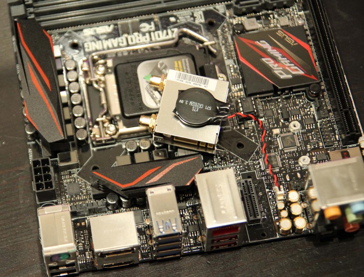

Step 1: Motherboard Prep

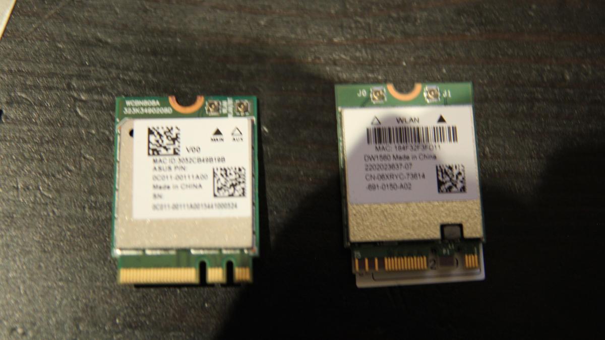

1) Replace ASUS WIFI card with Apple Broadcom WIFI Card (Inside of WI-FI Module)
2) Install M.2 SSD into back of motherboard.

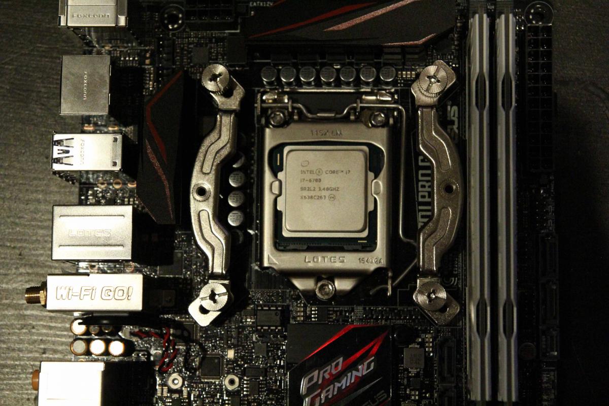

3) Install RAM, CPU and CPU Cooler.
4) Install other remaining other components.

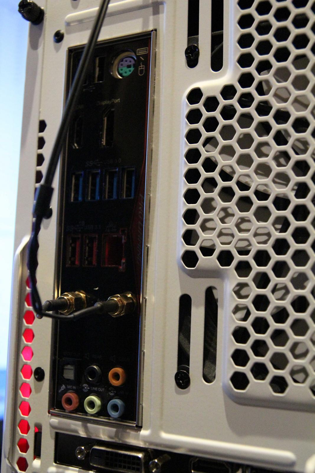

WI-FI and Bluetooth worked upon first boot up.  I am also using an IOGear Bluetooth 4.0 USB adapter plugged into one of the
USB ports.  The WI-FI signal is strong and the extension antenna works well.

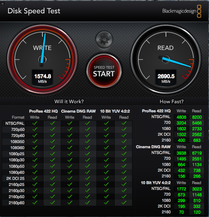

Step 4: Make the M.2 SSD the System Drive
Insert Patches into config.plist:
I needed some patches from Pike R. Alpha as well as RehabMan to get the
Final touches up and running.  One of the patches in my config.plist allows your Apple Disk utility to recognize and format
the M.2 Samsung 960 Evo SSD.  The other patch enables NVMe support for your new build and gives you the ability to use
your M.2 drive as your bootup disk.
Once those patches were added to my config.plist I was able to format my M.2 SSD hard drive as Guid partition/Mac OS Extended (Journaled)
To avoid any trouble in duplicating the install, for the final step, what I did was use Carbon Copy Cloner to clone my working OS Sierra hard drive
onto the M.2 SSD.
And that’s about it!  Now there is a working OS of Sierra as well as a working backup of it on the other drive as well.

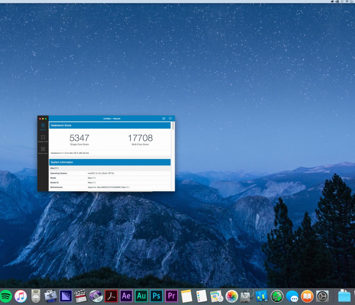

System is quiet, fast, and didn’t cost that much to build!  I did not overclock anything.  I went with the 3.4 Ghz Skylake processor over the 4.0 due to its lower power wattage.  I didn't want to liquid cool this build.

* Apparently the Z170i built-in wifi was not compatible?

1)  Correct- the built-in wifi module is not out of the box compatible with mac, so I purchased a broadcom wifi card for about $40 on ebay and replaced it.
