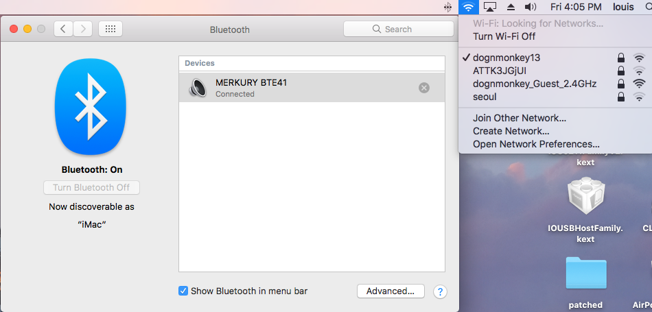

I got a new Dell Inspiron DT 3668 i5-7400 Kaby Lake for my daughter to play game and school work. The League of Legend could achieve 80-120 fps on Kaby Lake graphics with Windows 10. I installed macOS Sierra 10.12.6 since she likes Mac OS better than Windows 10. After a few nights of reading, trials and errors, I got the iMac18,2 working on the Desktop.
So what's working and what's NOT.
Things that are working that's important to me:
- Graphics full acceleration QE/CI - League of Legend fps = 70-83.
- Sound fully working front and back panel: all jacks and microphone using VoodooHDA 2.9.0d.
- Ethernet RT8168 is fully functional, fast internet.

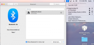

- Bluetooth built in DW1707 is working - pairing with BT headphone perfectly.

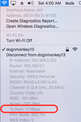

- Wifi buitl-in DW1707 is working but limited to 11Mps using Chunnan patch.
- Dual Boot Windows 10 and macOS Sierra using Clover 4114.

DW1707 is based on AR9565 which indeed is not natively nor easily supported. However, chunnann has worked on a patch of the Atheros kext and I believe it has reached some degree of success (data rate could not exceed 11Mbps last time I looked). Look here: http://www.insanelymac.com/forum/topic/312045-atheros-wireless-driver-os-x-101112-for-unsupported-cards/page-13
PCI id should be 168c:0036 (I'm surprised it shows 10ec:0036).
You might want to look at replacing that card by a model fully supported.

Thanks Herve',
 The correct id is 168c:0036.
 I got the wifi working but it limits at 5Mps and the bluetooth now is not working.
Cheers,
Louis
