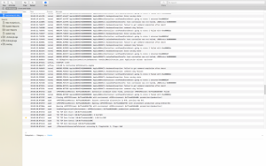

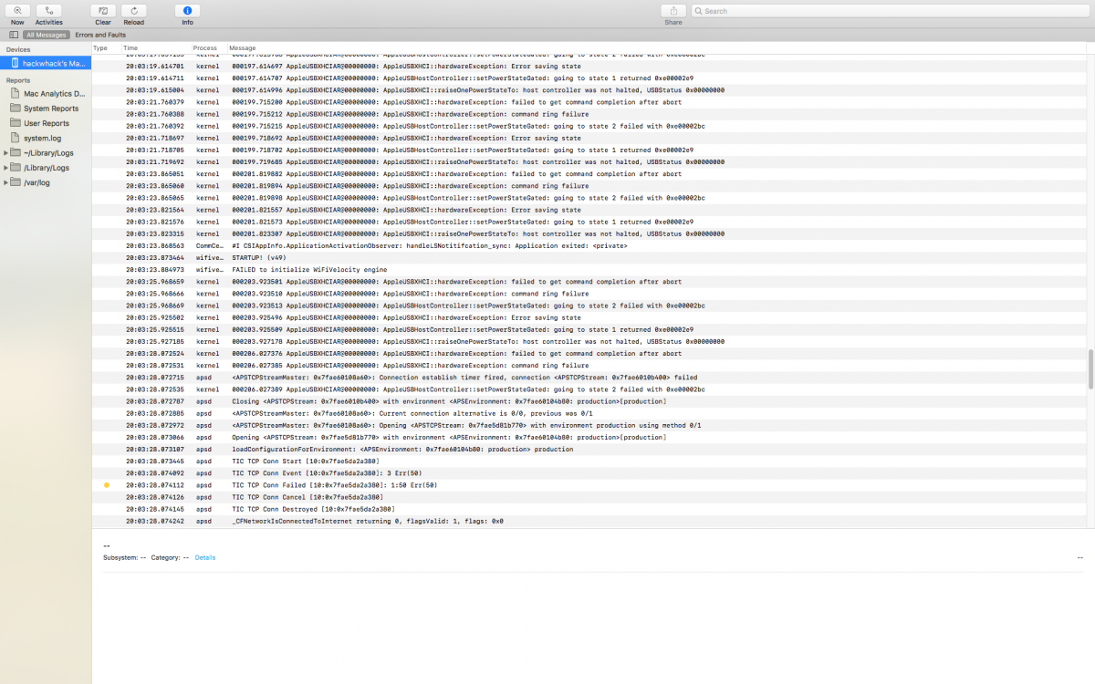

elephantsquid Posted July 10, 2017 Author Share Posted July 10, 2017 I replaced my Clover folder with what you gave me- I can see the Clover startup screen but now there are no boot options. I'm proceeding from a backup drive.Last time I looked at my system log, there was a USB/XCHI error which repeated over and over. Screen grab attached. I've toggled many of the XHCI settings in my BIOS, but nothing is having a discernable effect. System log looks exactly the same. Please take a look at the attached screen grab. Any thoughts? Link to comment https://www.insanelymac.com/forum/topic/324860-usb-control-panel-not-properly-responding/#findComment-2459693 Share on other sites More sharing options...

elephantsquid Posted August 22, 2017 Author Share Posted August 22, 2017 Mald0n- It turned out that the problem was mis-matched Thunderbolt 3 firmware on my Gigabyte GA-X99 Designare EX motherboard. The board has 2 controllers, one was on firmware v21 and the other was on 16. This was the source of the XHCI error loop which was tying up my system and preventing any Thunderbolt connectivity. Thank you anyway for your support. Link to comment https://www.insanelymac.com/forum/topic/324860-usb-control-panel-not-properly-responding/#findComment-2483480 Share on other sites More sharing options...
