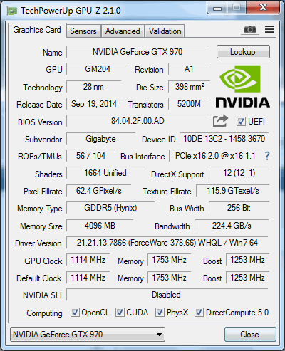

redbull02 Posted June 27, 2017 Share Posted June 27, 2017 Hey guys, I'm a bit new to hackintosh but I've done some reading into the whole installation process and after installing several versions into a test hard drive in my super old Alienware Aurora R1 (2009), and playing around with some kext patching, bootflags, etc. I'm a bit more comfortable. Anyhow, after successfully installing Sierra (10.12.3) on my system and getting on-board and PCI-e USB 2/3, on-board audio, Ethernet, firewire, etc. (not a single boot flag needed, the system runs stably), I still cannot get the Nvidia web drivers loaded or any other graphics driver injections and thus my video performance is horrible (can't get past 720p res.; only DVI-I port working and slow/glitchy GUI overall). After installing the latest version of the web drivers, I've used the most common guides to get nvidia web drivers loaded from clover bootloader (legacy boot from EFI partition on a GPT disk dedicated to OSX test installations only). I've used several recommended boot flags combinations but during the bootup process (verbose mode - can see the volumes mounted and the kernel bootup process happening without any KP or getting stuck), the screen suddenly goes dark and I get no video output out of any port of my GTX 970 card (no DVI-I, no DVI-D, no display ports and no HDMI). The only way to get back into the system is to use -x -f -F boot flags and then reverting the .plist modifications in clover so that no web drivers are loaded. Some bootflags combos tried: (1) did not enable nvda_drv=1 but enabled the system parameters => NvidiaWeb=yes (2) enabled only nvda_drv=1 and not the NvidiaWeb=yes (3) enabled both (4) enabled NvidiaWeb=yes (also kext-dev-mode=1) but made sure that any other boot flags arguments that related to generic Nvidia/Intel drivers were disabled For example: GraphicsEnabler=No; IGPEnabler=No So, do you guys have any clue as to what's happening. I would honestly just settle with any graphic driver injections that can give me some decent video output (1080p out of any DVI, display port or HDMI connections) and enough video memory to play 1080p movies online or from my HDD. I don't plan to do any gaming or heavy video tasks (I use my Win7 installation for gaming and those more VRAM-intensive applications). Thanks beforehand! Here are my hardware specs Quick specs: H869M Alienware Aurora R1 Motherboard (Intel X58 rev. 13 chipset, Southbridge Intel 82801JR (ICH10R) rev. 00) CPU: Intel Core i7 920 Bloomfield (LGA1366 socket) Memory: 9 GB total (3x2GB & 3x1GB) DDR3 SDRAM UDIMM | PC3-8500F (1066 MHz) GPU (upgraded from the original GTX 260): Gigabyte GTX 970 (GM204 | A1 revision) (4GB GDDR5 | 256 bus bandwidth | 224.4 GB/s bandwidth) I've attached an html file from CPU-Z that has more ind-depth specs. Also included a .gif screenshot from GPU-Z that has much more detail about the GPU, if needed. CPU-Z specs (Alienware Aurora).html Ops, almost forgot: here are my Ioreg files and clover origin folder (the one in the EFI partition => clover folder) origin.zip My iMac.ioreg.zip Send me My iMac.zip 1 Link to comment https://www.insanelymac.com/forum/topic/324764-cannot-load-nvidia-web-driver-for-a-gtx-970-on-an-old-2009-alienware-aurora-r1-core-i7-920-lga1366-x58ich10r-chipsetsio-controllers/ Share on other sites More sharing options...

MaLd0n Posted June 27, 2017 Share Posted June 27, 2017 -Use emuvariable driver -Add NvidiaWeb in ur config.plist -Install WebDriver -To avoid black screen with some smbios, use Lilu.kext + NvidiaGraphicsFixup.kext Link to comment https://www.insanelymac.com/forum/topic/324764-cannot-load-nvidia-web-driver-for-a-gtx-970-on-an-old-2009-alienware-aurora-r1-core-i7-920-lga1366-x58ich10r-chipsetsio-controllers/#findComment-2452604 Share on other sites More sharing options...
redbull02 Posted June 28, 2017 Author Share Posted June 28, 2017 Well, this is what I tried in the order listed: (1) installed latest version of Web drivers and CUDA drivers (2) installed the latest Clover bootloader (2.4k rev 4097) into the ESP of my OsX hard drive and selected emuvariable drivers (3) made sure I had the latest version of clover configurator, which I did have. (4) Mounted EFI partition of my OSX drive, opened, and then edited the config .plist to enable webdriver (also enabled Inject system ID option atop of NvidiaWeb option, as recommended in a tutorial). Also changed to mac pro 6.1 before finally saving .plist file (5) tried the agdpfix (after disabling SIP in clover, as requested by agdpfix app. (6) still same issue: screen goes dark but now the pc restarts right after it. I guess I'll try using the lilu.kext + nvidiagraphicsfixup.kext 1 Link to comment https://www.insanelymac.com/forum/topic/324764-cannot-load-nvidia-web-driver-for-a-gtx-970-on-an-old-2009-alienware-aurora-r1-core-i7-920-lga1366-x58ich10r-chipsetsio-controllers/#findComment-2453055 Share on other sites More sharing options...
