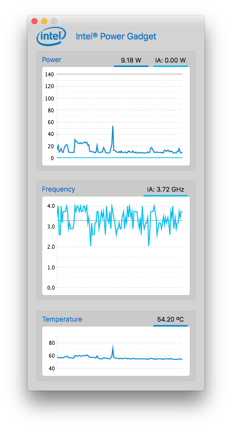

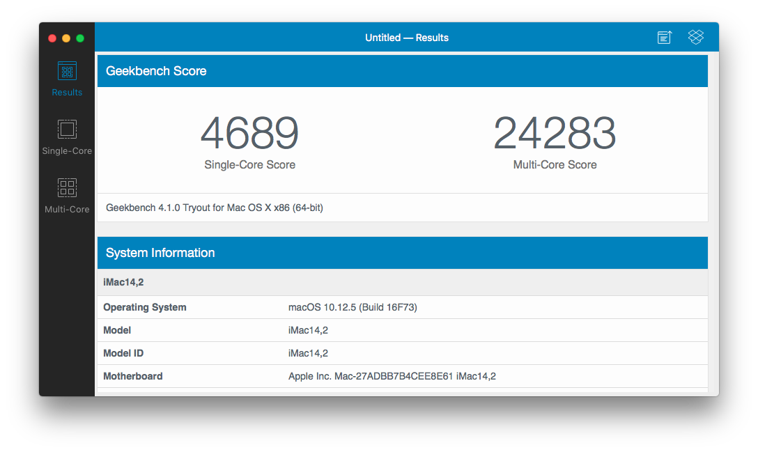

Jasper Levi Posted May 18, 2017 Author Share Posted May 18, 2017 just test it http://www.insanelymac.com/forum/index.php?app=core&module=attach§ion=attach&attach_id=239357 All seems to be well, apart from a few things: I use a 4k monitor at 4k. The display seems to be constricted to 1920x1080. Have you done it thru the patched DSDT? The Okrasit Performance Fix, while it gives me a high Geekbench score (screenshot attached) makes my 5820K stay between 2 GHz and my turbo limit - currently 4 GHz (screenshot attached) Okrasit's Performance Fix also makes my computer a little unstable. I have had it randomly reboot several times when using it. FCPX is even faster, racing thru Bruce X 5K in 13 seconds - probably due to the performance fix Do I need to stick to iMac 14,2 SMBIOS? If so, please explain why. Do I need Lilu and NVidiaGraphicsFixup kexts? I have run the ADGPFix app... 1 Link to comment https://www.insanelymac.com/forum/topic/323759-delay-after-keying-in-password/#findComment-2426630 Share on other sites More sharing options...
MaLd0n Posted May 18, 2017 Share Posted May 18, 2017 1- Apply HDMI in DSDT, same patch in ur old SSDT 2- if u dont use PMDrvr.kext, dont generate correct p-states, but is good 3- Try with Pike patch to avoid it in Kernel to patch Comment: MSR 0xE2 _xcpm_idle instant reboot (c) Pike R. AlphaMatchOS: 10.12Find: 20b9e200 00000f30 Replace: 20b9e200 00009090 4- U can use iMac14, iMac15, MacPro6...i prefer iMac14,2, but the same result 5- Lilu, AppleAlc and NVidiaGraphicsFixup need it 6- NVidiaGraphicsFixup, use it and u dont need patched again after all updates Link to comment https://www.insanelymac.com/forum/topic/323759-delay-after-keying-in-password/#findComment-2426639 Share on other sites More sharing options...

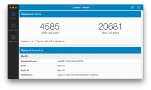

Jasper Levi Posted May 18, 2017 Author Share Posted May 18, 2017 1- Good 2- Need test 3- Ye, u need test 4- No, dont have native support, like Skylake, dont work with a easy way 5- It's true OK, so no go with PMDrvr (I didn't have my fingers crossed anyway). I switched to iMac15,1 and all seems to be holding up. Removed the Okrasit Performance Fix, Geekbench is down by about 4400 points but not SO much... screenshot attached. FCPX still blazing fast. How it got so fast, I don't know but I'm not losing sleep over it. It used to take 73 seconds for Bruce X 5K earlier. I had this SSDT which I had created to inject my USB 2 and 3 ports (verified as fine by Rehabman) which you removed while fixing my DSDT. Can I go back to using it? Or better still, can it be patched into the DSDT? Can I also go back to using my audio kext? It let me use a vanilla AppleHDA kext and also survived all updates so far. Best was, there were no scraping noises while booting up. This sort of kills it for me. Can I go back to it, or are we now patching audio thru the DSDT? I can see this "Soundflower" device in my sound settings but I didn't put it in. Can we do away with it, or is it part of the patching? Pls see screenshot of sound settings. Thanks 1 Link to comment https://www.insanelymac.com/forum/topic/323759-delay-after-keying-in-password/#findComment-2426691 Share on other sites More sharing options...

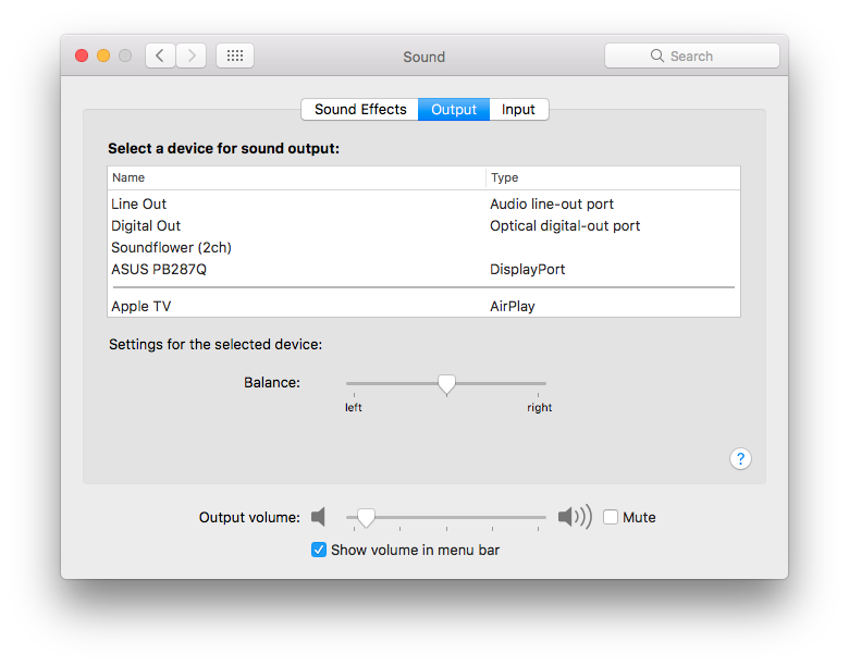

MaLd0n Posted May 18, 2017 Share Posted May 18, 2017 yes, u can back to old audio, apply patches in config.plist, in DSDT have hdef with same id no idea about soundflower, i think is external audio interface Yes, use ur ssdt usb Link to comment https://www.insanelymac.com/forum/topic/323759-delay-after-keying-in-password/#findComment-2426729 Share on other sites More sharing options...
Jasper Levi Posted May 18, 2017 Author Share Posted May 18, 2017 yes, u can back to old audio, apply patches in config.plist, in DSDT have hdef with same id no idea about soundflower, i think is external audio interface Yes, use ur ssdt usb Thanks, USB injection is back. Audio still popping and crackling/scraping... 1 Link to comment https://www.insanelymac.com/forum/topic/323759-delay-after-keying-in-password/#findComment-2426778 Share on other sites More sharing options...
MaLd0n Posted May 18, 2017 Share Posted May 18, 2017 DSDT.HDEF without _dsm.zip i removed _dsm into hdef just use ur Old inject remove AppleAlc Link to comment https://www.insanelymac.com/forum/topic/323759-delay-after-keying-in-password/#findComment-2426789 Share on other sites More sharing options...
Jasper Levi Posted May 19, 2017 Author Share Posted May 19, 2017 DSDT.HDEF without _dsm.zip i removed _dsm into hdef just use ur Old inject remove AppleAlc Thanks. Did it like you said, but it still crackles and pops... 1 Link to comment https://www.insanelymac.com/forum/topic/323759-delay-after-keying-in-password/#findComment-2426888 Share on other sites More sharing options...
