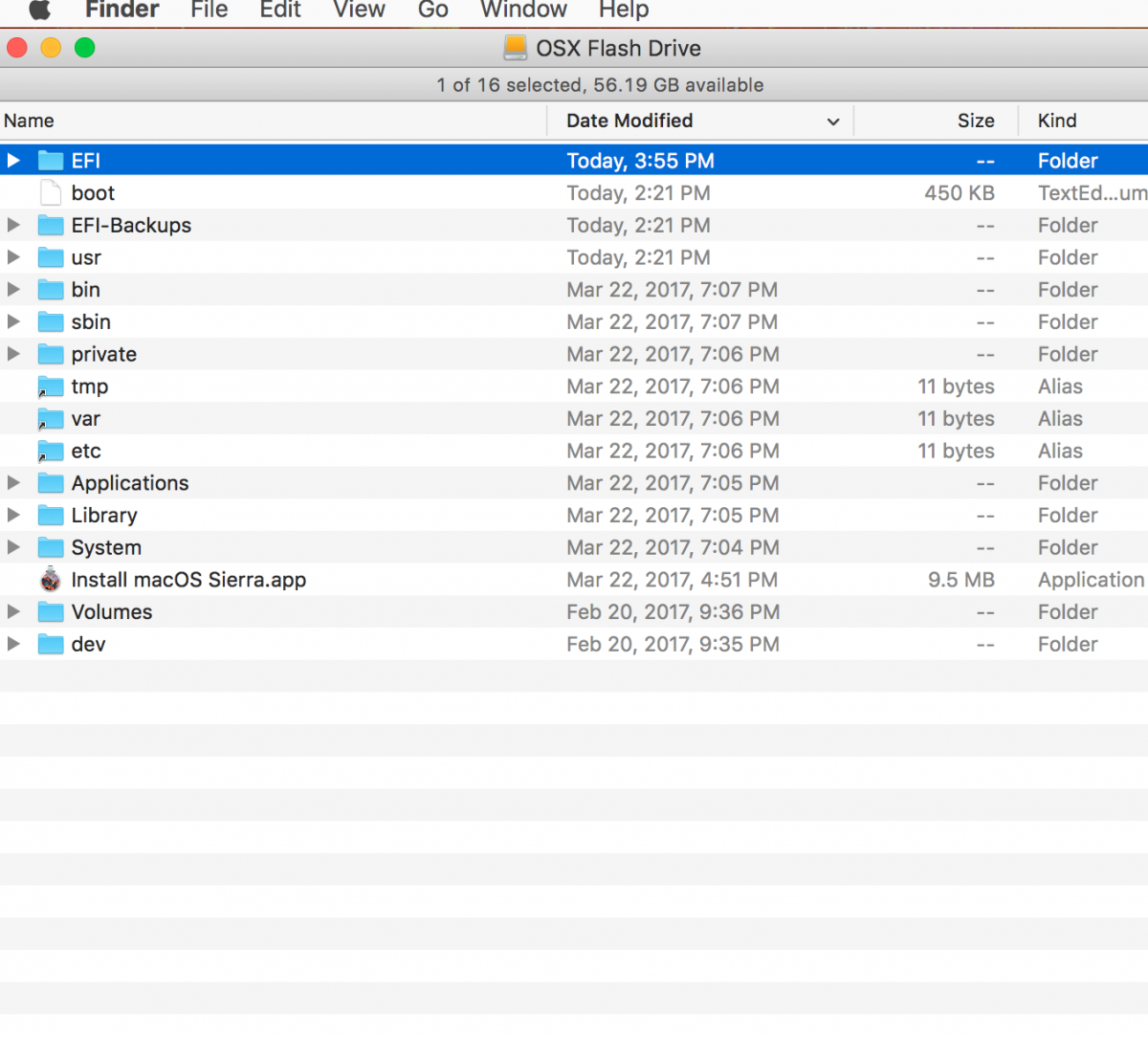

alexdi Posted April 29, 2017 Author Share Posted April 29, 2017 OK. My system refuses to boot from the resulting disk. I did: * Disk Utility -> erase, format as GUID Mac Journaled, named USB * Run Flash utility -> drag mounted USB to utility -> drag "Install Sierra.app" to utility -> Enter -> Enter password -> Enter * Run Clover package -> install to OSX Flash Drive -> "OK" * Open OSX Flash Drive \ EFI \ Clover -> copy contents of "Clover Installation.zip" -> paste, replace all It sees the USB stick, but repeatedly bypasses it to go to the drive that still has Windows on it. Picture attached. 1 Link to comment https://www.insanelymac.com/forum/topic/323273-sierra-install-with-intel-7700k-msi-z270m-mortar-success/#findComment-2414447 Share on other sites More sharing options...
MaLd0n Posted April 29, 2017 Share Posted April 29, 2017 UEFI, bro after create USB Stick Install Clover with these options Clover_v2.4k_r4065.pkg.zip and replace with folder in my topic What ur GPU? 1 Link to comment https://www.insanelymac.com/forum/topic/323273-sierra-install-with-intel-7700k-msi-z270m-mortar-success/#findComment-2414451 Share on other sites More sharing options...

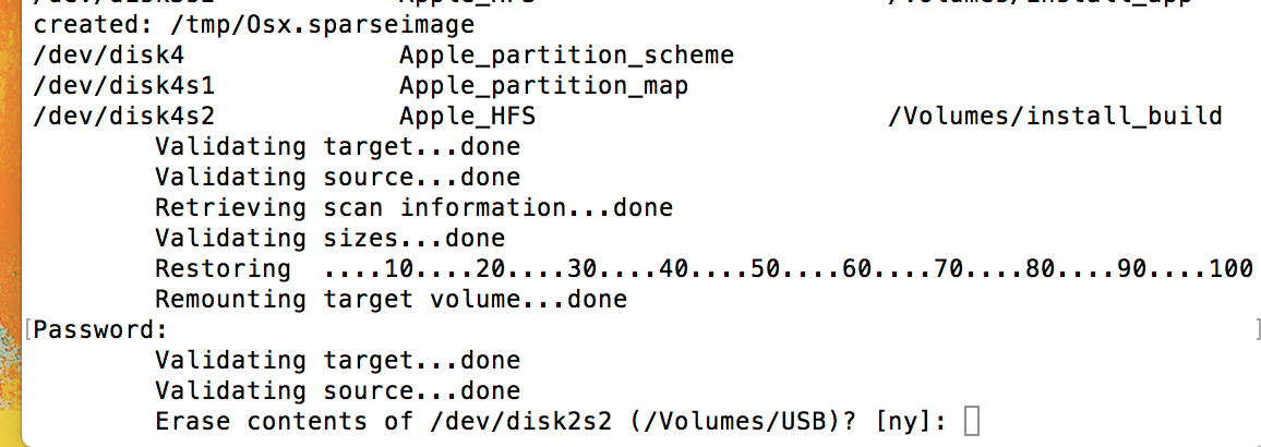

alexdi Posted April 29, 2017 Author Share Posted April 29, 2017 It's a Zotac GTX 1060 Amp 6GB. When the flash utility asks if I want to erase contents of dev/disk2s2 after I type my password, am I supposed to say yes? 1 Link to comment https://www.insanelymac.com/forum/topic/323273-sierra-install-with-intel-7700k-msi-z270m-mortar-success/#findComment-2414456 Share on other sites More sharing options...
MaLd0n Posted April 29, 2017 Share Posted April 29, 2017 yes and wait finish 1 Link to comment https://www.insanelymac.com/forum/topic/323273-sierra-install-with-intel-7700k-msi-z270m-mortar-success/#findComment-2414460 Share on other sites More sharing options...

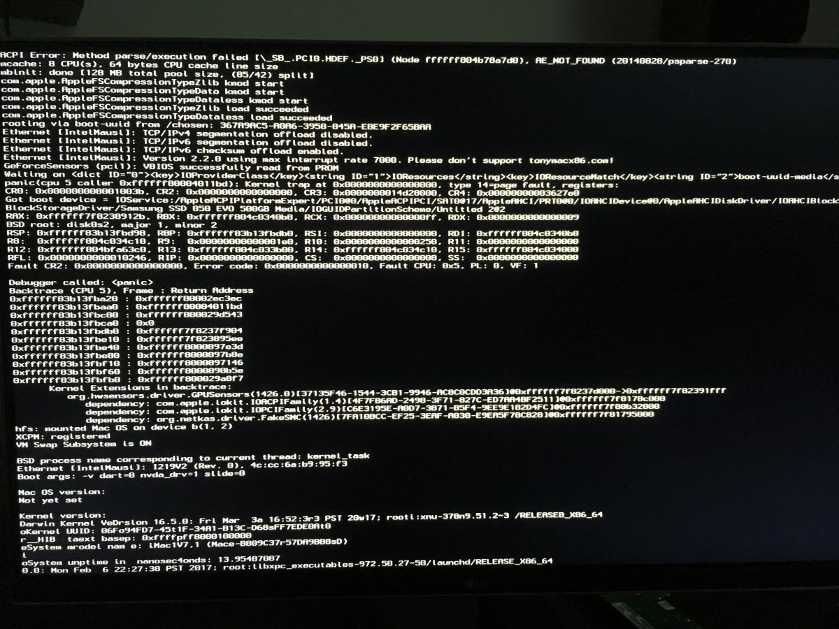

alexdi Posted April 29, 2017 Author Share Posted April 29, 2017 I pulled the drive and replaced that directory. It got one line further-- see attached. 1 Link to comment https://www.insanelymac.com/forum/topic/323273-sierra-install-with-intel-7700k-msi-z270m-mortar-success/#findComment-2414570 Share on other sites More sharing options...
MaLd0n Posted April 29, 2017 Share Posted April 29, 2017 Post a complete screen U can boot from USB? 1 Link to comment https://www.insanelymac.com/forum/topic/323273-sierra-install-with-intel-7700k-msi-z270m-mortar-success/#findComment-2414573 Share on other sites More sharing options...

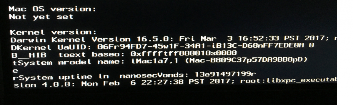

alexdi Posted April 29, 2017 Author Share Posted April 29, 2017 Yeah, I still have the USB stick I made for the initial install. I'll take another photo. Here we go: 1 Link to comment https://www.insanelymac.com/forum/topic/323273-sierra-install-with-intel-7700k-msi-z270m-mortar-success/#findComment-2414580 Share on other sites More sharing options...
MaLd0n Posted April 29, 2017 Share Posted April 29, 2017 U have a fresh install? Dont install nothing, only Clover, replace folder and install Web Drivers 1 Link to comment https://www.insanelymac.com/forum/topic/323273-sierra-install-with-intel-7700k-msi-z270m-mortar-success/#findComment-2414586 Share on other sites More sharing options...
