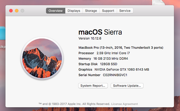

Hi Folks this is my second hack but the first time I've not had a guide to follow myself so I thought id provide some information regarding the setup and the problems I
faced when I started the aim is to help anyone that either doesn't know where to start or may need a rough guide to setting up the STRIX
Quote
Whats Working:
Sound
usb2
usb3
built in Camera
keyboard
Battery stats & energy saving options
Lid sleep
card reader
Ethernet
GTX1060 with Nvidia web drivers
Touchpad with voodooi2c 2.01
Keyboard with fn+volume Buttons working other keys dont work.
Screen Backlight With Native AppleBacklight + injector
HDMI/DP
HDMI Sound
AC Adapter detection
WIFI/BT (BCM94352Z)
Quote
not working:
Some FN Keys
Keyboard Backlight
Setup:
High Sierra 10.13.1
High Sierra 10.13.3 Has issues with the latest Nvidia Drivers.
My Github Repository Contains Everything you need so you can build your own DSDT/SSDT.
i would recommend you use the hack-ssdt's not named SSDT-0/4 the setup depends on them to be there.
My Repository includes a setup script to install some neccesarry files, all you need to do is dump your own ACPI files, Dissasemble patch and recompile.
SSDT-1.aml in the Repo should replace the one from your system as it wont compile and needs some work.
Heres the link to my current setup Files
My Github Repository has all the required patches for:
Voodooi2c
audio
syntax
system
etc
Edited by onejay09

I'm not using any custom dsdt. Just the stuff you've provided here. I notice there's another Voodool2c in your new kexts folder now. Now there's 2. Before, there was only one. Am I putting them into /library/extensions or into /system/library/extensions?
As I said, everything else works great and I've gotten around the wifi issue with a simple USB wifi dongle. Now it's just the trackpad and I'm there.
Thanks for the help. Incredible stuff.
