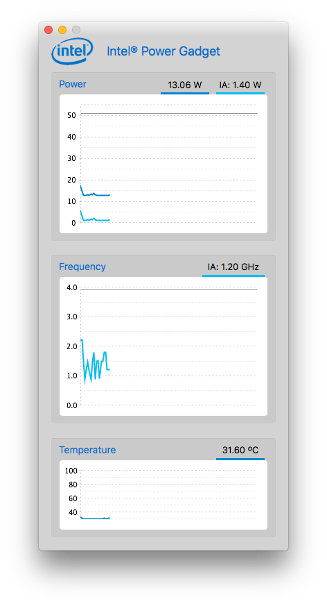

FrankPaulThe2nd Posted April 20, 2017 Author Share Posted April 20, 2017 Hi Mald0n, thanks very much, it worked! Now the mother of all questions, just for the sake of nowledge : my CPU runs at about 32° to 37° and very rarely it reaches 40°. So basically I think that I don’t stress it that much (Adobe CC and Microsoft Office are the programs I use the most. So no 3D rendering and absolutely no gaming). Fortunately my Corsair h110i seems to keep everything nice and cool. Accordingly, I think that also my power consumption should be very low. Doing benchmark as of now and with my previous configuration, gives me the exact same result, maybe oscillating of some 0,something%. So is the correct PM in a Hackintosh, with all these patches and headache to obtain it, a real game changer, so to speak, in terms of performance, cooling and power consumption? Thanks for your kind help anyway and have a nice day! Francesco 1 Link to comment https://www.insanelymac.com/forum/topic/322673-sierra-10124-need-help-for-power-management-and-fine-tuning/#findComment-2408016 Share on other sites More sharing options...
MaLd0n Posted April 20, 2017 Share Posted April 20, 2017 Use it and check PM and power consumption Intel® Power Gadget SIERRA.zip Link to comment https://www.insanelymac.com/forum/topic/322673-sierra-10124-need-help-for-power-management-and-fine-tuning/#findComment-2408157 Share on other sites More sharing options...

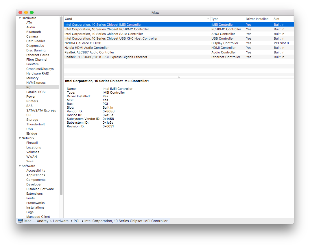

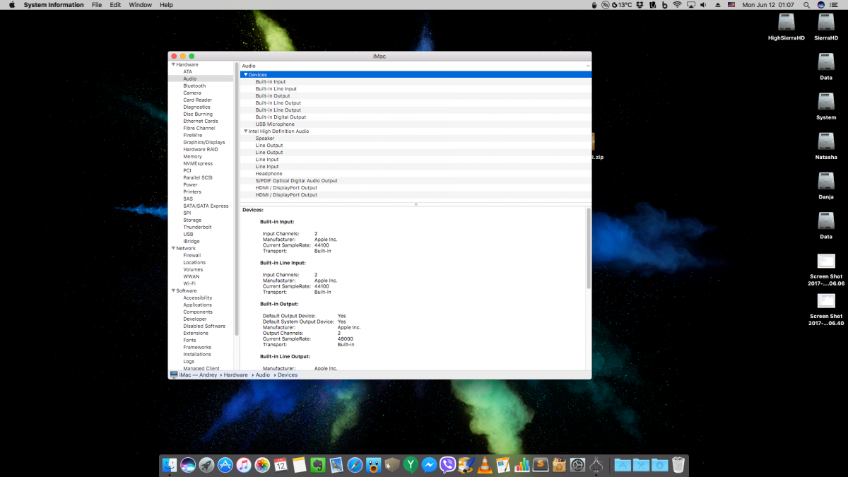

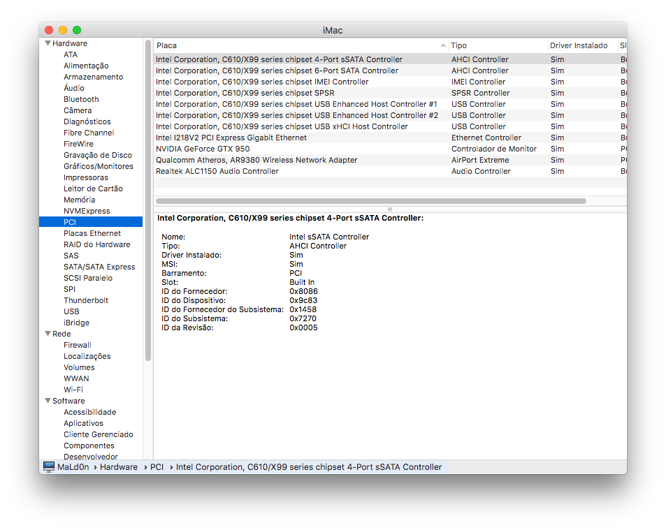

MaLd0n Posted May 21, 2017 Share Posted May 21, 2017 Look good! Test ur native onboard audio, test hdmi audio, etc etc Check cosmetic things in "About This Mac / PCI", if u can post one screenshot like it PM if go to 800mhz in idle, is good! 1 Link to comment https://www.insanelymac.com/forum/topic/322673-sierra-10124-need-help-for-power-management-and-fine-tuning/#findComment-2428902 Share on other sites More sharing options...
lpukraine Posted May 21, 2017 Share Posted May 21, 2017 Look good! Test ur native onboard audio, test hdmi audio, etc etc Check cosmetic things in "About This Mac / PCI", if u can post one screenshot like it MaLd0n 2017-05-21 às 13.02.31.png PM if go to 800mhz in idle, is good! WOW! Thanks! Looks great! Audio works perfectly, unfortunately can't check HDMI audio. PS. Just one more thing) Will be great to get working Intel Graphics 630. Maybe one day I will want to use it instead nVidia card. 1 Link to comment https://www.insanelymac.com/forum/topic/322673-sierra-10124-need-help-for-power-management-and-fine-tuning/#findComment-2428904 Share on other sites More sharing options...

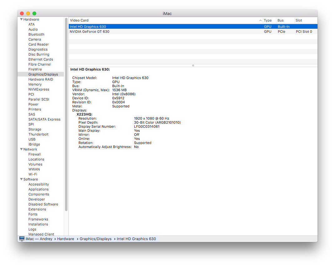

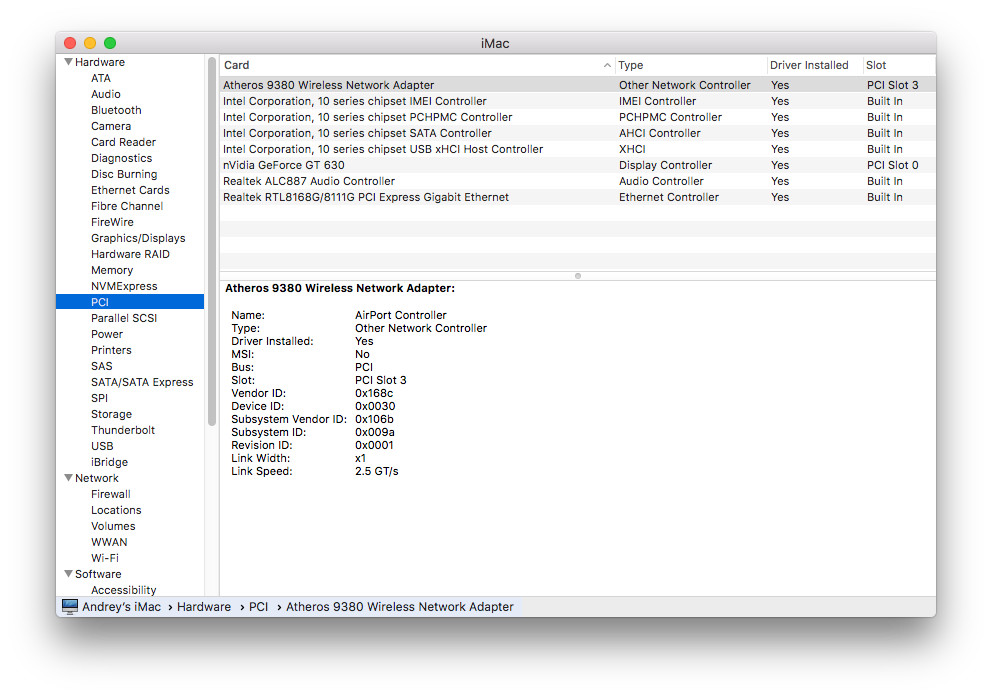

lpukraine Posted June 11, 2017 Share Posted June 11, 2017 Hello, MaLd0n! Unfortunately, need your help again. Recently I decided to use my integrated HD630 as main videocard and use my GT630 as additional (for second monitor). And I did it successfully with help from guy at 4PDA forum. Today I updated my hack to have native KabyLake and HD630 support (https://support.apple.com/kb/DL1921?locale=en_US). I did it with this manual - http://4pda.ru/forum/index.php?showtopic=753765&view=findpost&p=58075541. My HD 630 work great and now I don't need to use FakeIDs. But... My sound becomes broken. Tried different layout ids, but no luck. I can to put my hack to sleep, but I can wake. Monitor doesn't turn on. Maybe power management doesn't work properly or something else. At least I notice that now I don't have dsdt file (made by you) in my clover folder. Can you check my config and power management once more time? My files: CLOVER.zip iMac — Andrey.zip Send me iMac — Andrey.zip 1 Link to comment https://www.insanelymac.com/forum/topic/322673-sierra-10124-need-help-for-power-management-and-fine-tuning/#findComment-2441739 Share on other sites More sharing options...
MaLd0n Posted June 11, 2017 Share Posted June 11, 2017 Hello, MaLd0n! Unfortunately, need your help again. Recently I decided to use my integrated HD630 as main videocard and use my GT630 as additional (for second monitor). And I did it successfully with help from guy at 4PDA forum. Today I updated my hack to have native KabyLake and HD630 support (https://support.apple.com/kb/DL1921?locale=en_US). I did it with this manual - http://4pda.ru/forum/index.php?showtopic=753765&view=findpost&p=58075541. My HD 630 work great and now I don't need to use FakeIDs. But... My sound becomes broken. Tried different layout ids, but no luck. I can to put my hack to sleep, but I can wake. Monitor doesn't turn on. Maybe power management doesn't work properly or something else. At least I notice that now I don't have dsdt file (made by you) in my clover folder. Can you check my config and power management once more time? My files: try CLOVER.zip 1 Link to comment https://www.insanelymac.com/forum/topic/322673-sierra-10124-need-help-for-power-management-and-fine-tuning/#findComment-2442060 Share on other sites More sharing options...

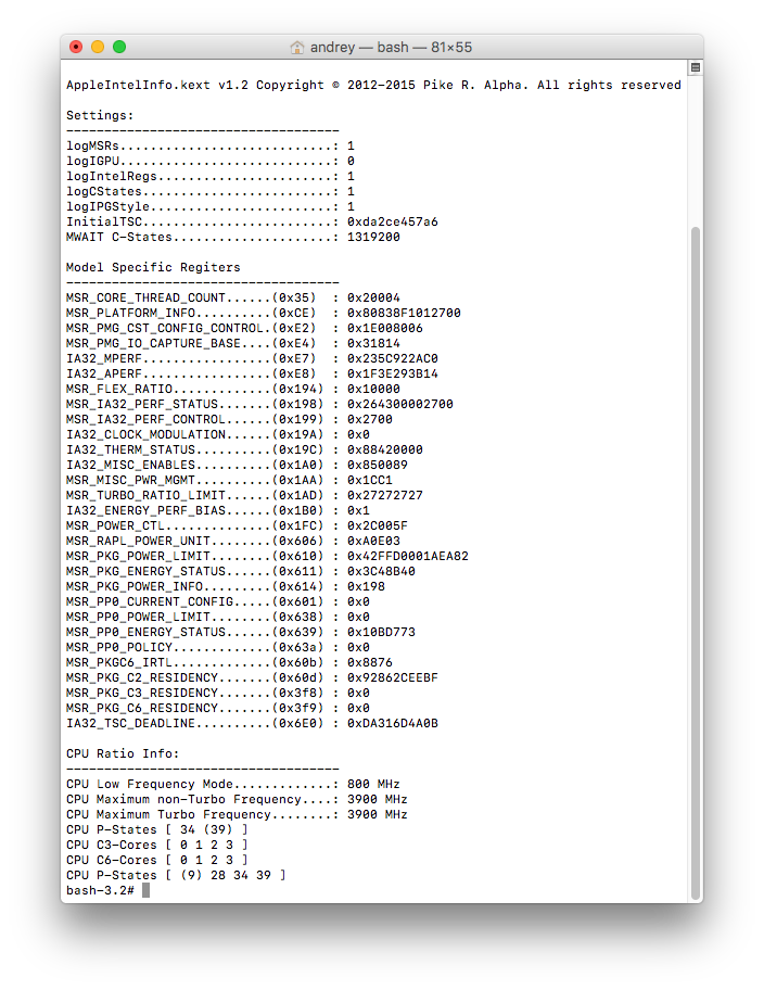

lpukraine Posted June 11, 2017 Share Posted June 11, 2017 try CLOVER.zip It seems that everything work great except sleep. Can put to sleep, but it restarts instead to wake. Thanks for your great work! Later will try boot in High Sierra. Hope it will work the same. Just one more question, I noticed couple stings with ACPI errors in boot log: Kernel_Messsages_BootLog.txt.zip Please take a look in log file. Thanks! 1 Link to comment https://www.insanelymac.com/forum/topic/322673-sierra-10124-need-help-for-power-management-and-fine-tuning/#findComment-2442393 Share on other sites More sharing options...
lpukraine Posted June 11, 2017 Share Posted June 11, 2017 Successfully booted in the High Sierra. Copy config.plist, changed smbios section to imac18,1 (but I don't know why it shows iMac Late 2012, not Late 2017) and add -lilubeta -igfxbeta -disablegfxfirmware -alcbets flags. Same with the sleep, able to put to sleep but restart instead wake. And some ACPI errors in boot log. Kernel_Messsages_BootLog.txt.zip 1 Link to comment https://www.insanelymac.com/forum/topic/322673-sierra-10124-need-help-for-power-management-and-fine-tuning/#findComment-2442420 Share on other sites More sharing options...
MaLd0n Posted June 12, 2017 Share Posted June 12, 2017 try with darkwake option in config.plist to avoid reboot after sleep 1 Link to comment https://www.insanelymac.com/forum/topic/322673-sierra-10124-need-help-for-power-management-and-fine-tuning/#findComment-2442440 Share on other sites More sharing options...
