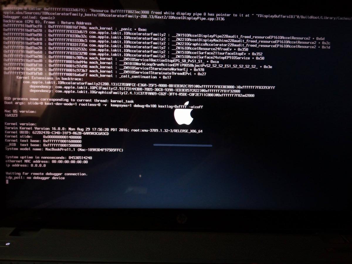

phuanh004 Posted March 31, 2017 Share Posted March 31, 2017 After 1st boot to MacOS, I shut down and restart so I got this kernel panic on my Hp m6. There is some info below; please check it. Has anyone else had this issue or has any idea how to fix it? Thanks! config + dsdt +ssdt.zip Link to comment Share on other sites More sharing options...
MaLd0n Posted March 31, 2017 Share Posted March 31, 2017 try remove patch in config.plist IOGraphicsFamily 1 Link to comment Share on other sites More sharing options...
phuanh004 Posted March 31, 2017 Author Share Posted March 31, 2017 try remove patch in config.plist IOGraphicsFamily thanks, it's helped Link to comment Share on other sites More sharing options...
