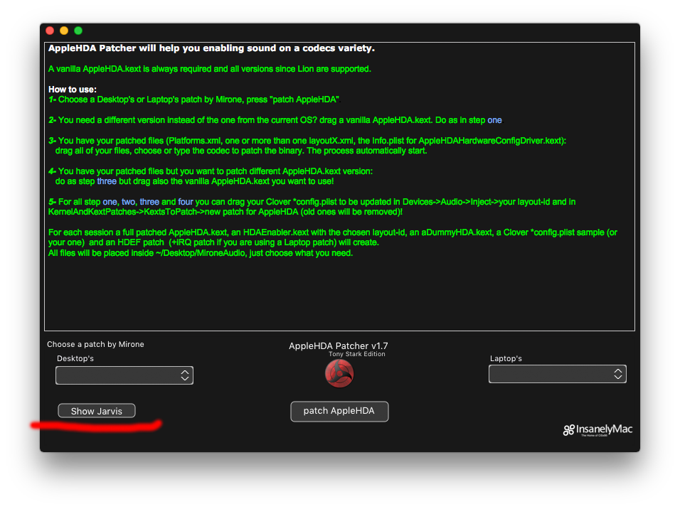

MaLd0n Posted March 21, 2017 Share Posted March 21, 2017 Use AppleHdaPatcher and try see ur codec Use Show Jarvis  u apply SBUS into HDAS/HDEF SKYLAKE and KABYLAKE, the patches is others Device (HDAS) { Name (_ADR, 0x001F0003) // _ADR: Address OperationRegion (HDAR, PCI_Config, Zero, 0x0100) Field (HDAR, WordAcc, NoLock, Preserve) { VDID, 32, Offset (0x48), , 6, MBCG, 1, Offset (0x54), Offset (0x55), PMEE, 1, , 6, PMES, 1 } Name (_S0W, 0x03) // _S0W: S0 Device Wake State Method (_DSW, 3, NotSerialized) // _DSW: Device Sleep Wake { Store (Arg0, PMEE) } Method (GPEH, 0, NotSerialized) { If (LEqual (VDID, 0xFFFFFFFF)) { } If (LAnd (PMEE, PMES)) { ADBG ("HDAS GPEH") Store (One, PMES) Notify (HDAS, 0x02) } Return (Zero) } Name (NBUF, ResourceTemplate () { QWordMemory (ResourceConsumer, PosDecode, MinNotFixed, MaxNotFixed, NonCacheable, ReadOnly, 0x0000000000000001, // Granularity 0x0000000000000000, // Range Minimum 0x0000000000000000, // Range Maximum 0x0000000000000000, // Translation Offset 0x0000000000000000, // Length ,, _Y1A, AddressRangeACPI, TypeStatic) }) Method (AUWA, 0, Serialized) { If (LEqual (PCHS, One)) { If (LEqual (^^LPCB.CRID, Zero)) { Return (One) } } Else { If (LEqual (^^LPCB.CRID, Zero)) { Return (One) } If (LEqual (^^LPCB.CRID, One)) { Return (One) } If (LEqual (^^LPCB.CRID, 0x09)) { Return (One) } } Return (Zero) } Method (_INI, 0, NotSerialized) // _INI: Initialize { ADBG ("HDAS _INI") CreateQWordField (NBUF, \_SB.PCI0.HDAS._Y1A._MIN, NBAS) // _MIN: Minimum Base Address CreateQWordField (NBUF, \_SB.PCI0.HDAS._Y1A._MAX, NMAS) // _MAX: Maximum Base Address CreateQWordField (NBUF, \_SB.PCI0.HDAS._Y1A._LEN, NLEN) // _LEN: Length Store (NHLA, NBAS) Add (NHLA, Subtract (NHLL, One), NMAS) Store (NHLL, NLEN) If (LEqual (AUWA (), One)) { Store (Zero, MBCG) } Return (Zero) } Method (XDSM, 4, Serialized) { Name (_T_0, Zero) // _T_x: Emitted by ASL Compiler ADBG ("HDAS XDSM") If (PCIC (Arg0)) { Return (PCID (Arg0, Arg1, Arg2, Arg3)) } If (LEqual (Arg0, ToUUID ("a69f886e-6ceb-4594-a41f-7b5dce24c553"))) { While (One) { Store (Arg2, _T_0) If (LEqual (_T_0, Zero)) { Return (Buffer (One) { 0x0F }) } ElseIf (LEqual (_T_0, One)) { ADBG ("XDSM Fun 1 NHLT") Return (NBUF) } ElseIf (LEqual (_T_0, 0x02)) { ADBG ("XDSM Fun 2 FMSK") Return (ADFM) } ElseIf (LEqual (_T_0, 0x03)) { ADBG ("XDSM Fun 3 PPMS") Return (Zero) } Else { ADBG ("XDSM Fun NOK") Return (Buffer (One) { 0x00 }) } Break } } ADBG ("XDSM UUID NOK") } Device (BUS0) { Name (_CID, "smbus") // _CID: Compatible ID Name (_ADR, Zero) // _ADR: Address Device (DVL0) { Name (_ADR, 0x57) // _ADR: Address Name (_CID, "diagsvault") // _CID: Compatible ID Method (_DSM, 4, NotSerialized) // _DSM: Device-Specific Method { If (LEqual (Arg2, Zero)) { Return (Buffer (One) { 0x03 }) } Return (Package (0x02) { "address", 0x57 }) } } } why u use xdsm patches? is a very suck patch, use it if u use hacknvme, u can rename only _DSM with cause K.P, not entire DSDT, in many cases smart HDD is not detect if u use this patch, take a test 1 Link to comment https://www.insanelymac.com/forum/topic/322019-audio-problem-on-asus-k501ux/#findComment-2388578 Share on other sites More sharing options...
