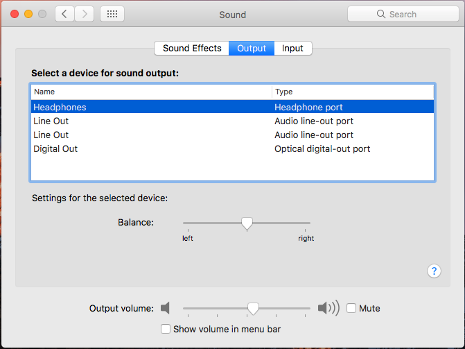

Baffol2asta Posted March 16, 2017 Share Posted March 16, 2017 Hi everybody, here's my situation: as you can stare in my hardware specifications (below) I own an Ati Radeon HD5450 and as you may have guessed right now, I'm trying to make it reproduce audio through HDMI. Anyway, even if my HDMi audio doesn't work at all, as I plug in my headsets (Astro A40, 3.5 jack) it just does its job fine. Also if I plug in my microphone and plug my headset to the microphone (Blue Yeti) input, and set output on (Blue Yeti Microphone) it works. Graphics works fine (oddly I didn't have to put my hand on any file, it got automatically recognized as I rebooted after first installation). Only thing not working is HDMi audio. Plus, even if I don't know how it could change things, I'm not using a monitor but a TV.Thanks in advance. Hardware specs: Mobo: MSI Z270 GAMING PRO CPU: Intel i7 7700k Graphics: AMD Radeon HD 5450 PS: I forgot to mention that I'm working on OS Sierra. 1 Link to comment https://www.insanelymac.com/forum/topic/321915-ati-radeon-hd5450-hdmi-audio-not-working/ Share on other sites More sharing options...

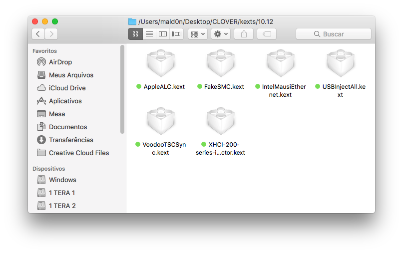

MaLd0n Posted March 16, 2017 Share Posted March 16, 2017 try it Arquivo Comprimido.zip ----------------------------------------------------- if u can a clean install, see ur full folder Clover CLOVER Baffol2asta.zip after install system, install clover UEFI mode https://sourceforge.net/projects/cloverefiboot/files/Installer/Clover_v2.4k_r4035.zip/download and replace full folder http://www.insanelymac.com/forum/topic/321872-guide-sierra-on-gigabyte-mobos-serie-200-kabylake-dsdt/ *btw, use ur kexts in Clover/Kexts/10.xx u dont need cpus=1, use VoodooTSCSync.kext for i7 Link to comment https://www.insanelymac.com/forum/topic/321915-ati-radeon-hd5450-hdmi-audio-not-working/#findComment-2385501 Share on other sites More sharing options...

MaLd0n Posted March 16, 2017 Share Posted March 16, 2017 All kexts in clover/kexts/10.12 and full DSDT edit HDMI u need try, but i think work Link to comment https://www.insanelymac.com/forum/topic/321915-ati-radeon-hd5450-hdmi-audio-not-working/#findComment-2385542 Share on other sites More sharing options...
Baffol2asta Posted March 16, 2017 Author Share Posted March 16, 2017 All kexts in clover/kexts/10.12 01.png and full DSDT edit 02.png HDMI u need try, but i think work Did what you said, now I reboot and let you know... Link to comment https://www.insanelymac.com/forum/topic/321915-ati-radeon-hd5450-hdmi-audio-not-working/#findComment-2385551 Share on other sites More sharing options...

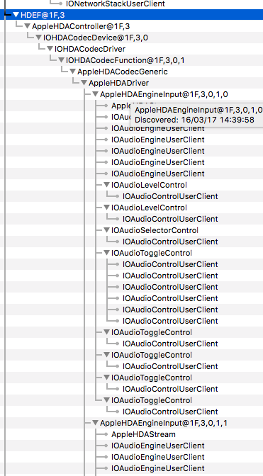

MaLd0n Posted March 16, 2017 Share Posted March 16, 2017 Good, Ioreg is nice now Check SystemPreferences/Sound if dont work, try it in Clover/Kexts/10.12 HDMIAudio.kext.zip u dont need more cpus=1 Link to comment https://www.insanelymac.com/forum/topic/321915-ati-radeon-hd5450-hdmi-audio-not-working/#findComment-2385651 Share on other sites More sharing options...
Baffol2asta Posted March 16, 2017 Author Share Posted March 16, 2017 Good, Ioreg is nice now Check SystemPreferences/Sound if dont work, try it in Clover/Kexts/10.12 HDMIAudio.kext.zip u dont need more cpus=1 Tried both, still nothing. I attach new IOreg. log.zip Link to comment https://www.insanelymac.com/forum/topic/321915-ati-radeon-hd5450-hdmi-audio-not-working/#findComment-2385666 Share on other sites More sharing options...

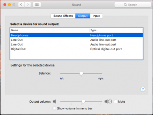

MaLd0n Posted March 16, 2017 Share Posted March 16, 2017 dont recognize ur tv in System/Preferences/Sound? Link to comment https://www.insanelymac.com/forum/topic/321915-ati-radeon-hd5450-hdmi-audio-not-working/#findComment-2385675 Share on other sites More sharing options...
Baffol2asta Posted March 16, 2017 Author Share Posted March 16, 2017 dont recognize ur tv in System/Preferences/Sound? Link to comment https://www.insanelymac.com/forum/topic/321915-ati-radeon-hd5450-hdmi-audio-not-working/#findComment-2385678 Share on other sites More sharing options...

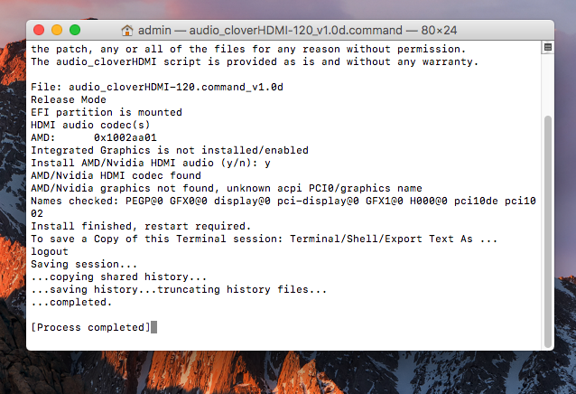

MaLd0n Posted March 16, 2017 Share Posted March 16, 2017 read it http://www.insanelymac.com/forum/topic/310530-el-capitan-applehda-hdmi-audio/ work for sierra too Link to comment https://www.insanelymac.com/forum/topic/321915-ati-radeon-hd5450-hdmi-audio-not-working/#findComment-2385741 Share on other sites More sharing options...
Baffol2asta Posted March 16, 2017 Author Share Posted March 16, 2017 read it http://www.insanelymac.com/forum/topic/310530-el-capitan-applehda-hdmi-audio/ work for sierra too I tried cloverHDMi but I get this error: Link to comment https://www.insanelymac.com/forum/topic/321915-ati-radeon-hd5450-hdmi-audio-not-working/#findComment-2385746 Share on other sites More sharing options...

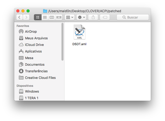

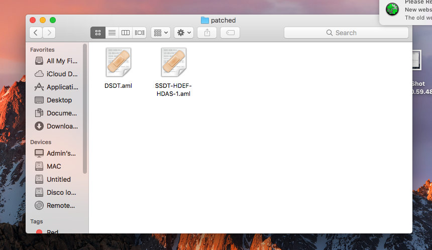

MaLd0n Posted March 16, 2017 Share Posted March 16, 2017 check ur folder Clover/Acpi/Patched Link to comment https://www.insanelymac.com/forum/topic/321915-ati-radeon-hd5450-hdmi-audio-not-working/#findComment-2385752 Share on other sites More sharing options...
Baffol2asta Posted March 16, 2017 Author Share Posted March 16, 2017 check ur folder Clover/Acpi/Patched Here is the content Link to comment https://www.insanelymac.com/forum/topic/321915-ati-radeon-hd5450-hdmi-audio-not-working/#findComment-2385759 Share on other sites More sharing options...
MaLd0n Posted March 16, 2017 Share Posted March 16, 2017 Strange run it in terminal sudo spctl --master-disable and try again man, u dont need SSDT HDAS I apply all in ur DSDT Link to comment https://www.insanelymac.com/forum/topic/321915-ati-radeon-hd5450-hdmi-audio-not-working/#findComment-2385770 Share on other sites More sharing options...
Baffol2asta Posted March 16, 2017 Author Share Posted March 16, 2017 Strange run it in terminal sudo spctl --master-disable and try again man, u dont need SSDT HDAS I apply all in ur DSDT I ran the command, removed SSDT HDAS and retried but still getting the previous error... Link to comment https://www.insanelymac.com/forum/topic/321915-ati-radeon-hd5450-hdmi-audio-not-working/#findComment-2385774 Share on other sites More sharing options...
