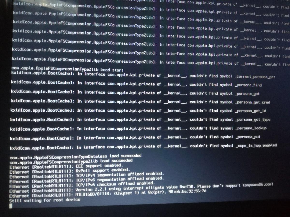

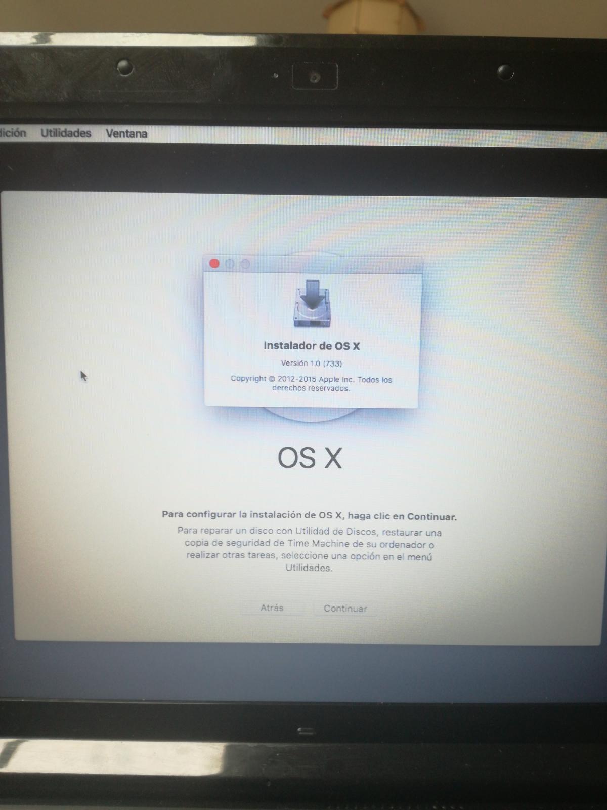

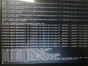

BadWolfAlfa Posted March 4, 2017 Share Posted March 4, 2017 Hello I have a big problem (image attached for see) I use a installation of Sierra with Chameleon Legacy Bios on my computer but at load the installer USB have a Kernel Panic I attached the EXTRA-Folder of Sierra USB and the EXTRA-Folder of my working Yosemite... with DSDT and etc... I tried commom flags: npci=0x2000, 0x3000, and GraphicsEnabler=No nv_disable=1, etc etc... i dont know the reasson In another test's i passed the Kernel Panic, but stay on "still waiting for root device" and never load, tried for fix that rd=disk0s2 (partition with Mac Installer) but nothing.... ¿If any help me please? i tried the five last day's and nothing.... My laptop specs are: 1. Model: Asus K50IN 2. Processor: Intel® Core2 Duo CPU T4300 (SSE 2, SSE 3) 3. Southbridge: MCP79 4. Graphics card: NVIDIA GeForce G102M 5. Audio: ALC662 6. LAN: RTL8111/8168B 7. WLAN: Atheros AR9285 8. HDD and Optical disc recorder - SATA 9. Keyboard and touchpad - PS/2 10. Webcam: Chicony CNF7129 11. Card reader: Alcor AU6433 Thanks in advance!!! Sorry my bad english im from spain... EXTRA-Sierra.zip EXTRA-Yosemite.zip Link to comment https://www.insanelymac.com/forum/topic/321623-asus-k50in-sierra-kernel-panic-help-el-capitan-%E2%99%A5/ Share on other sites More sharing options...
nawcom Posted March 4, 2017 Share Posted March 4, 2017 First off, it looks like you don't have a Core 2 Duo CPU - you have a Pentium CPU assuming T4300 is the correct model. That's just what Intel calls their lower performing CPUs these days. Regardless, it doesn't support SSE4.1/4.2 instructions that Sierra requires so you cannot run Sierra on this laptop. Sorry No kernel has been made yet that can emulate these instructions. 1 Link to comment https://www.insanelymac.com/forum/topic/321623-asus-k50in-sierra-kernel-panic-help-el-capitan-%E2%99%A5/#findComment-2377748 Share on other sites More sharing options...
BadWolfAlfa Posted March 4, 2017 Author Share Posted March 4, 2017 First off, it looks like you don't have a Core 2 Duo CPU - you have a Pentium CPU assuming T4300 is the correct model. That's just what Intel calls their lower performing CPUs these days. Regardless, it doesn't support SSE4.1/4.2 instructions that Sierra requires so you cannot run Sierra on this laptop. Sorry No kernel has been made yet that can emulate these instructions. It's dualcore, but not support SSE4.1 And El Capitan? need SSE4,1? I only have SSE3 And in El Capitan installation i stoped on: "Waiting For Root Device" no kernel Panic.... attached screen of "El Capitan" installer error... Link to comment https://www.insanelymac.com/forum/topic/321623-asus-k50in-sierra-kernel-panic-help-el-capitan-%E2%99%A5/#findComment-2377793 Share on other sites More sharing options...
nawcom Posted March 4, 2017 Share Posted March 4, 2017 Waiting for root device means you lack driver support for whatever controller your boot media connects to. If you're trying to boot USB install media then you have to fix USB support. This is pretty common with 10.11 and newer because they updated their USB kexts. Thread for fixing USB in 10.11: http://www.insanelymac.com/forum/topic/306777-guide-usb-fix-el-capitan-1011/ There's also USBInjectall.kext you can try out but you'll need to rename your USB devices in DSDT to EH01/EH02. This can be patched in Clover but if you want to use Chameleon then you'll have to manually patch your DSDT. Feel free to upload it and I can take a look. Link to comment https://www.insanelymac.com/forum/topic/321623-asus-k50in-sierra-kernel-panic-help-el-capitan-%E2%99%A5/#findComment-2377818 Share on other sites More sharing options...
BadWolfAlfa Posted March 4, 2017 Author Share Posted March 4, 2017 Waiting for root device means you lack driver support for whatever controller your boot media connects to. If you're trying to boot USB install media then you have to fix USB support. This is pretty common with 10.11 and newer because they updated their USB kexts. Thread for fixing USB in 10.11: http://www.insanelymac.com/forum/topic/306777-guide-usb-fix-el-capitan-1011/ There's also USBInjectall.kext you can try out. Hi! i tried the USBInjectall.kext without success... For now i need make the new the El Capitan USB Thanks a lot !!! After i make the USB i try and comment! Link to comment https://www.insanelymac.com/forum/topic/321623-asus-k50in-sierra-kernel-panic-help-el-capitan-%E2%99%A5/#findComment-2377826 Share on other sites More sharing options...
nawcom Posted March 4, 2017 Share Posted March 4, 2017 Heh I forgot to mention the need to rename the devices so I edited my post and it looks like you missed it. Like I said feel free to upload your DSDT and I can look. edit: Also since you're using an MCP79 laptop I'd suggest using MacBookPro5,1 or MacBookPro5,2 as the model in smbios.plist since they were their MCP79 models. Looks like their MCP79 MacBook Pro models go up to 5,5 but 5,1 should be fine for using here. Link to comment https://www.insanelymac.com/forum/topic/321623-asus-k50in-sierra-kernel-panic-help-el-capitan-%E2%99%A5/#findComment-2377833 Share on other sites More sharing options...
BadWolfAlfa Posted March 4, 2017 Author Share Posted March 4, 2017 Heh I forgot to mention the need to rename the devices so I edited my post and it looks like you missed it. Like I said feel free to upload your DSDT and I can look. edit: Also since you're using an MCP79 laptop I'd suggest using MacBookPro5,1 or MacBookPro5,2 as the model in smbios.plist since they were their MCP79 models. Nice i try the MBP5,2 Now i making The USB This is my dsdt (from Yosemite) Any failure are the Keyboard And Mouse, no work under installer... of El Capitan (no remember with make for finally boot) Attached in zip: dsdt.aml, kernel.plist, chameleon config and my actual smbios asusk50in.zip Link to comment https://www.insanelymac.com/forum/topic/321623-asus-k50in-sierra-kernel-panic-help-el-capitan-%E2%99%A5/#findComment-2377847 Share on other sites More sharing options...

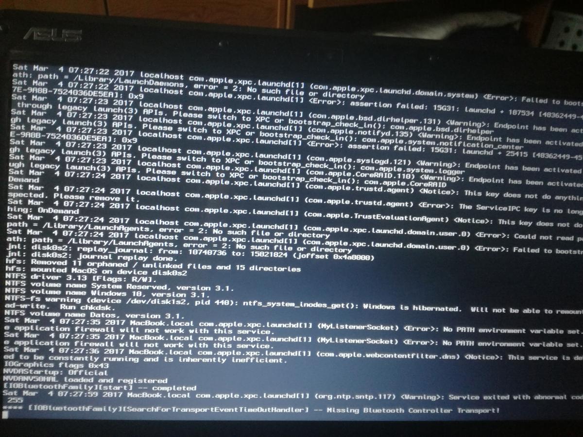

BadWolfAlfa Posted March 4, 2017 Author Share Posted March 4, 2017 Ok for now i have working the installer, but no work TouchPad(and i have USB mouse and dont work) The keyboard works but no mouse 1 Link to comment https://www.insanelymac.com/forum/topic/321623-asus-k50in-sierra-kernel-panic-help-el-capitan-%E2%99%A5/#findComment-2378105 Share on other sites More sharing options...

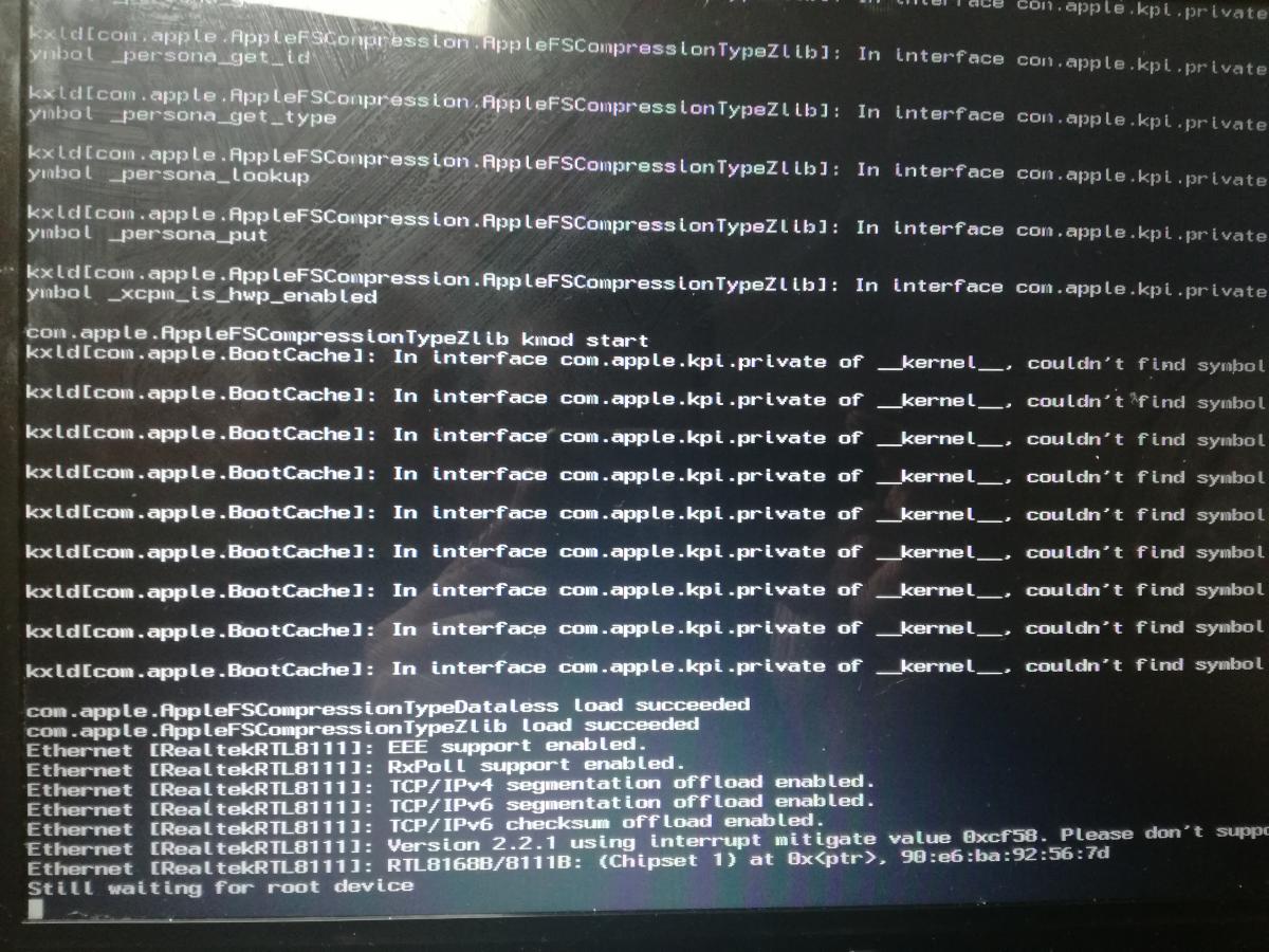

BadWolfAlfa Posted March 5, 2017 Author Share Posted March 5, 2017 Now i have this problem... Still waiting for root device (used dsdt, smbios and usbinjectall) After reworked USB... And yes it's el capitan Link to comment https://www.insanelymac.com/forum/topic/321623-asus-k50in-sierra-kernel-panic-help-el-capitan-%E2%99%A5/#findComment-2378232 Share on other sites More sharing options...
BadWolfAlfa Posted March 5, 2017 Author Share Posted March 5, 2017 After update kext of Ethernet and IOFamily Same still waiting for root device 1 Link to comment https://www.insanelymac.com/forum/topic/321623-asus-k50in-sierra-kernel-panic-help-el-capitan-%E2%99%A5/#findComment-2378247 Share on other sites More sharing options...

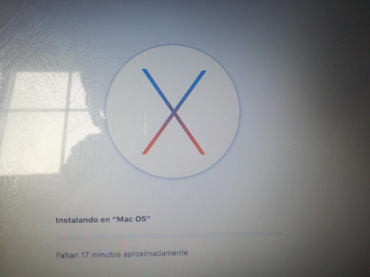

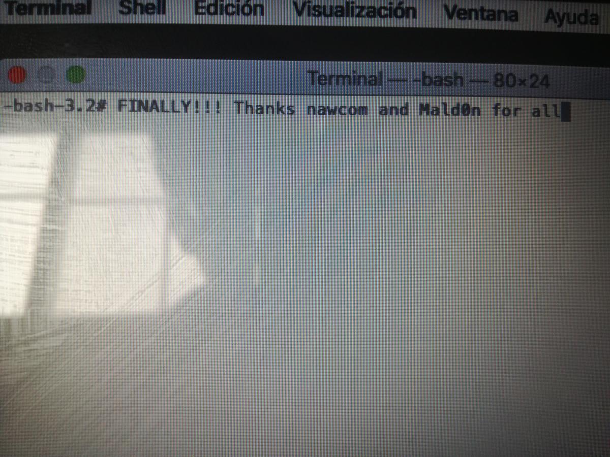

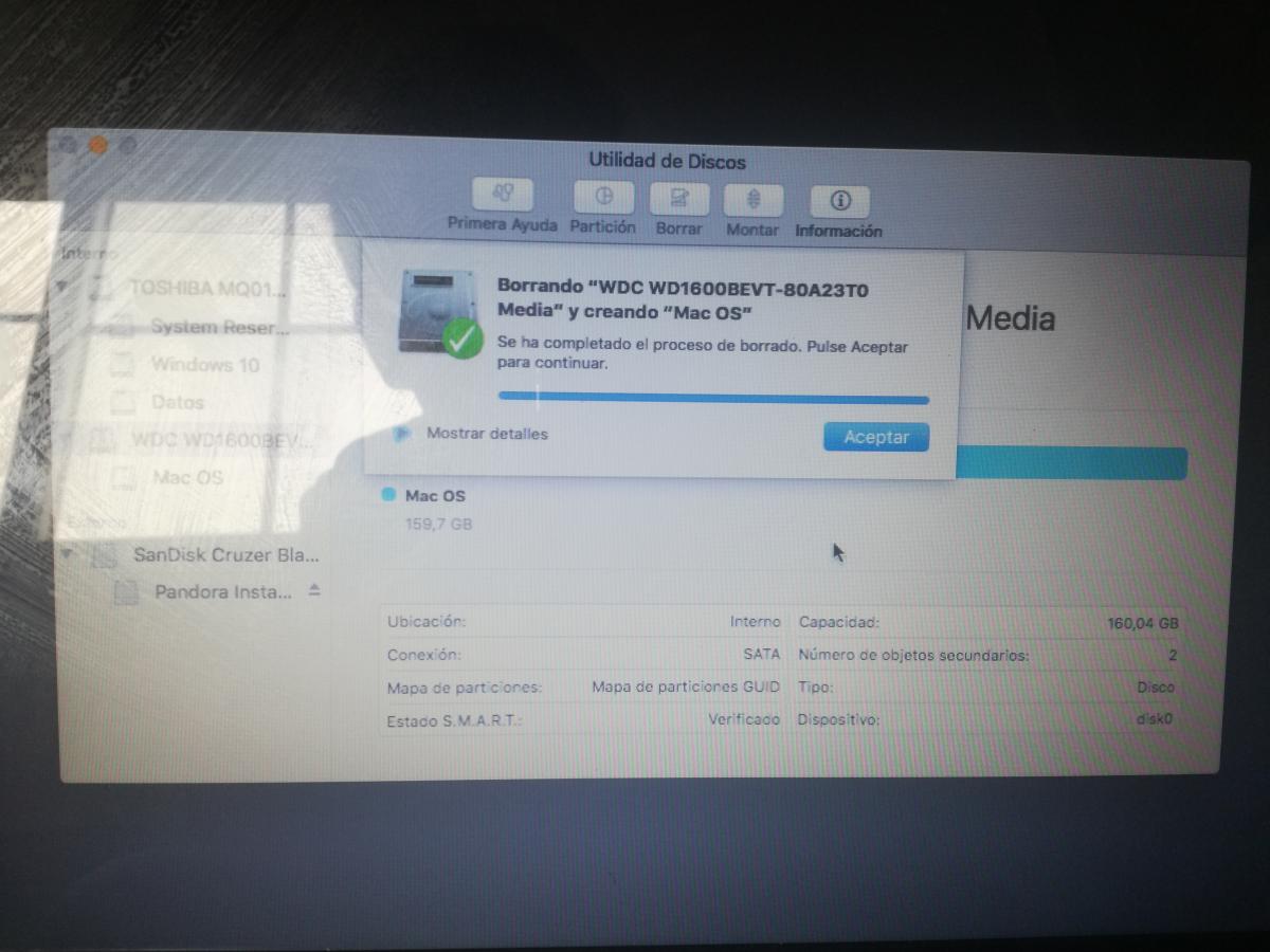

BadWolfAlfa Posted March 5, 2017 Author Share Posted March 5, 2017 Using Pandora Box's for make the installer works perfect, used your's dsdt and your's flags, now installing in HDD im Happy finally booted, thanks to all♥ In few hours or tomorrow i open a post for help in installation in this computer And add proper credits of course!!!! Now are installing in theory works ^^ 1 Link to comment https://www.insanelymac.com/forum/topic/321623-asus-k50in-sierra-kernel-panic-help-el-capitan-%E2%99%A5/#findComment-2378346 Share on other sites More sharing options...
