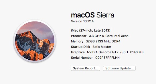

Edkroket Posted February 22, 2017 Share Posted February 22, 2017 Hi, I was struggling to get all my USB-3 ports running on the right speed and get rid of the portlimit patch. Now I have it perfectly working and running on 10.12.3. In my attachment I have the kext files, clover config files en SSDT for USB and the BIOS settings for F23C. Remove any previous versions of USB injectors and SSDT files. Install the kext in S/L/E Use my config file for DSDT edits for EHCI and XHC Use the BIOS settings as in my screenshots And you should be good to go. No need for port limit patch and waste unused ports and power. Big thanks and credit goes to RehabMan. He made the kext and how-to. I just did the job on my system. I was thinking to share this because I know you are never alone with an issue. :-) Ed X99-UD5-WIFI-F23C.zip 1 Link to comment https://www.insanelymac.com/forum/topic/321384-x99-ud5-wifi-usb3-all-working/ Share on other sites More sharing options...

Edkroket Posted September 27, 2017 Author Share Posted September 27, 2017 Hi indeed sometimes the RAM needs a bit more than 1.2 V. Specially when overclocking. I had in many cases set it for both A en B slots to 1.25 or 1.26 V Not sure what GPU you use but with the 980 TI I had also some more trouble. But in general these are fast machines and great to work with. I've build a dozen of them for my customers. If you need Thunderbolt PCI-Card I still have a few of them. Cheers! Link to comment https://www.insanelymac.com/forum/topic/321384-x99-ud5-wifi-usb3-all-working/#findComment-2501485 Share on other sites More sharing options...
