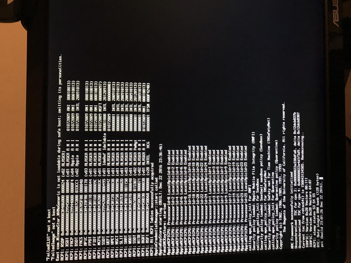

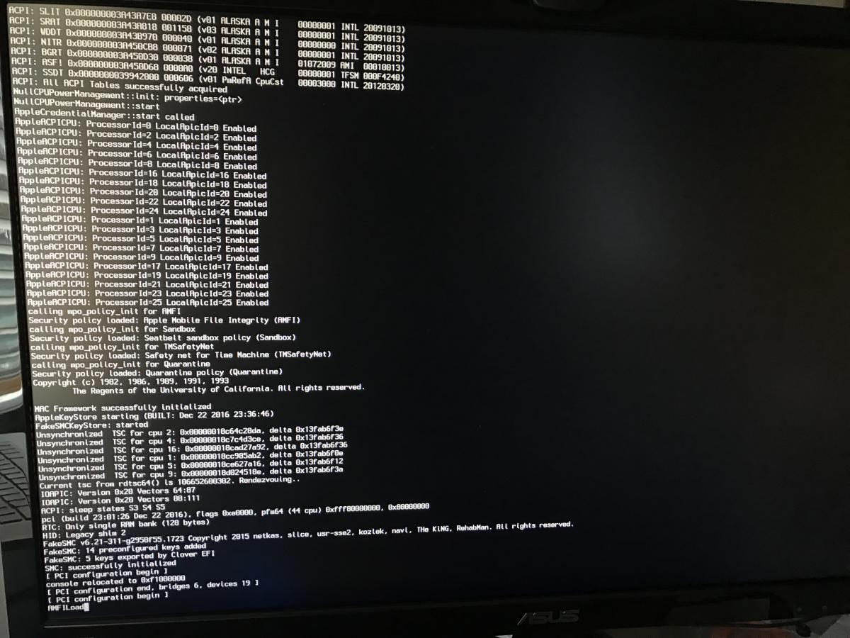

rafamundez Posted February 17, 2017 Share Posted February 17, 2017 Hey guys! Running into some problems with my x99 build and hoping someone can help:) I've been following a mix of x99 guides (found both here and tonymacx86) to no success thus far. The furthest I have gotten is a hang up on AMFILoad after [ PCI Configuration Begin ] as seen below Obviously the first error is that it hangs on AMFILoad. I haven't had much luck in finding out what I need to change/fix to get past this. The other error is "Unsynchronized TSC for CPU" (also seen in that screenshot). That one seems more likely to be an issue with the VoodooTSCSync kext but I'm not quite sure why as I have literally just used someone else's (successful) voodoo kext who modified it for the i7 6950x (which is the processor I have) using @Brumbaer's patch where you simply change the IOCPUNumber to 19 (10 cores, 20 threads, subtract 1 from 20 to get the 19) in the kext. I also have a successful Windows 10 boot on a different SSD so I extracted the DSDT.bin and SSDT.bin with RW Everything, converted them to DSDT.aml and SSDT.aml and placed them in the EFI>CLOVER>ACPI>patched folder. Currently, I'm also running it with 1 single 16 GB stick of RAM (and not the full 96 GB of RAM). Additionally, I have tried various usb sticks and usb ports with no additional success. Any and all help would be much appreciated on this issue as I'm pretty much totally stuck Let me know if there is any additional information I can provide or upload, etc. 1 Link to comment Share on other sites More sharing options...
MaLd0n Posted March 2, 2017 Share Posted March 2, 2017 u try with npci=0x2000 lga 2011 v3 need it if u dont patch DSDT = no diference, dont use if u dont patch Link to comment Share on other sites More sharing options...

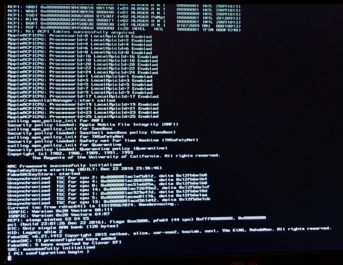

mfc88 Posted March 3, 2017 Share Posted March 3, 2017 Hey guys! Running into some problems with my x99 build and hoping someone can help:) I've been following a mix of x99 guides (found both here and tonymacx86) to no success thus far. The furthest I have gotten is a hang up on AMFILoad after [ PCI Configuration Begin ] as seen below IMG_0214.JPG Obviously the first error is that it hangs on AMFILoad. I haven't had much luck in finding out what I need to change/fix to get past this. The other error is "Unsynchronized TSC for CPU" (also seen in that screenshot). That one seems more likely to be an issue with the VoodooTSCSync kext but I'm not quite sure why as I have literally just used someone else's (successful) voodoo kext who modified it for the i7 6950x (which is the processor I have) using @Brumbaer's patch where you simply change the IOCPUNumber to 19 (10 cores, 20 threads, subtract 1 from 20 to get the 19) in the kext. I also have a successful Windows 10 boot on a different SSD so I extracted the DSDT.bin and SSDT.bin with RW Everything, converted them to DSDT.aml and SSDT.aml and placed them in the EFI>CLOVER>ACPI>patched folder. Currently, I'm also running it with 1 single 16 GB stick of RAM (and not the full 96 GB of RAM). Additionally, I have tried various usb sticks and usb ports with no additional success. Any and all help would be much appreciated on this issue as I'm pretty much totally stuck Let me know if there is any additional information I can provide or upload, etc. Try not to use any CPU PW when you first install. I didn't. I removed all my SSDTs/DSDT from my ACPI patched folder and only used Clover patches (5960x patch, USB 15 to 21 port patch, reboot fix patch and a DSDT patch for USB XCHI => XHC). Try to eliminate as many variables as possible. Here's my install usb efi... EFI.zip Link to comment Share on other sites More sharing options...

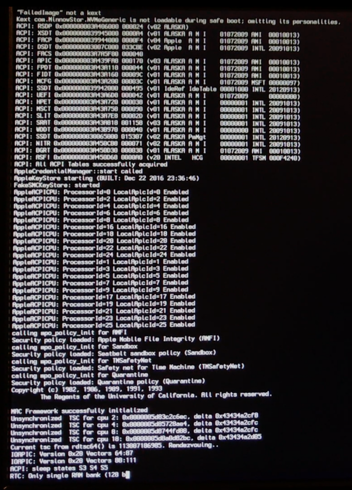

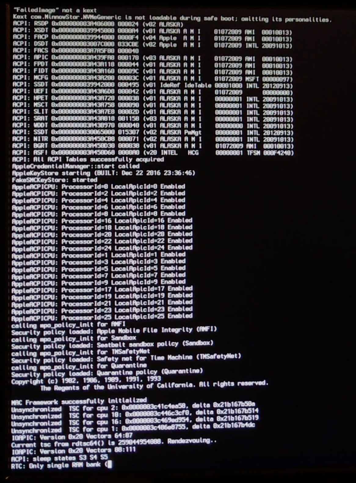

rafamundez Posted March 4, 2017 Author Share Posted March 4, 2017 Just tried the EFI you sent me @mfc88 and it looks like I hit the " RTC: Only single RAM bank (128 bytes) " hang/error: Any ideas on what I should change to get past that? Thanks again! Link to comment Share on other sites More sharing options...
mfc88 Posted March 4, 2017 Share Posted March 4, 2017 Just tried the EFI you sent me @mfc88 and it looks like I hit the " RTC: Only single RAM bank (128 bytes) " hang/error: IMG_0223.JPG Any ideas on what I should change to get past that? Thanks again! If you're using a DSDT.aml/SSDT.aml, don't. Remove it. Link to comment Share on other sites More sharing options...

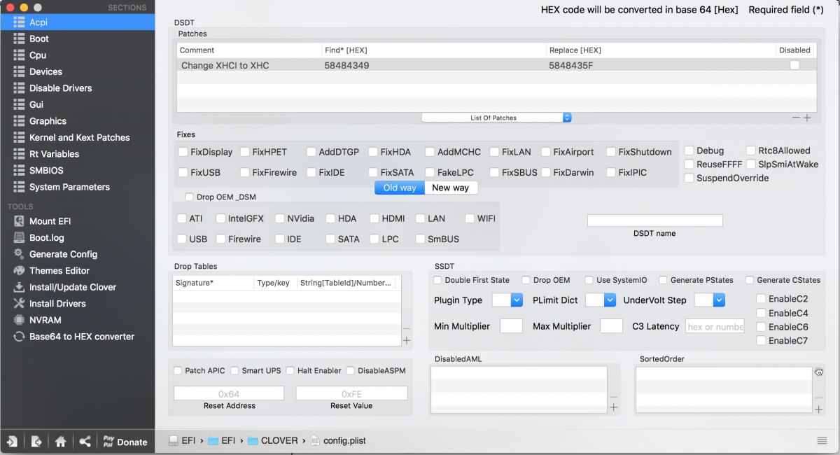

rafamundez Posted March 5, 2017 Author Share Posted March 5, 2017 If you're using a DSDT.aml/SSDT.aml, don't. Remove it. Nope. Not using a DSDT.aml or SSDT.aml. I'm attaching a screenshot (below) of the Acpi page from the clover configurator of the config.plist from the EFI you sent (that is what I was using). Are there any changes I should make? Thanks again!!!! Link to comment Share on other sites More sharing options...
mfc88 Posted March 5, 2017 Share Posted March 5, 2017 Nope. Not using a DSDT.aml or SSDT.aml. I'm attaching a screenshot (below) of the Acpi page from the clover configurator of the config.plist from the EFI you sent (that is what I was using). Are there any changes I should make? Screen Shot 2017-03-05 at 1.40.56 PM.png Thanks again!!!! Try this... (for you, under "new way" tab). Link to comment Share on other sites More sharing options...

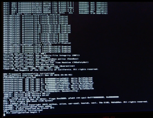

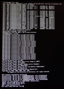

rafamundez Posted March 5, 2017 Author Share Posted March 5, 2017 So I tried FIX_RTC and still ran into the " RTC: Single RAM Bank (128 b " error (the last word was cut off as seen from the screenshot). I tried it again and got the same error except the last few lines were different (see the screenshot). I also tried using the HDMI port instead of the DVI-D port got the " RTC: Single RAM Bank (128 bytes) " error but it got past it to " [ PCI Configuration Begin ] " hang. So I'm not sure what exactly causes these errors and why having the monitor plugged into either the DVI-D port or HDMI would make a difference. Thanks again for any and all help!!! Link to comment Share on other sites More sharing options...
