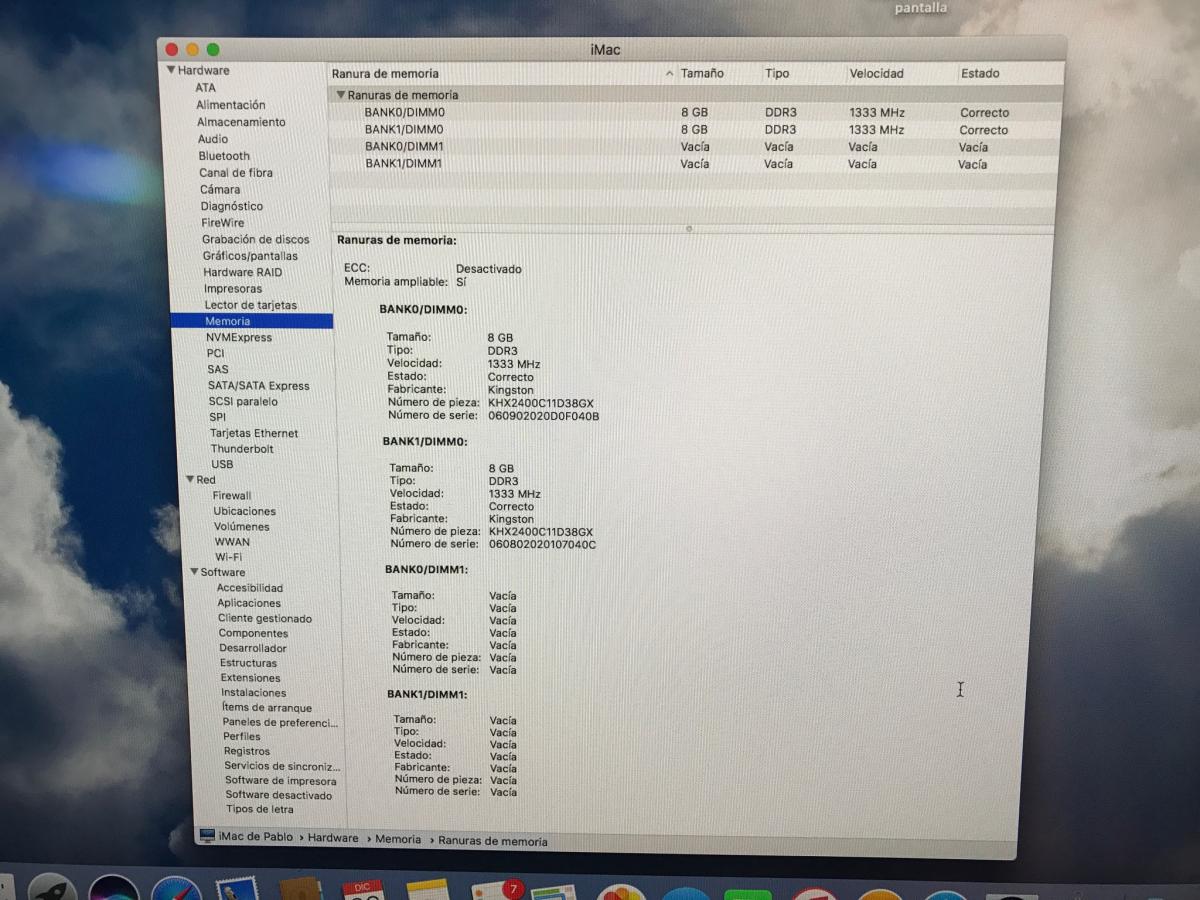

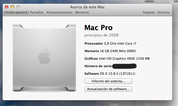

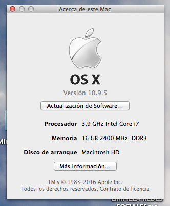

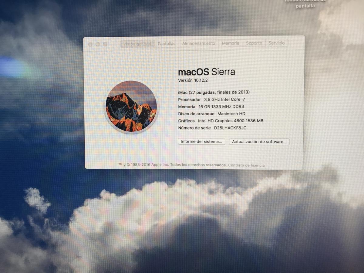

srmusico Posted February 15, 2017 Share Posted February 15, 2017 hello im trying to install sierra into my fully stable Mavericks system.I have a Gigabyte Z87X-UD3H , i7 4770k , 16 gb Kingston 2400 MHz .Clean Install. I have the following issues: 1- In "About this Mac" i have i7 proccesor at 3,5 ghz (in mavericks i have 3,9 ghz ).and 16 gb of ram at 1333 MHz (2400 MHz in mavericks) 2- I can't boot without the USB installer.I have installed the bootloader in the ssd, but it freeze when i try to boot without the pendrive. What can I do? Thanks for the help! Link to comment https://www.insanelymac.com/forum/topic/321182-gigabyte-z87x-ud3h-sierra-problems/ Share on other sites More sharing options...
MaLd0n Posted February 15, 2017 Share Posted February 15, 2017 Extract ur DSDT and put here use it RunMe.app.zip about this mac, 3.9 is a turbo boost clock, 3.5 its normal memory, only cosmectic, but u can edit in config.plist if u like 1 Link to comment https://www.insanelymac.com/forum/topic/321182-gigabyte-z87x-ud3h-sierra-problems/#findComment-2368461 Share on other sites More sharing options...

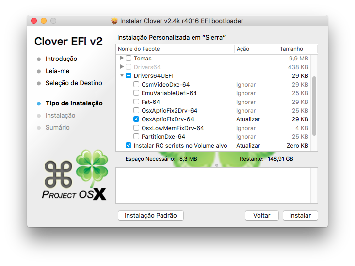

MaLd0n Posted February 21, 2017 Share Posted February 21, 2017 use a fresh install, instal clover uefi mode and replace full folder CLOVER.zip 1 Link to comment https://www.insanelymac.com/forum/topic/321182-gigabyte-z87x-ud3h-sierra-problems/#findComment-2370848 Share on other sites More sharing options...
srmusico Posted February 21, 2017 Author Share Posted February 21, 2017 Hello MaLd0n ! Thanks for your help. Im going to try it now. By the way,... Im new with Clover and this amazing comunity of insanelymac ,I always used Chimera for customacs. And recently Im trying to discover more and more about this boot loader. Do you know a post where can I learn the most important concepts about this boot loader ? thanks you so much again!! Link to comment https://www.insanelymac.com/forum/topic/321182-gigabyte-z87x-ud3h-sierra-problems/#findComment-2370920 Share on other sites More sharing options...
MaLd0n Posted February 21, 2017 Share Posted February 21, 2017 ur mobo is UEFI install clover with options see and after, replace folder with new Clover folder i sent u reboot about Clover https://clover-wiki.zetam.org/Configuration the amazin' bootloader 1 Link to comment https://www.insanelymac.com/forum/topic/321182-gigabyte-z87x-ud3h-sierra-problems/#findComment-2370944 Share on other sites More sharing options...

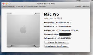

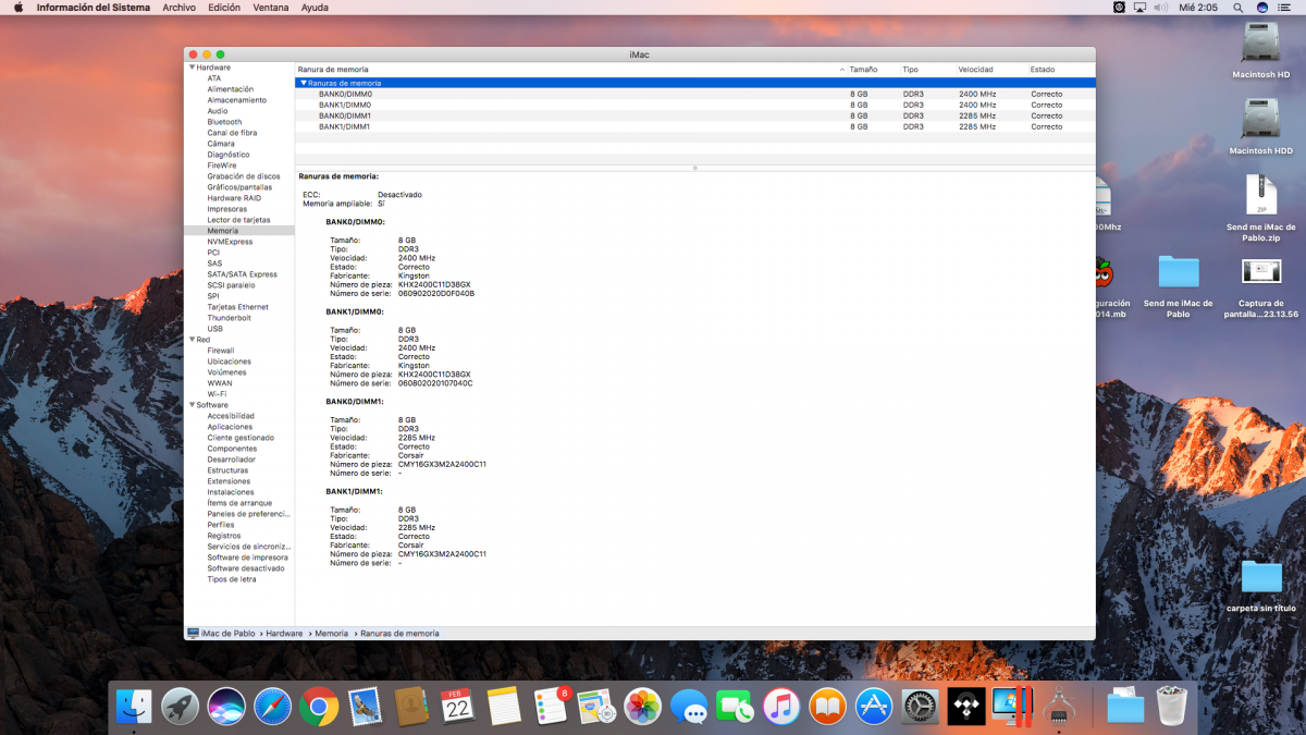

srmusico Posted February 22, 2017 Author Share Posted February 22, 2017 Hello Again!. Okey I have been reading more about Clover and how it works. The differences between Chimera etc... I have done correctly the change and It seems that works at first time: -The Kingston Hyperx Ram Say 2400Mhz but Corsair Ram say 2285Mhz -It could be possible to say that I have a Mac Pro (5,1-6,1)?? Or could I have instability or incompatibility problems? -The boot time is working fine but verbose without boot animation . - I dont know if is correct, but I think that I see a bit of freeze when I move a finder window. How could I know if my graphics are 100% fully working ? im using integrated graphics (Intel HD Graphics 4600 ) with my monitor Asus MX239 (24" 1920 x 1080p) All the other seems to be working fine. (USB 3.0,Ethernet, Firewire PCi Card, ...) Thanks you so much with your help again bro! PD: Could I know how to edit this system info about the system? im really grateful with your help! 1 Link to comment https://www.insanelymac.com/forum/topic/321182-gigabyte-z87x-ud3h-sierra-problems/#findComment-2371095 Share on other sites More sharing options...
MaLd0n Posted February 22, 2017 Share Posted February 22, 2017 -The Kingston Hyperx Ram Say 2400Mhz but Corsair Ram say 2285Mhz only cosmetic, no problem -It could be possible to say that I have a Mac Pro (5,1-6,1)?? Or could I have instability or incompatibility problems? use iMac14,2 - I dont know if is correct, but I think that I see a bit of freeze when I move a finder window. How could I know if my graphics are 100% fully working ? im using integrated graphics (Intel HD Graphics 4600 ) with my monitor Asus MX239 (24" 1920 x 1080p) intel HD but i think have patch, wait me NOW u need generate ur SSDT with pike script Run it ssdtPRGen.command.zip save with .dsl extension and compile, .aml if u dont know about it, post here .txt https://github.com/Piker-Alpha/ssdtPRGen.sh 1 Link to comment https://www.insanelymac.com/forum/topic/321182-gigabyte-z87x-ud3h-sierra-problems/#findComment-2371098 Share on other sites More sharing options...

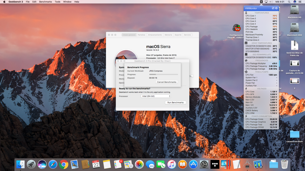

srmusico Posted February 25, 2017 Author Share Posted February 25, 2017 Hello MaLd0n, sorry for the delay. Im having issues with the temperature of the processor.... but this is other issue.... this is the file thanks you so much for your help bro ssd.dsl.zip 1 Link to comment https://www.insanelymac.com/forum/topic/321182-gigabyte-z87x-ud3h-sierra-problems/#findComment-2372940 Share on other sites More sharing options...

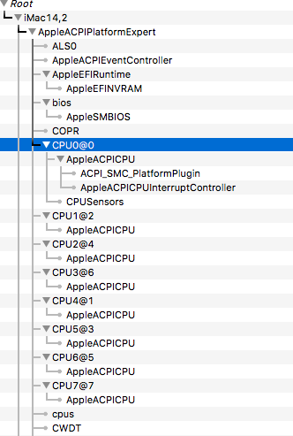

MaLd0n Posted February 25, 2017 Share Posted February 25, 2017 what the problem u have? the SSDT generate by pike's script, compile and put in same folder with DSDT --> CLOVER/ACPI/PATCHED SSDT.aml.zip Very good work send me ioreg extract with ioreg explorer IORegistryExplorer 3.app.zip 1 Link to comment https://www.insanelymac.com/forum/topic/321182-gigabyte-z87x-ud3h-sierra-problems/#findComment-2372966 Share on other sites More sharing options...

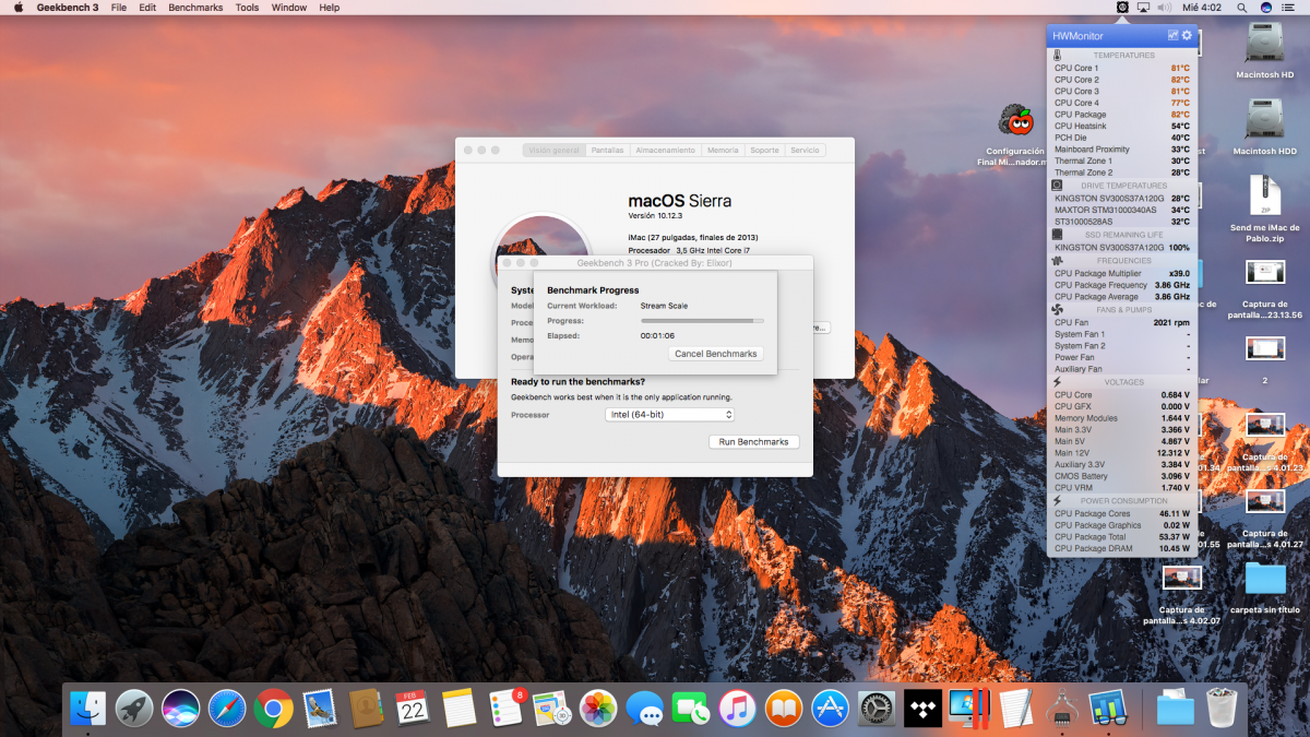

srmusico Posted February 25, 2017 Author Share Posted February 25, 2017 the problem with the temperature is my CPU it have the stock CPU cooler from the intel box (with new termic paste that I have changed correctly yesterday) but looking at the Bios sensor, it turns with no S.O. 55-56ºC. The cpu is clean, the cooler too, the space is in a good ambient temperature the cooler works well and I tested changing the processor to other motherboard that I have (from a friend computer that im upgrading to a SSD) and the same issue it turns really hot. (so its not a problem of the motherboard...) Testing the computer the other day with Geekbench it turns really hot (with HW Monitor) The cpu its working normally and without overclock .... I dont know whats happening jajaja 81ºC Maaan? its really crazy and unsure no? iMac de Pablo.zip 1 Link to comment https://www.insanelymac.com/forum/topic/321182-gigabyte-z87x-ud3h-sierra-problems/#findComment-2372973 Share on other sites More sharing options...

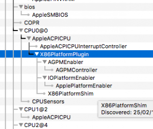

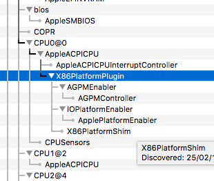

MaLd0n Posted February 25, 2017 Share Posted February 25, 2017 put ssdt into folder Clover/Acpi/Patched http://www.insanelymac.com/forum/index.php?app=core&module=attach§ion=attach&attach_id=220662 after reboot, send me new ioreg ur PM dont work use it Intel® Power Gadget v3.0.3.dmg.zip but with geekbench test, the temp is high, stock cooler intel, 70 or 80 c...normal Replace DSDT too. i apply FIREWIRE, IMEI and LAN DSDT.srmusico 02.zip Patches Fix errors and warnings Hpet Darwin Sata Dtgp Slpb Als0 Lpc XHC Hdef Irqs Smbus Bus1 Shutdown Mchc Lan Firewire Pnlf Imei Names in PCI Devices 1 Link to comment https://www.insanelymac.com/forum/topic/321182-gigabyte-z87x-ud3h-sierra-problems/#findComment-2372976 Share on other sites More sharing options...
srmusico Posted February 25, 2017 Author Share Posted February 25, 2017 Okey, i have done. this is the new report. thanks iMac de Pablo New.zip 1 Link to comment https://www.insanelymac.com/forum/topic/321182-gigabyte-z87x-ud3h-sierra-problems/#findComment-2373008 Share on other sites More sharing options...
MaLd0n Posted February 25, 2017 Share Posted February 25, 2017 load now see 1 Link to comment https://www.insanelymac.com/forum/topic/321182-gigabyte-z87x-ud3h-sierra-problems/#findComment-2373012 Share on other sites More sharing options...
srmusico Posted February 25, 2017 Author Share Posted February 25, 2017 Hello MaLd0n, but I don't understand, what is PM? and what do you changed that wasn't working? thanks again! PD: Clever is still botting without apple logo. All is text (in chameleon was verbose mode ,but I don't know how to change it in clever) how can I change it bro? 1 Link to comment https://www.insanelymac.com/forum/topic/321182-gigabyte-z87x-ud3h-sierra-problems/#findComment-2373539 Share on other sites More sharing options...
MaLd0n Posted February 25, 2017 Share Posted February 25, 2017 PM = power management send me ur config.plist, verbose mode is activate 1 Link to comment https://www.insanelymac.com/forum/topic/321182-gigabyte-z87x-ud3h-sierra-problems/#findComment-2373557 Share on other sites More sharing options...

MaLd0n Posted February 25, 2017 Share Posted February 25, 2017 thats good, work config.plist.zip temp i dont use stock cooler, the temp is high 10c + i'm used Hyper T4 (RR-T4-18PK-R1) CoolerMaster A good cost benefit 1 Link to comment https://www.insanelymac.com/forum/topic/321182-gigabyte-z87x-ud3h-sierra-problems/#findComment-2373584 Share on other sites More sharing options...
srmusico Posted February 26, 2017 Author Share Posted February 26, 2017 oh, thats cool . look at this. im a music producer. this Mac is the center of all my machines of the studio. At this moment this is the "beta installation" of all of this. im working with mavericks in other SSD. I need to get this 100% stable to then try all my plugins to work correctly with Logic Pro X and Final Cut Pro X jajajaja. The temperature issue I think that is not from the OS. Because in the bios menu says a high temperature too A friend said me to install a Corsair liquid cooler.. but is so so expensive for a simple cooler bro jajajaja. Do you think that I need this cooler for my works or will be okey with one like the Hyper T4? -About the installations seems that everything is working. But im still saying that I think that the graphics aren´t fine I feel a little "lag" when I move a window or when I change the desktop (like a little freeze). I have too my Mac Book Pro Late 2013 13". And at this moment I going to do a clean install In there to compare. ( I can do a screen recording to show you) -The other last thing that I want to configure is finally Clever. When I turn on the power, I need to wait to enter Clover, and then 5 seconds to enter into the Mac HD. Is there any possibility to create a kind of "fast boot" to enter directly into the HD? If is not possible, it will be ok to jaja PD. I have change the Gigabyte Motherboard screen that appears when you boot the computer; to the apple black logo . And wow the feeling is really cool, like a normal Mac jajaja (only need the boot sound ) . One more time , thanks you so much for all this days that you are helping me. This forum is really fantastic. Sorry if I am boring you bro, but I really need a stable machine 1 Link to comment https://www.insanelymac.com/forum/topic/321182-gigabyte-z87x-ud3h-sierra-problems/#findComment-2373807 Share on other sites More sharing options...

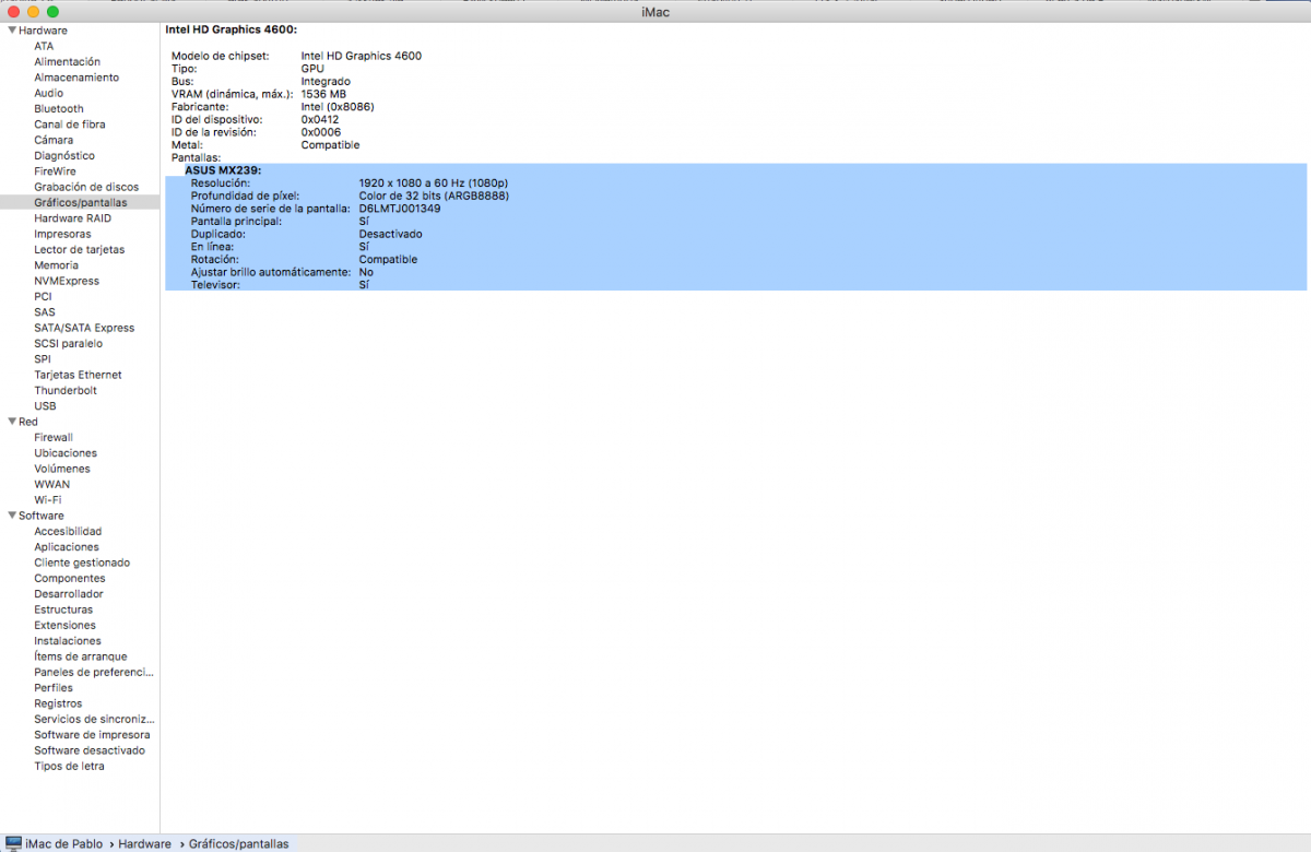

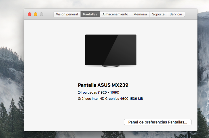

MaLd0n Posted February 26, 2017 Share Posted February 26, 2017 ur Mac Book Pro Late 2013 have intelhd too, but resolution...i think is low, not a full hd. check it ur hackintosh use fullhd resolution? back to home i sent new config.plist for u *EDIT try it config.plist.zip and replace dsdt too DSDT.03.zip 1 Link to comment https://www.insanelymac.com/forum/topic/321182-gigabyte-z87x-ud3h-sierra-problems/#findComment-2373915 Share on other sites More sharing options...
srmusico Posted February 26, 2017 Author Share Posted February 26, 2017 How can I know it MaLd0n? Im using an Asus MX239 connected with Dvi (I have too HDMI, but at this moment is connected With DVI) Im going to try the new configs that you sent me Thanks! 1 Link to comment https://www.insanelymac.com/forum/topic/321182-gigabyte-z87x-ud3h-sierra-problems/#findComment-2374169 Share on other sites More sharing options...
MaLd0n Posted February 26, 2017 Share Posted February 26, 2017 ofc in fullhd or high, intelhd 4xxx not the best GPU but work Link to comment https://www.insanelymac.com/forum/topic/321182-gigabyte-z87x-ud3h-sierra-problems/#findComment-2374200 Share on other sites More sharing options...

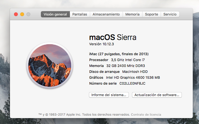

srmusico Posted February 26, 2017 Author Share Posted February 26, 2017 okey. I changed the files. 2 last questions MaLd0n -What graphic card do you recommend for this machine? And about the processor, it seems that is 3,5. (in mavericks was 3,9 because of the turbo boost I think) Is the turbo boost working in this system? or im limited only to 3,5ghz without the turbo boost? thanks again 1 Link to comment https://www.insanelymac.com/forum/topic/321182-gigabyte-z87x-ud3h-sierra-problems/#findComment-2374250 Share on other sites More sharing options...
