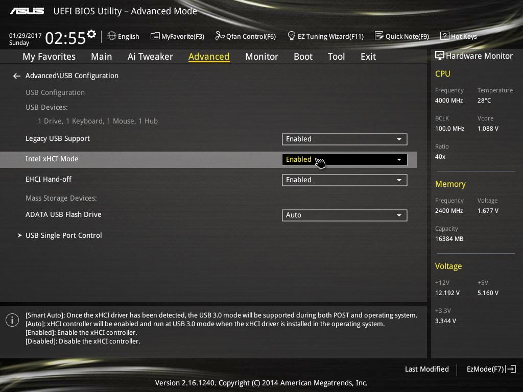

hi, i'm glad to install mac OS with hackintosh.
All functions are perfect, but it can't wake up from sleep.
Here are my computer specs:
  • MB : ASUS z97-a usb3.1
  • CPU : Intel i7-4790k
  • GPU : null
  • RAM : 16GB
  • SSD : Samsung 850evo 250GB (OS X boot)
  • HD : 3TB (storage)
  • Bootloader : Clover v2.3k r3766 UEFI Boot Mode

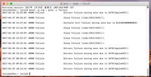

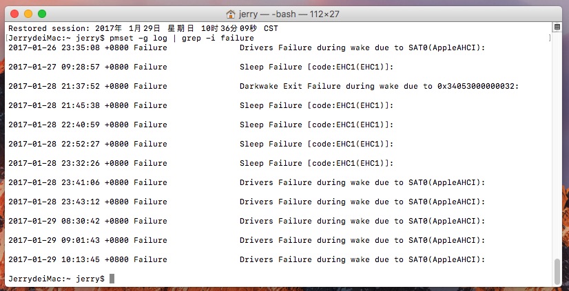

some logs:
2017-01-28 23:41:06 +0800 Failure             	Drivers Failure during wake due to SAT0(AppleAHCI):
2017-01-28 23:43:12 +0800 Failure             	Drivers Failure during wake due to SAT0(AppleAHCI):
2017-01-29 08:30:42 +0800 Failure             	Drivers Failure during wake due to SAT0(AppleAHCI):
2017-01-29 09:01:43 +0800 Failure             	Drivers Failure during wake due to SAT0(AppleAHCI):
2017-01-29 10:13:45 +0800 Failure             	Drivers Failure during wake due to SAT0(AppleAHCI):

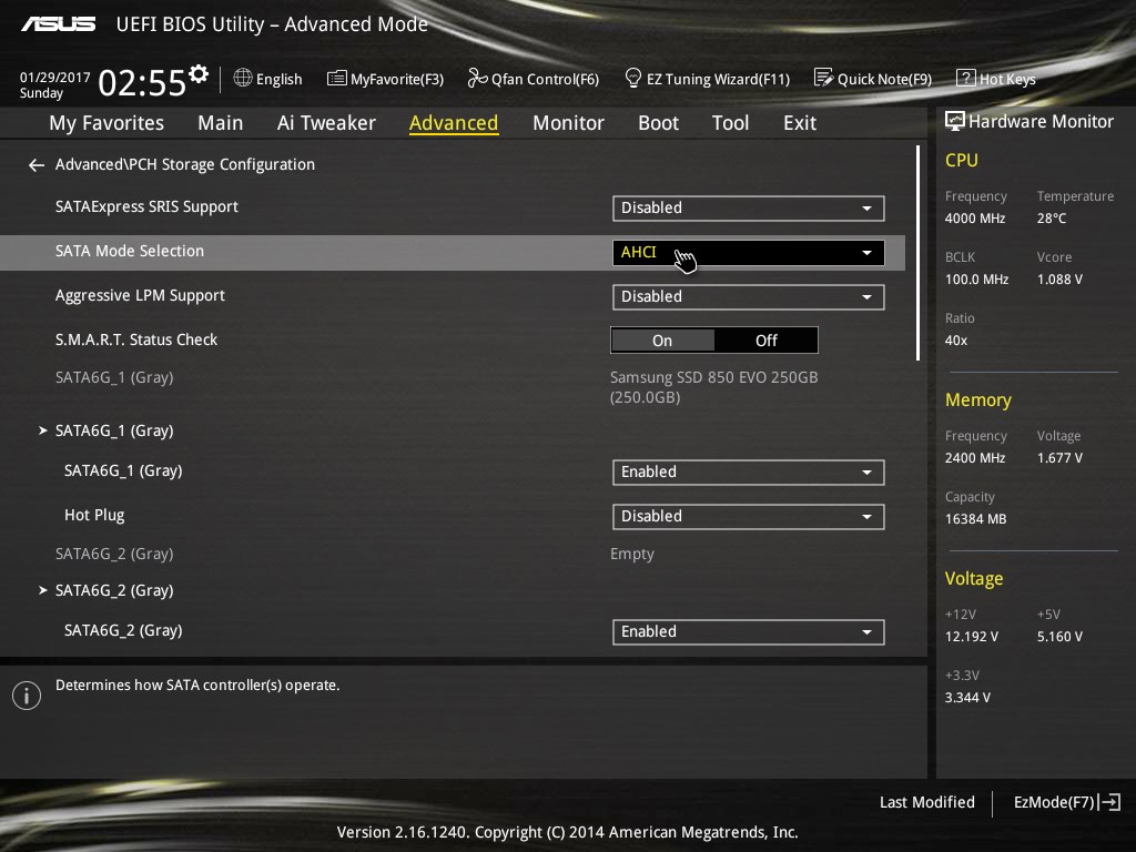

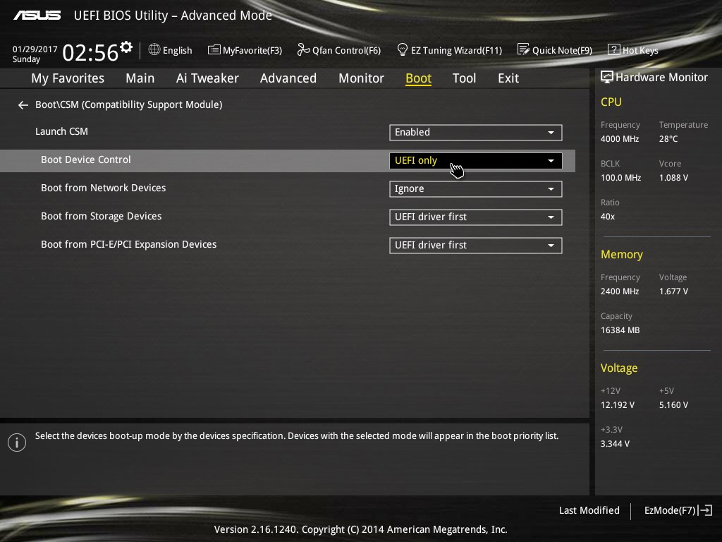

some mb settings:
Thanks for your help  :blush:
2017-01-28 23:32:26 +0800 Failure             	Sleep Failure [code:EHC1(EHC1)]:
this issues is ok.  The problem is caused by tp-link(TL_WN823N).
