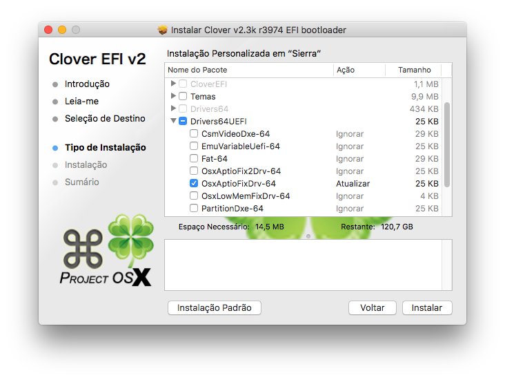

Ferio Posted January 26, 2017 Author Share Posted January 26, 2017 I managed with the help of Maldon to get Sierra installed and have everything ready. The only thing I have is the following error: "Reboot and select proper boot device or insert boot media in selected boot device and press a key." If anyone has any idea, please tell me how to fix this. After I will post a guide how I got everything working properly. :-) Edit: In the bios when my USBboot in inserted in the USB slot I see UEFI USBboot, but on my Samsung SSD drive there's no UEFI in front it. I'm guessing I missed something and it doesn't see the drive as a correct boot? diskutil list /dev/disk0 (internal, physical): #: TYPE NAME SIZE IDENTIFIER 0: GUID_partition_scheme *250.1 GB disk0 1: EFI EFI 209.7 MB disk0s1 2: Apple_HFS Sierra 249.2 GB disk0s2 3: Apple_Boot Recovery HD 650.0 MB disk0s3 /dev/disk1 (internal, physical): #: TYPE NAME SIZE IDENTIFIER 0: GUID_partition_scheme *15.5 GB disk1 1: EFI EFI 209.7 MB disk1s1 2: Apple_HFS USBboot 15.2 GB disk1s2 Disk 0 is the SSD where I installed Sierra on. Disk 1 is the USB where I boot and installed Sierra with. Quote Link to comment https://www.insanelymac.com/forum/topic/320429-best-stable-osx-for-asrock-z77-extreme-4-i52500k/#findComment-2357456 Share on other sites More sharing options...
MaLd0n Posted January 26, 2017 Share Posted January 26, 2017 boot into system, remove usb stick, install clover in efi Quote Link to comment https://www.insanelymac.com/forum/topic/320429-best-stable-osx-for-asrock-z77-extreme-4-i52500k/#findComment-2357487 Share on other sites More sharing options...
