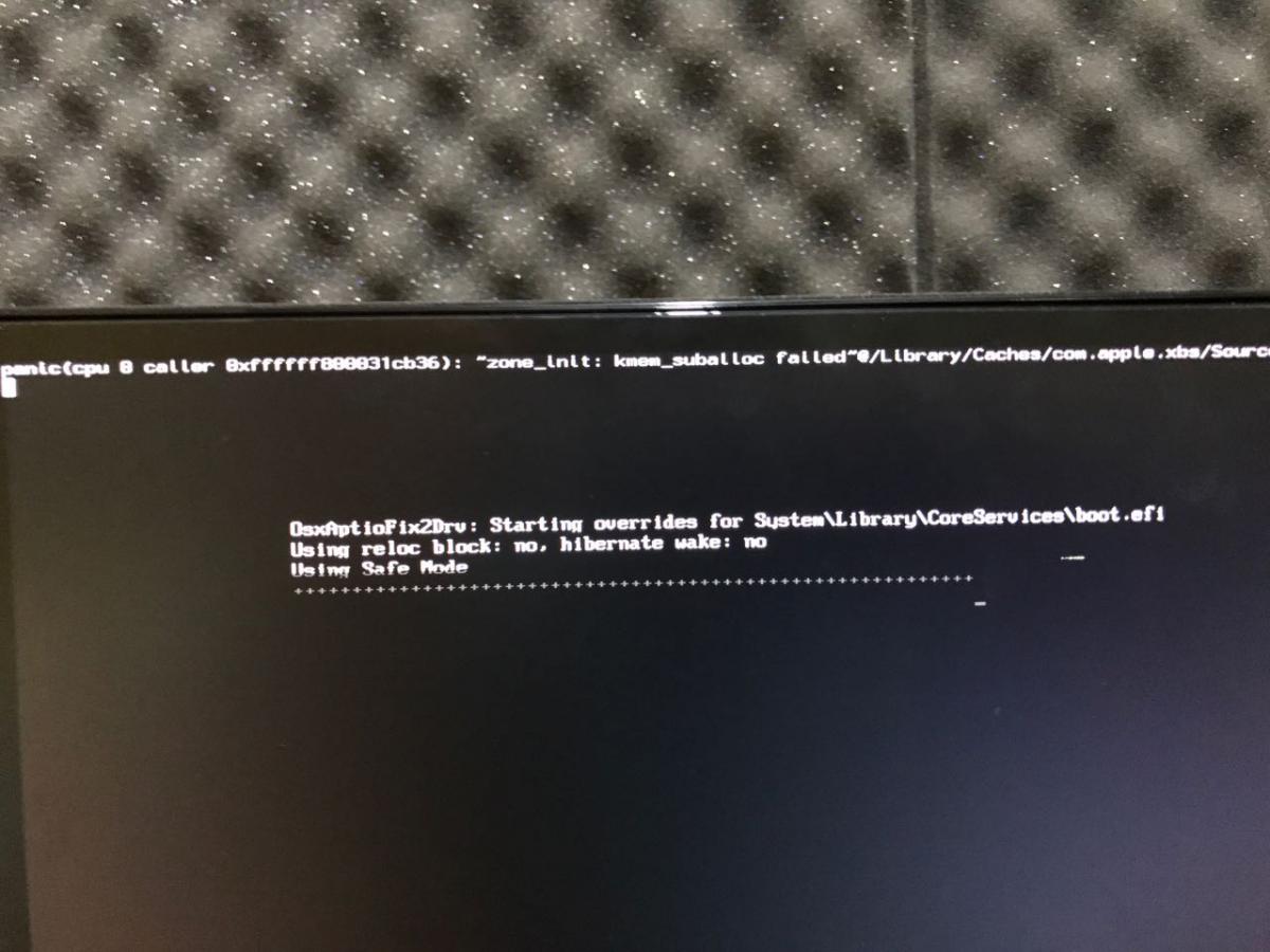

LordDrk Posted January 21, 2017 Share Posted January 21, 2017 (edited) Hi guys im trying to install El Capitan in a second pc here I have a GA-H81M-H with i7 4770 + GTX 960 My BIOS settings are ok Disabled VT-d / Virtualization Changed to Other OS Disabled Serial Port Set to XMP profile Removed all peripherals from USB 3.0. I tried a lot of boot flags nv_disable=1 nvda_drv=1 -x -v All i get is this and restart right after, image attached. I googled but cannot find anything. FIXED BY CHANGING RAM SLOT Edited January 21, 2017 by LordDrk Link to comment https://www.insanelymac.com/forum/topic/320375-issue-el-capitan/ Share on other sites More sharing options...
